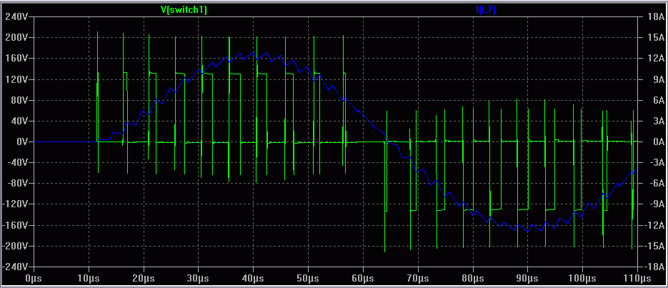

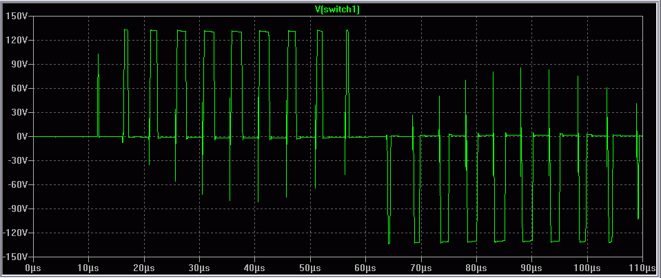

here is a plot from simulation of the posted patent application. Shown is voltage across bidirectional mosfet synchronous rectifier and output filter current.
Eva, you might take a guess which spikes are due to the synchronous rectifier commutation and which spikes are due to the primary commutating at 8ns (unrealistically high speed). Secondary switches modelled are Si4490DY mosfets and transformer data (6:1:1 winding ratio, 720uH primary inductance and 900nH primary leakage) reflects actual Payton EELP32 planar transformer that I use.

The plot shows plenty of 200V spikes exceeding the voltage rating of the switches and causing avalanche. All the spikes are due to leakage inductance. If you model an ideal transformer they all will disappear.
The plot also tells me that you are not using phase shifted modulation but just shorting the primary during the dead time as in a plain SMPS. That would correspond to "class BD" and the plot shows the negative consequences in form of current slewrate limiting and very narrow pulses at the end of the cycles. Indeed. that kind of operation produces the narrowest pulses for the smallest signal levels (being pulse skipping unavoidable), as opposed to the typical class D operation that produces the shortest pulses just near clipping. In practice, that means that BD operation yields the highest distortion, quantization artifacts and noise for the lowest signals (audio details!), while class D operation yields the opposite. Also, pulse skipping causes further quantization and jitter errors, the same errors that can be seen when a class D system enters and leaves clipping.
