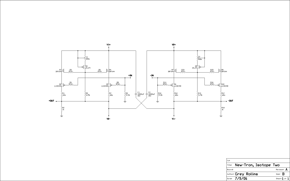

There has been talk about using a current source and a resistor to set the bias for the output stage. I'm including a schematic of the New-Tron, Isotope Two, which shows exactly such an animal. It doesn't really matter whether you use a fixed CCS and and a variable resistor or vice versa. This one uses a variable CCS and fixed resistor. This is not a "build and forget" kind of circuit. You'll have to set the bias yourself. Like the Zen #9, set the bias to minimum and bring it up slowly. You'll want to bring both sides up together.
I don't remember how many biasing schemes I've got--this is just one of many. And I have non-Circlotron circuits as well. What I don't have is time, but that's an old story.
Incidentally, this is a Class A circuit, too.

Linear Systems will be releasing their version of the 2SJ74 "this year." The information I have is somewhat sketchy, but I believe the '109 will be released next year.
Incidentally, the '74 I used in the circuit above was a GR--which is all I can get. If you use a higher current device, you might need to consider increasing the value of either the current adjusting pot or the fixed resistor.
Other P-ch JEFTs--from Motorola/OnSemi, for instance--will do just as well. Just allow for some fiddle factor with the resistors. You'll want something on the order of 7V at the Gate of the cascode MOSFET, plus or minus a volt or two to allow for parts variations.
Other current source designs will also work. I used the 2SJ74 because it was handy and was fairly compact voltage-wise. If you start using some of these really, really complicated current sources from other threads with stacks of LEDs and multiple transistors, you'll find that the current source will need several volts across it in order to operate. The best solution in that case will be to use a separate rail for the CCS. That way the current source won't suffer when the output approaches the rail and the CCS runs out of voltage.
I typically use balanced complementary circuits for which the 2N5911, 2SK389 and LS843 dual N-JFETs tend to work out nicely. I agree that complicated current sources tend to eat up a lot of voltage for little benefit, compared to a cascoded JFET source or an InterFET JFET tetrode.
