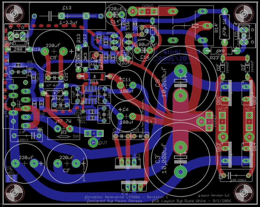

New PCB
I'm thinking to make a small bunch (ca 10 boards) of new boards according to my objectives:
  • 16 mm caps for C1, C2, C9
  • 12.4mm caps for C6, C11
  • SMD current pump, opamp, and compensation network like in the Evolution
  • most critical component thru-hole for maximum customization
  • most critical resistors 1/2W rated
  • C7 and C8 ground also on the bottom layer
  • MC7812/MC7912 PS, easier to upgrade with the various shunt regulators available
These boards are completely untested and are my first PCB design (in this case based on Russ'one).
So any suggestion, improvement and/or feedback is welcome and appreciated
"SMD current pump, opamp, and compensation network like in the Evolution"
Can you explain the advantage/improvement of this part of your design?
Regarding the current pump SMD permit much shorter feedback loops and much lower inductance, improving stability.
When Mauro presented the MY_EVO (Evolution) he clearly stated that the SMD compensation network made a big difference for stability.
Also the SO8 opamp permit shorter paths and, in my experience, SMD opamps sound better than DIP counterparts.
Dario,
Looks like you have learned a lot! Designing your own boards is pretty sophisticated.
This is a two-sided board, but you have eliminated the ground plane. I hope that works out okay.
I like the wider traces, but is there any drawback to making them so big? Chance of introducing noise? I've never worked with SMD components, but a lot of people seem to have no trouble with it. I guess it's an aquired skill.
Peace,
Tom E
Hi Tom,
this PCB is the last version of that 'joke' that I've posted last year... but now I'm pretty confident it will work.
Though I'm still working on it, optimizing.
No, I've left it drafted so underneath traces are more clear... see the attachment for the complete version.
I don't know, it's one of the feedback I'm waiting... ;)
I've choose not incredibly small components, they're pretty big for SMD standards... :D
Even soldering it's not too difficult, the secret is thin solder (0.5mm diameter), tacky flux and tweezers. ;)
Hi Dario - looking good. I've only briefly looked at the layout, so here are a couple of quick suggestions:
1. If they aren't already in 35mm diameter, make C3 and C8 35mm. There's more choice of good electrolytics in 35 mm.
2. If you leave the LM318 in DIP08, it will allow the LF01 module (using an SMD LM318M) as a pluggable option, in addition to DIP08 LM318N/P/J.

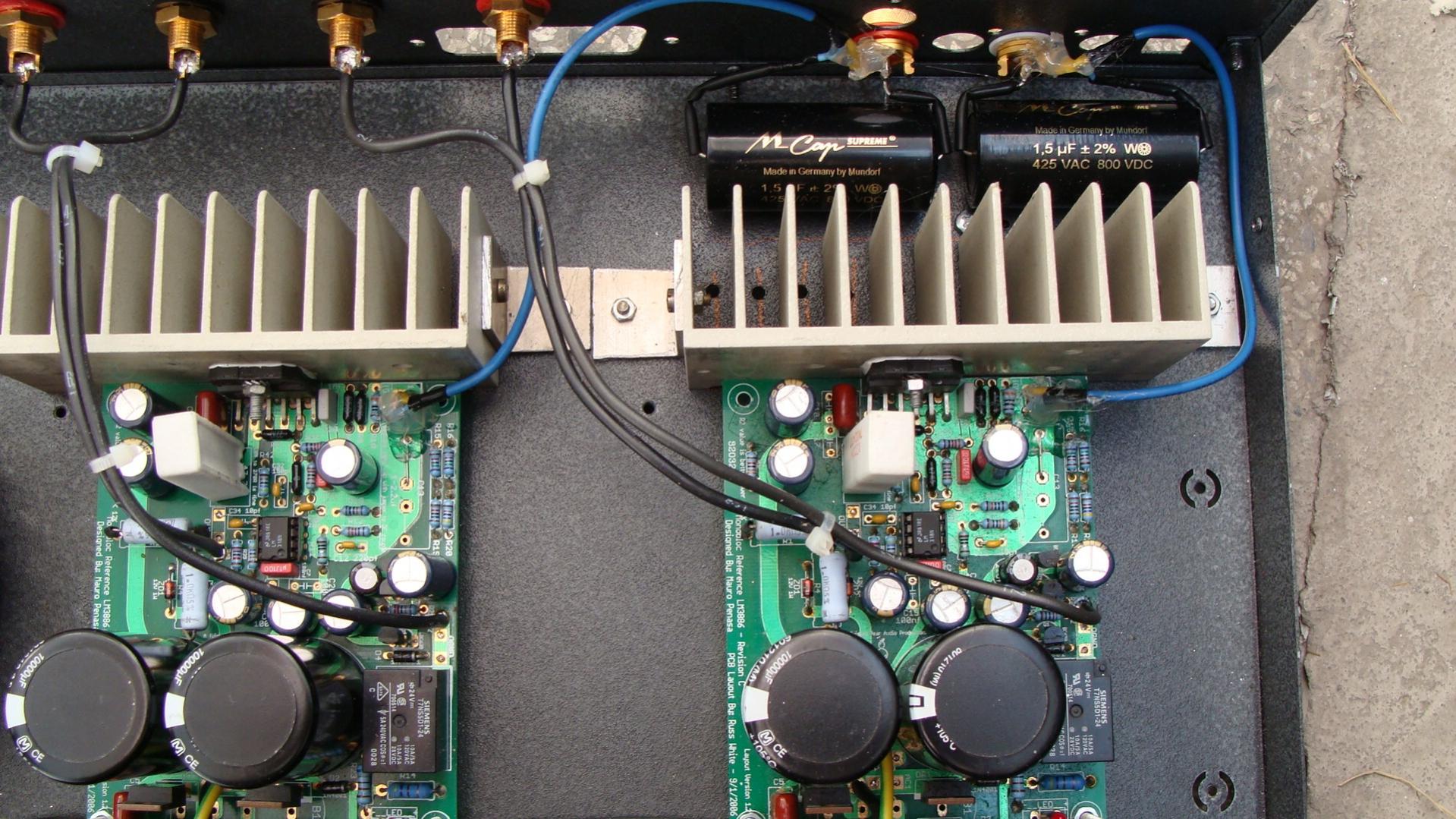

just got done installing k72 teflons in c4 & 7. i used 2.5inchs of ofc wires to put them on the sides of the pcbs. improvements are definitely there but the highs have become accentuated to where it's once again a bright sounding amp. and yet coming from mpk4 & fkp2, this is more transparent and lively. and the bass is deeper, quite a bit so. i'd say it's a huge success if it wasn't so bright sounding. i probably should've gone for PIOs... );
could anybody guess as to what my problem is?
ok. i was able to borrow a local diy-er's gainclone, and...
THE GAINCLONE SOUNDS MUCH BETTER!!
the bass and transparency of it just humiliates my myref which leaves me no doubt that there's something wrong with the unit. i've checked the parts layout at least a dozen times but here's a picture of how i received the amp.
