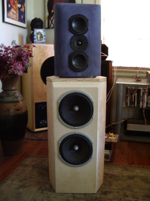

That was a nice write-up you did about the Sonicap. I might try the Mundorf Zn again now my new speakers are done. These tweeters and mids are so much better than what I was using before, and I need to revisit the decision I made.
I don't remember if I posted a pic yet.
Peace,
Tom E
Wow Tom!
It's an impressive work! 🙂
Sonicaps are incredibly musical but, for my taste, the loss of detail vs DC-coupling is too much, sadly. 🙁
I'm waiting KZs in C6/C11 to full burn in but so far they seem the cure (or part of) to obtain with Zns a timbre similar to Sonicaps.
