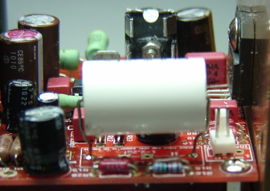

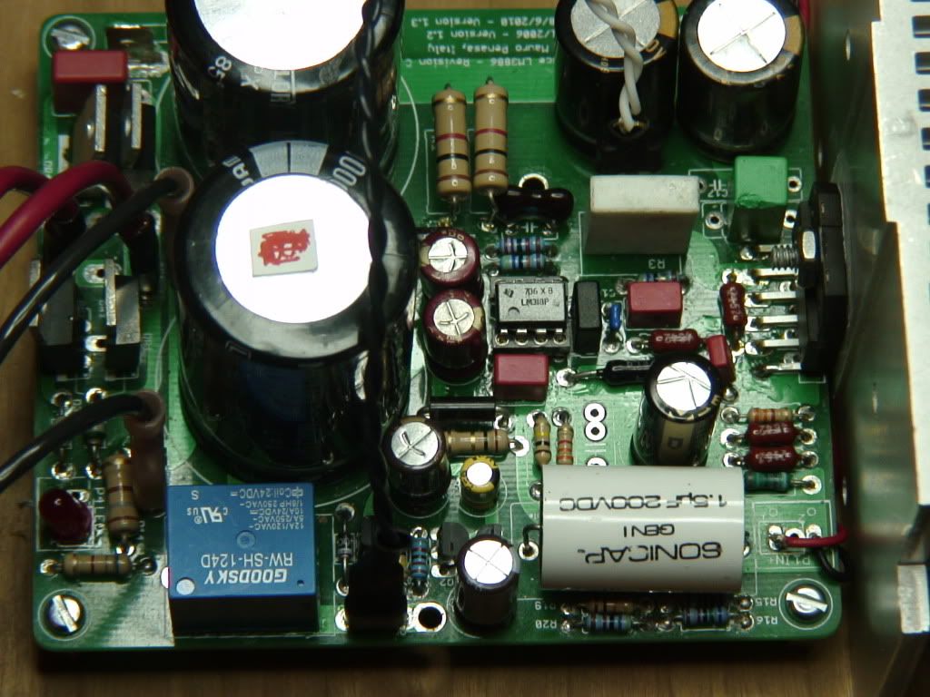

Bob and Tom, thanks for the heads-up on the Sonicaps. Bob, is the 1.5u/200V Gen-1 Sonicap small enough to fit on-board on the version 1.3 board, or does it have to be installed off-board?
Here is the Sonicap on the Twisted Pear V1.2 board. Needs some adjustments for off-board mounting.
Thanks, Bob - it looks like a very comfy fit on the V1.3 (and V1.4) PCBs, and a bit snug but manageable even on the V1.2.

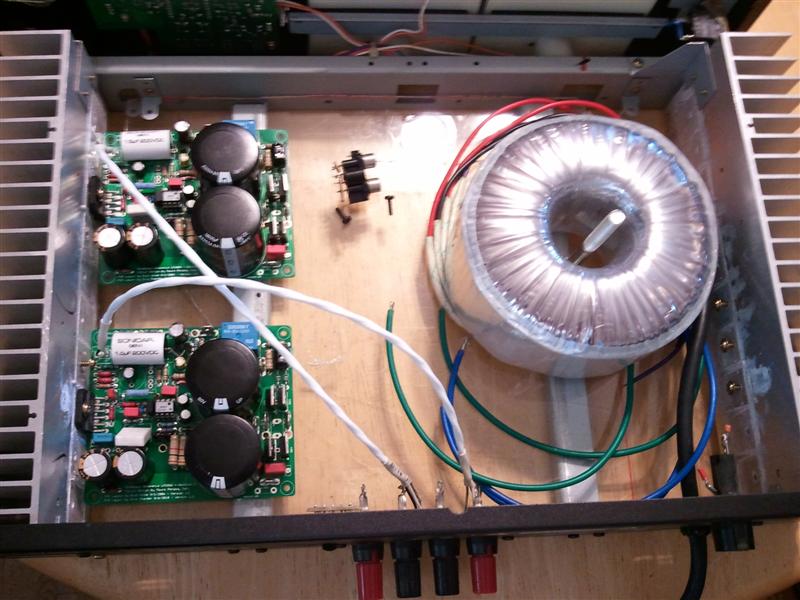

Cool - the boards look familiar. The heatsink on one side is unused, right?
That is correct. It is a reused chassis. I decided since the HS requirements were met on one side to keep all the power on the other.
If it were mine i'd remake the back panel and put the AC inlet and fuse in the middle the put the RCA's, BP's and amps on each side.
But since this is a donated / give-a-way chassis I will just make the suggestions to the owner.
EDIT: It's not noticeable in the picture but there is a sheet of Plexi-glass on the bottom of the chassis.
