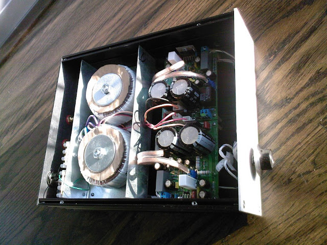

build
Peter,
Nice job on the build! I like your layout.
I have a question about the "pan" for your transformers. Is the pan made of steel? Does it have to be a ferrous metal to isolate the transformers or can aluminum be used?

Yes, FM's are better than FC's. I don't know why some people believe the opposite. We were very fortunate to get FM's in these kits at no extra cost.
