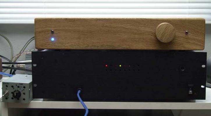

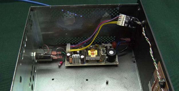

Cap switching box

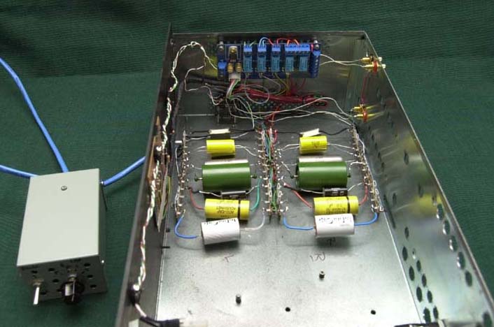

Here are a few pics of the 'input cap switcher' that I put together. It's really more an electrical than electronic project- nothing very complicated or elegant but it works.
I can sit in my chair and switch cap choices in 'real time'. For me, this gets around some of the problems of 'adaptation' which have been discussed in the psychoacoustics field. It also helps if you deliberately don't memorize which caps are in each position, to get around some of the visual and price cues which could affect the results. That said, I don't have many very expensive caps in the collection, as you can probably see in the pics.
My initial plan was to put the myref amps in the same case, but ran into some hum problems, so opted to run the cap switcher in front of the (direct-coupled) amps, which are in their own case.
I used an eBay input switching relay board to select between 4 caps, and another relay from the parts box acts as a 'bank switcher' to allow 8 different (pairs) of caps to be compared.
No conclusions yet, but it does add to the fun when listening.
It's available for (short-term) loan to any local diyaudio members. Just drop me a line.
I'll attach a few pics.
Cheers
John

AndrewT said:
will all that spaghetti and it's inductance change what passes through the caps?
Andrew-
Most of the 'spaghetti' you refer to, is power and relay switching wiring, I think.
Only one pair of caps is in circuit at a time.
The signal path is only increased by perhaps 30-40 cm. , compared to 'straight in' to the amp. Do you think that 30 cm of relatively straight conductor has an inductance whose effect you can hear? (a la gainclone concept..)
John
