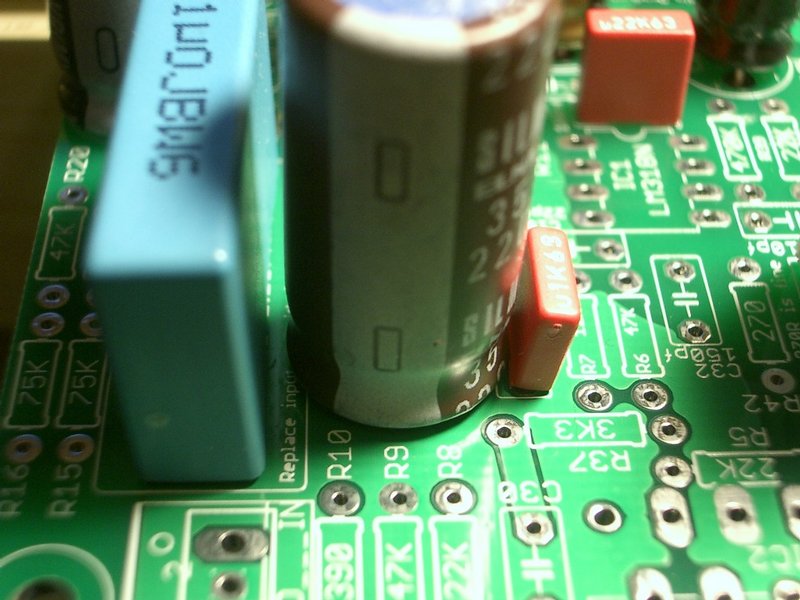

madisonears said:
Do the C9 Elna's fit onto the board without too much trouble? It's hard to tell their relative size from your photo. They look to be similar size to the FM's.
Have you decided on a C13? I put a 1.5uf Bennic metalized poly cap in there, and it sounds a bit dull with loose bass. I have some other caps on order now.
Hi Tom,
I've attached a photo of a Silmic in C9 place. It's a tight fit, particularly with C13, if necessary C21 could be mounted in the bottom side.
For C13 I'll start soon too the search for a good one, but for now modules are DC coupled.
