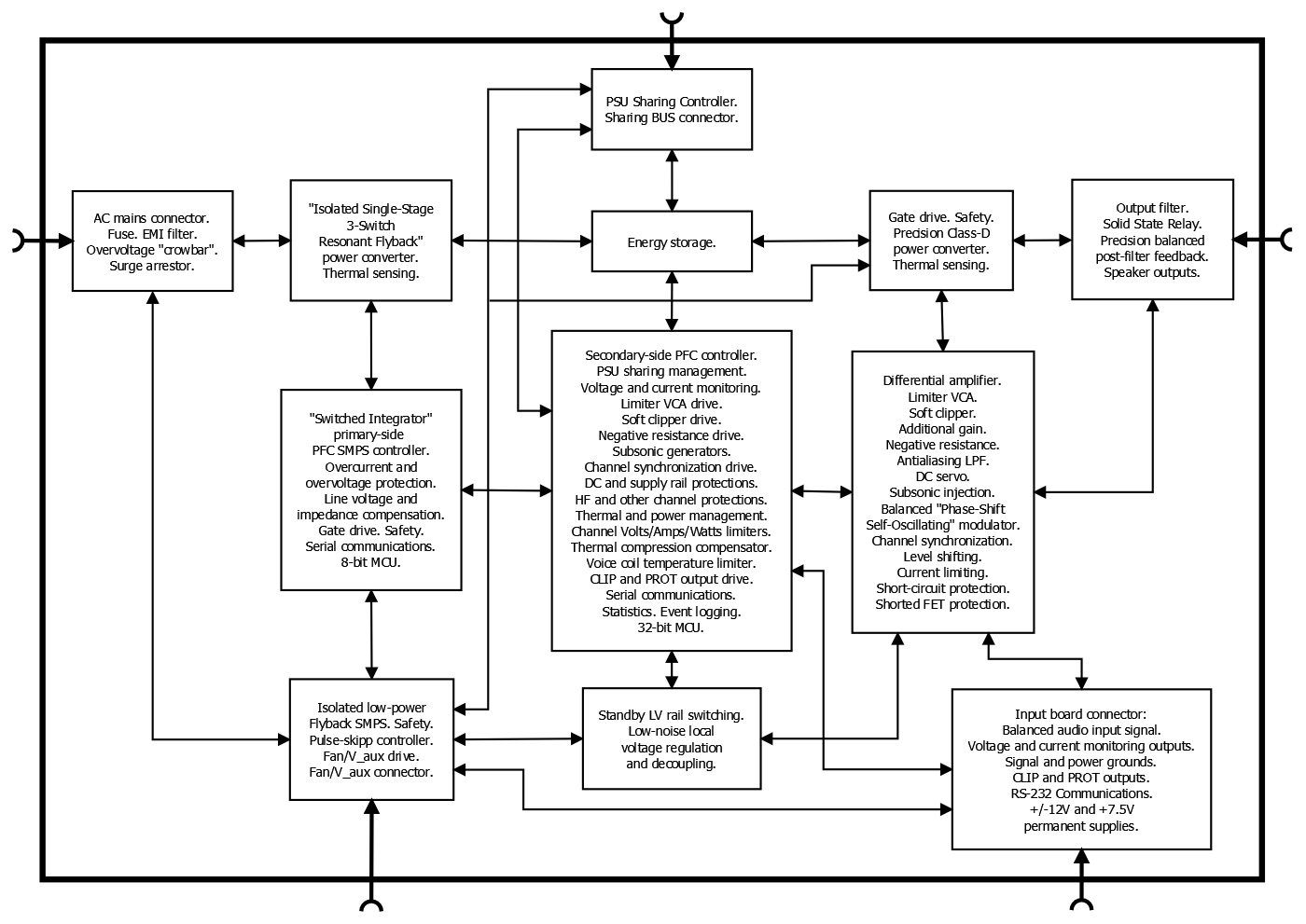

During the past 10 years I have been developing amplifier module technology, also post-filter self-oscillating, but aimed at intensive professional use, including:
- Accurate limiting, also channel power and PSU limiting.
- Thermal management.
- Voice coil protection based in dynamic resistance measurement.
- Accurate compensation of thermal compression.
The idea of these features comes from the experience cranking up (and fixing) systems for events and parties for years.
I have just offered Hypex to start a partnership.

Block diagram / nice amplifier quiz attached. Preliminary (drawn from memory, actually).

This looks like your commercial plate amplifier.
