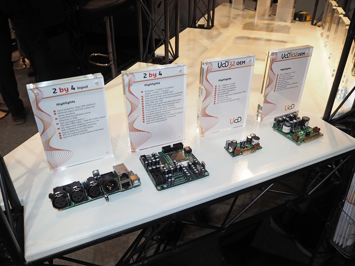

The fusion plates are oem and diy and have ADAU1451/2 dsp chips.
The new 2 by 4 board has a sharc chip and is oem only.

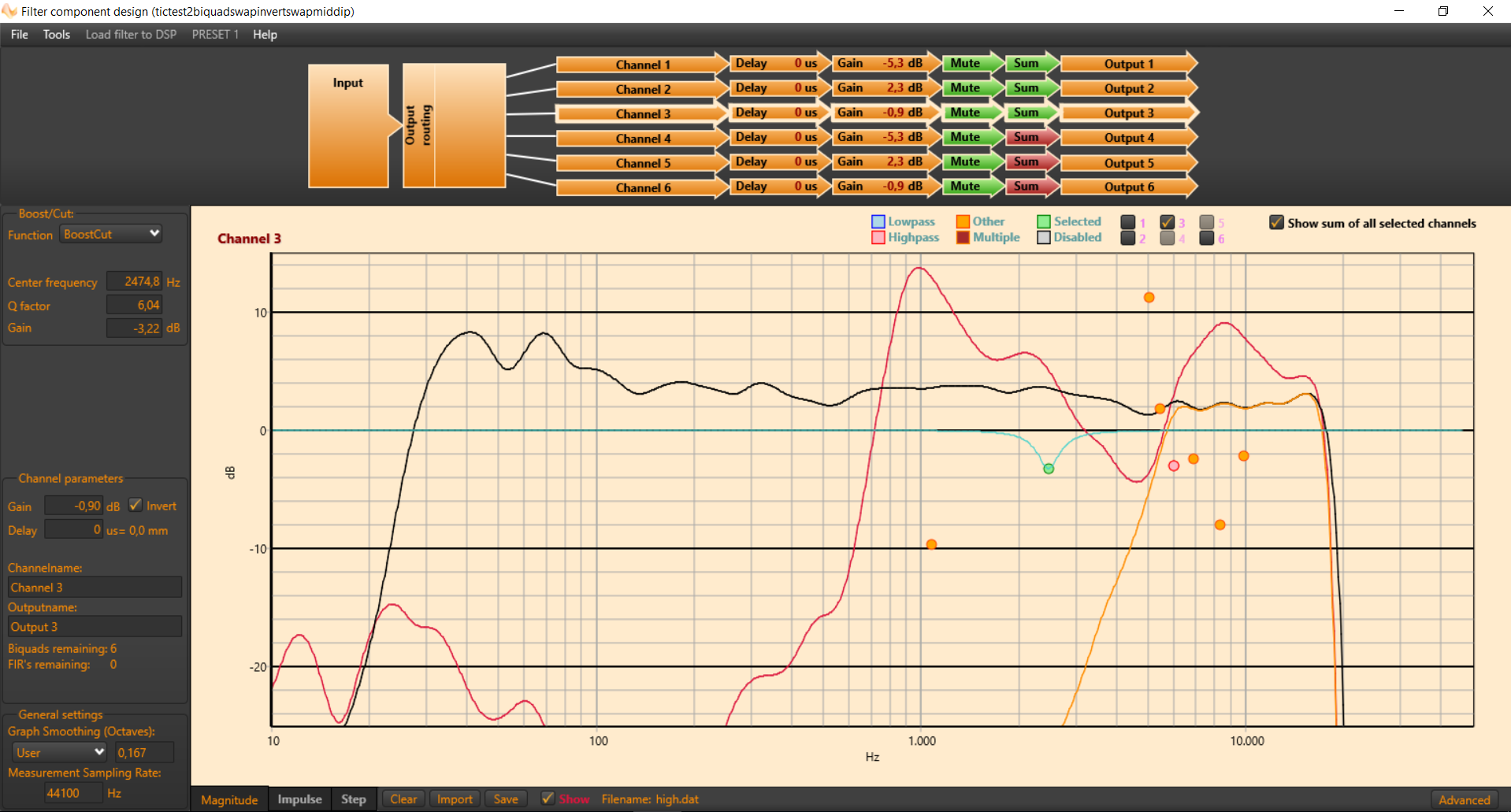

The Fusion series are controlled with the new Hypex Filter Designer and is not limited in filter choice.
The 2 by 4 has his own software package.

I think they developed their own very nice GUI. Far better than the old system. There's Ethernet ports on them, so just connect to the network, and log in via browser.

Only the 2 by 4 has ethernet ports!!!!! And is OEM only!!!!!

To prevent confusion: could you, please, specify the "2 by 4"?
Groets
Gerald
It's the OEM DSP board in this picture:

The software or the result?
Well I haven't heard the result yet. 🙂 I was referring to the GUI compared to the old one.
You can download it here:
https://www.diyclassd.com/product/hypex-filter-design/17
Works without a Hypex product connected, so you can play around.....
