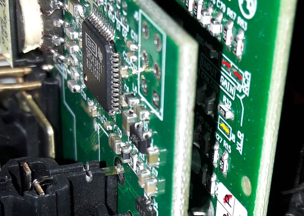

The default analogue input sensitivity of the FA is 6.15V for the XLR, most DAC-preamp can do only 4V output on the XLR, so with 0dBFS on the Fusions, you can't drive to maximum output. To be able to drive to max level, you can increase the Fusionamp digital gain over 0dB (at the expense of more noise) or set the analogue input sensitivity (needs SMD soldering, check page 17 in the FA manual).

If you have a typical DAC-preamp with 4V output on the XLR, you can't drive a Fusionamp to max level at default, because the default input sensitivity for maximum power requires 6.15V using the analogue XLR input of the FA. Also this means that the FA output is quieter than normal at your typical volume control position on your preamp.
You can figure this out by increasing the volume above 0 on the HFD main screen (but that's a digital volume control, and going above 0 increases the noise floor significantly, it's audible, I tried, you can try it out too) or by soldering the analogue input sensitivity jumper (page 17 in the Fusionamp manual).
Both ways, you get more SPL for the same volume control position on your DAC-preamp and you would be able to drive the FA to max level.

I soldered the analogue gain jumper with good result, using the analogue XLR input.

I check the soldering area ... its tiny ��.. any where here i can see pictures of someone that did it?

Any one has pictures of soldering the analogue input sensitivity jumper (page 17 in the Fusionamp manual)?
I can see what you point, will need to get off the card in front to get access
I can see 3 little dots for xlr : those 3 little dots need to get soldered together?
