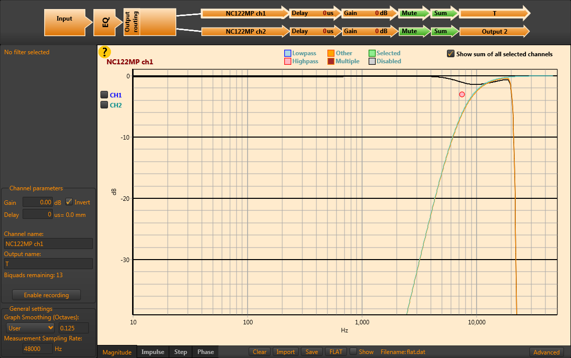

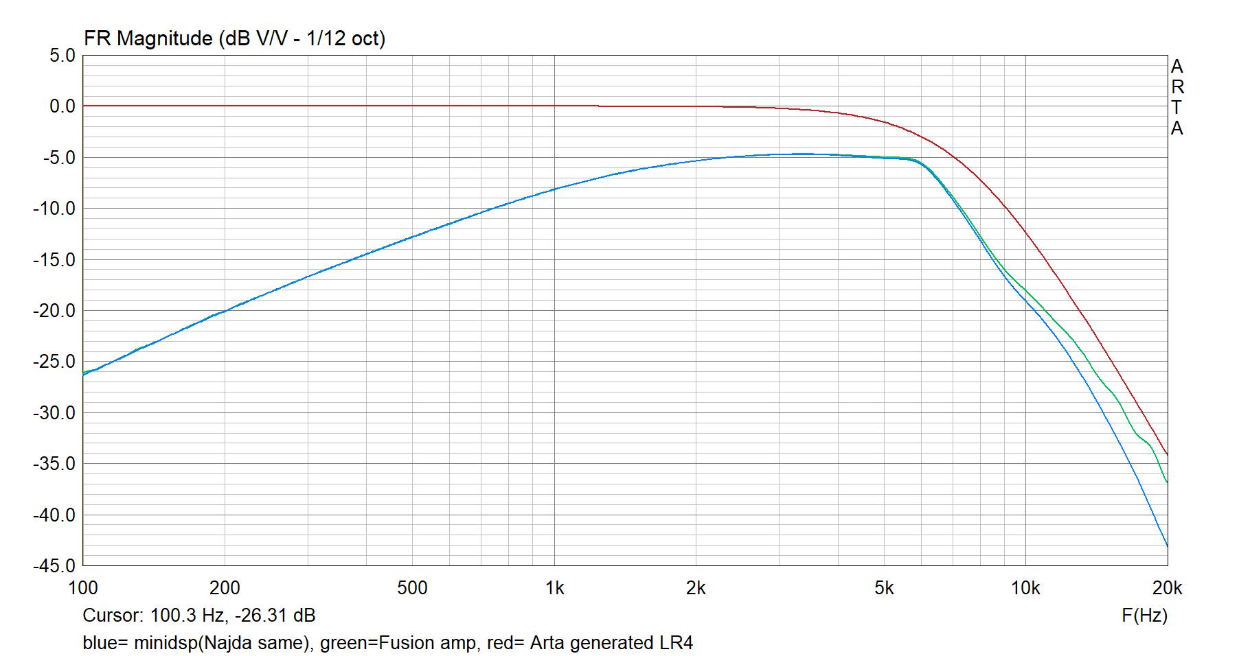

I am working on getting my LX521 right with the fusions. I am having problems with the steepness of a LR4 LP 7,5k. The fusion manual says 2 x LP2@q0.71.
It does not match when I compare with minidsp(or Najda). Can anybody help?

Oh my, stop the press.. It is a whole 1db of at -24db

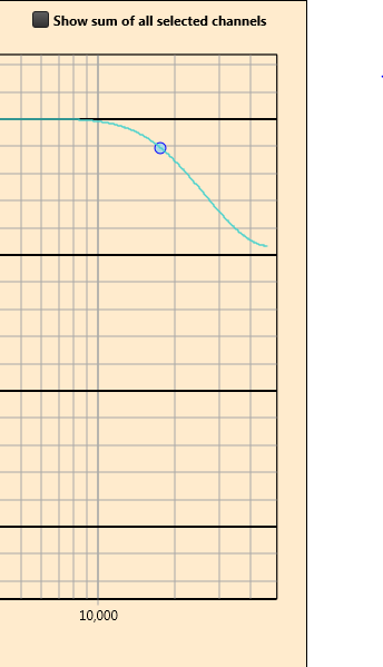

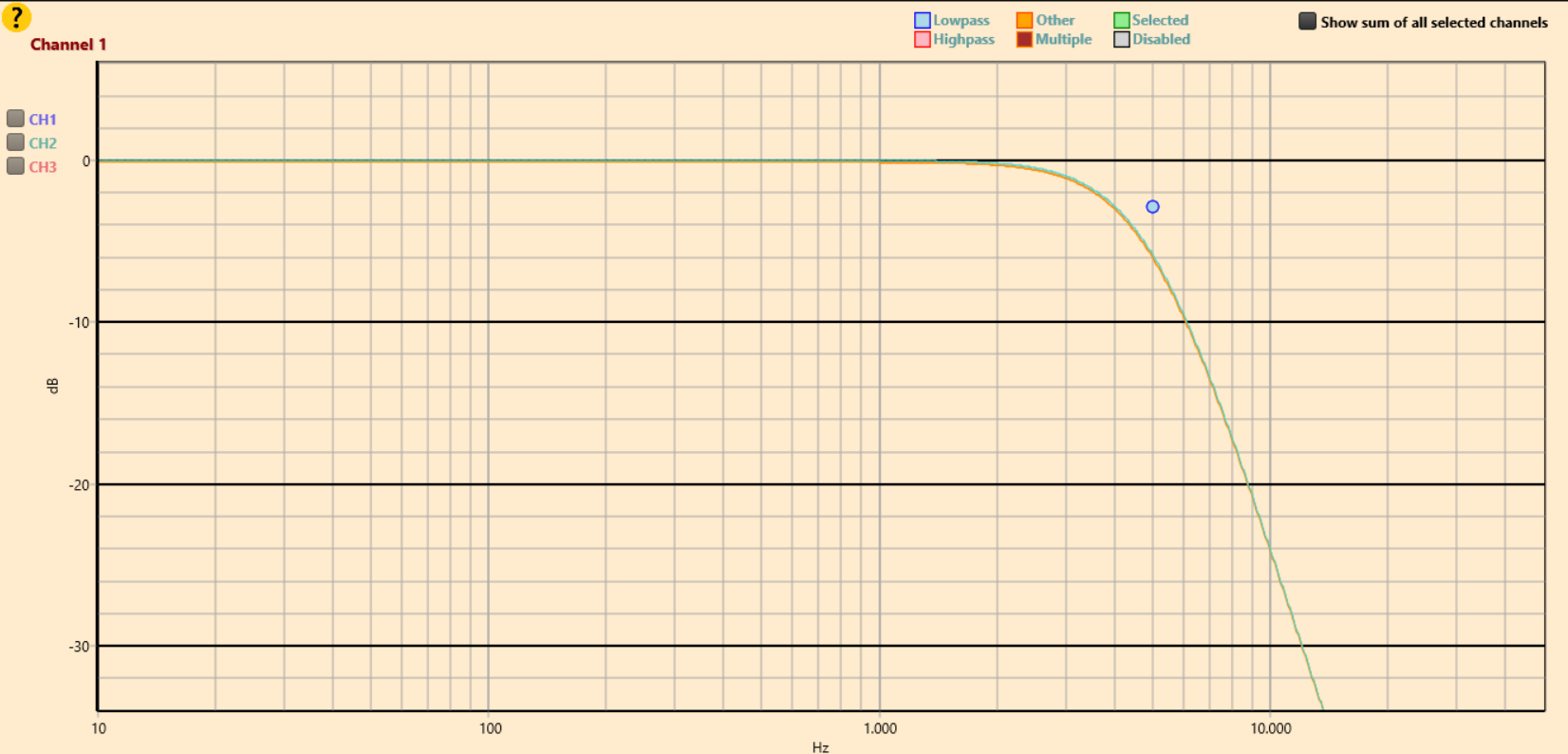

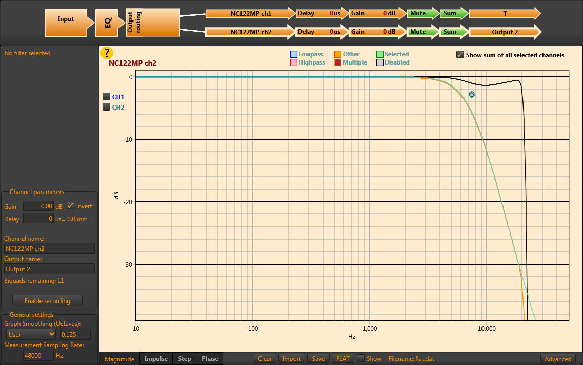

Although the error seems small, there is something strange going on at higher frequencies.
Up to approximately 5 kHz all filter slopes are fine, but at higher frequencies the slopes are not accurate anymore and HP and LP slopes get different.
The sum of two LR4 filters is not constant at XO frequencies above 5kHz. I could not find a way to properly compensate for this behaviour.
Also when you move the XO frequency higher with your mouse, you see the slope change. You can also move them outside the graphical design window.
At first I thought this was only an error in HFD, but the response of the filter in the FusionAmp is similar to that shown in HFD.
