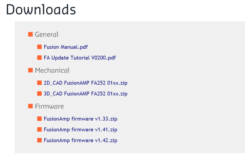

Cool. Is there a change log?
Fedde
You can find that in the FusionAmp firmware v1.42.zip file:
Firmware v1.42 release notes:
Firmware improvements (v1.42):
- DSP equalizer was single precision, changed to double precision
- NCAS500 and NCAS1000 added in the firmware, available in next release of HFD

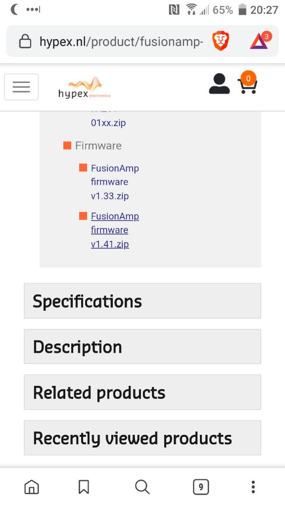

Seems to be rolled back to 1.41.
