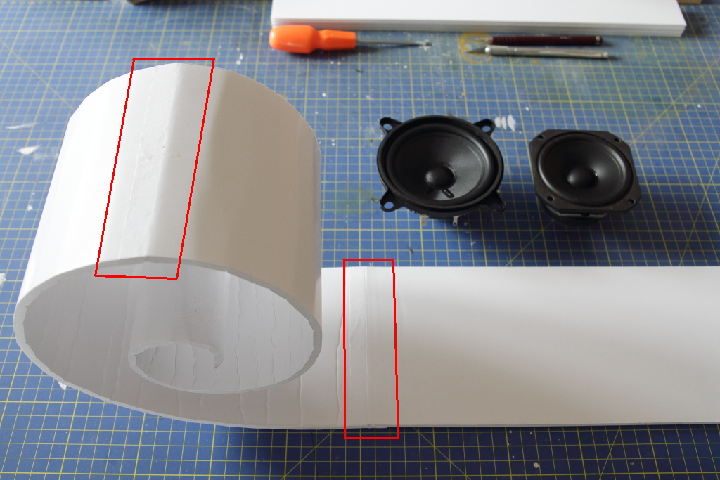

Got the FC and drivers, plus made a slow start on the build. Hoping my Mum can find her Hot-glue gun, rather than me having to go buy one...
Picture 1: Cut and joined a few pieces of FC for the spiral. Stripped one side of the paper and foam leaving a single 1/2" strip on each panel to be joined. PVA takes a while to fully dry but creates a strong bond...Pre-curved FC & Faital Pro 4FE32 and Vifa TC9FD.

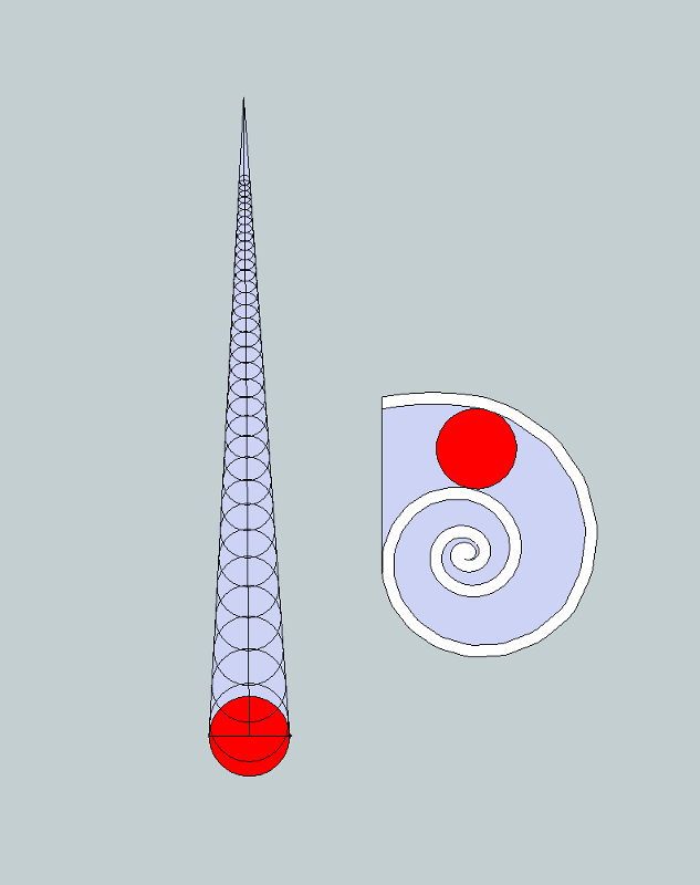

Picture 2: Dagger shape is 32" long and a ~4" base, giving 5.3L. It took about 3hrs to create the spiral shape using the circles from the dagger. However, its spot on with 15mm walls and can be used to make an MDF template... From the centre of the red circle to the straight edge [baffle front] is ~4.5", giving a 36" path length once the baffle is in place. Baffle height is ~9"... Overall depth & height ~10.75" x 12" ... X, your 9" x 12" is a pretty good sizing, the Fibonacci spiral and normal spiral come close [one under, one over] 🙂 ... Visually, I prefer the normal spiral shape.

Nice work! I like how you joined the FC a priori. Don't understand what you are doing with circles to spiral translation and why that took 3.5 hrs? You mean you cut out a bunch of circles to use as a template?
The sizing of the circles in the dagger shape are used to generate the shape of the spiral... Imagine all the other drawn circles within the spiral behind the red one, it just gives a known volume and a constant expansion of the spiral from point to end... Now it's laid out on the computer, I can just pull the dimensions needed to generate the template with no guess work 🙂 Just me being ultra over the top 😀
BMS,
Ok I think I understand what you are doing - generating a linear expansion spiral ? Maybe not available in sketch up but any cad program lets you generate a linear spiral by specifying angular rotation span and rate of radial expansion and it makes it in one command. Just in case you need to make more in the future. Did your Mum find the hot melt glue gun?
X, exactly right and it's something SketchUp can't do that I know of, hence the long winded way... I'm due at the parents house today so I'll find out soon if the glue gun has been found 🙂

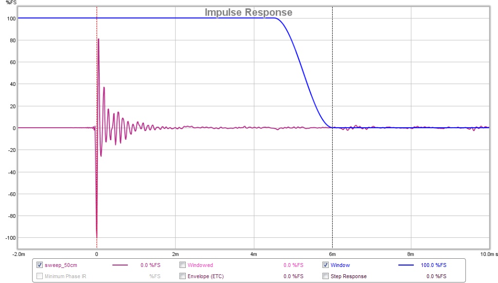

This morning tried & measured one Nautaloss with a Faital PRo 4FE32... a slightly different spec to the 4FE35. Don't think the '32 is quite as suited to this enclosure as the '35 should be... will swap drivers and try the '35 tomorrow. Should have the second enclosure ready tomorrow also 🙂
Faital Pro 4FE32: IR wasn't as good as I was expecting, but the polar response looks good up to 4K then starts to become more directional, very similar to the Vifa TC9FD in the 14cm x 21cm OB. However, the '32 would need baffle step compensation and has a large peak at 8K.

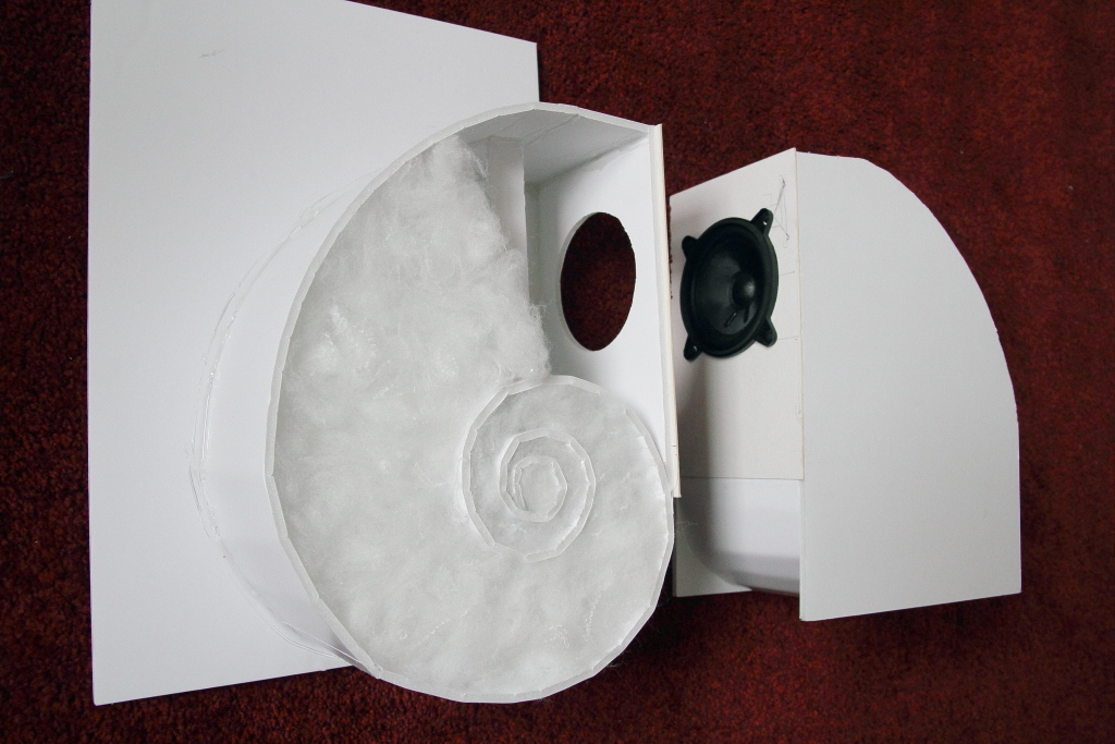

No photo's yet, will make sure to take some before sealing the second enclosure. I've added stuffing and it looks close to your pictures, just wondering if I need to make it denser.
Plus something noted from the mMarS speakers I did. What looked like an early internal reflection in the IR was reduced somewhat as the driver's mounting screws were tightened, making the driver more secure. To tight and the LF HD increased as the basket was stressed. Possible that some of what was measured on my Nautaloss was down to the driver not being mounted firmly enough.

IR is from the 4FE32 at 50cm ... good but doesn't settle down as quickly as I'd expect. See how things look once I measure the 4FE35 🙂
