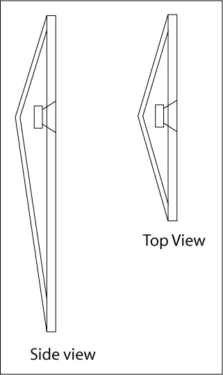

I drew a picture of what I'm picturing. Technically I could cast the concrete with huge radius's on the three edges to eliminate diffraction too. 🙂
If I am looking at the picture right, your intent is to have the sound get trapped by the skinny triangular shaped perimeter? You still have a flat surface directly behind the driver (albeit, angled) that can still reflect sound right back to the cone and cause dips. Also, the volume is quite large now and you may have an issue with controlling excursion at higher SPLs. Plus, that thing if made out of concrete will crush small children and pets if falls over (or it will break your back when moving it). 🙂

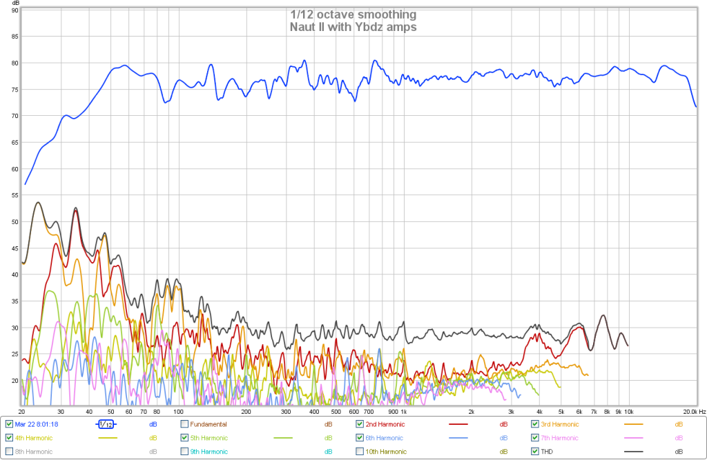

I just got some new TPA3116D2 amps for $13.75 ea (shipping included). These are the Ybdz 2.0's on Aliexpress.
They sound excellent!
Using them vertically integrated with the miniDSP XO gives better phase accuracy for the XO. My XO points for the tops and subs now match perfectly and do not require manual adjustment of the XO point for the tops and bottom to get a flat response over the XO region.
I was using a class A/B Yamaha for the bass and a homebuilt TPA3116D2 for the tops previously. Now using identical TPA3116D2's for both left and right channels with the same amp being used for the bass and tops on each channel gives very nice sound quality and makes the soundstage even better.
Here is the new setup:
In room response:

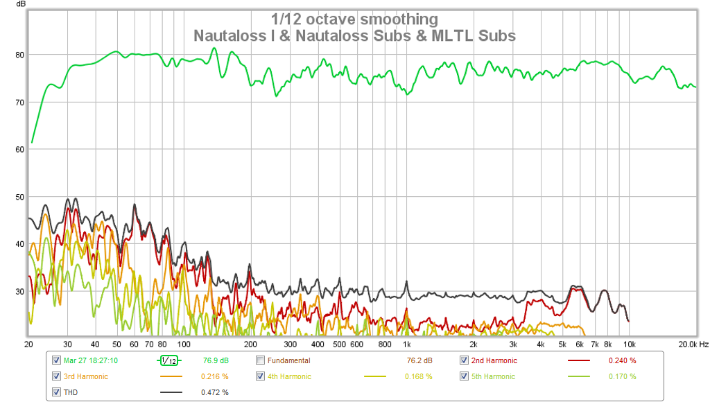

Playing around with the various Nautaloss's and subs that I have, I tried the Nautaloss I which has reduced sensitivity, but improved imaging and coherence of a point source, and augmented the Nautaloss sub with the big XPS foam MLTL using the same drivers that are in the Nautaloss sub. The bass extension is really improved and reaches the high 20's now. HD is sub 1% above 100 Hz and varies from 1% to 4% from 100 Hz to 30 Hz. Not too bad for qnty 4 of the $5 PE buyout woofers and a couple of $12 Vifa's.
Here is the latest in room response - you really can feel a difference with the added bass from 27 Hz to 50 Hz - some tracks are very engaging now because of the low freq content down there. Oh, and this is with the dual TPA3116D2 Ybdz amps in vertical bi-amp mode as shown above with the pair of series-wired MLTL's on the left and the dual driver Nautaloss sub on the right. XO is 200 Hz for HP and LP with 24dB/oct LR.
This has been a lot of fun playing with the various setups that the miniDSP has made possible.
