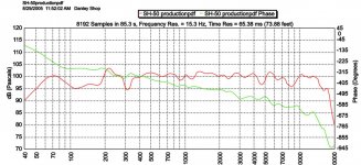

For the SH-50 (blue) I curve traced the amplitude and phase response using webplot digitizer from the datasheet and the interpolated the resulting curves onto a a uniformly spaced grid of 1001 points between 40Hz and 20kHz. I then created a text file of the results (attached to previous post) and imported it into REW. The small steps you can see will be errors in this process.
For my own speaker (green) its just a time gated on axis frequency response measurement taken in REW which I have applied 1/12th octave smoothing to (as group delay is the derivative of phase its very noisy otherwise).
Looking at the plots it appears REW has drawn the scale incorrectly its actually a range of +/-2mS.

It appears the SH-50's phase curve reflects that goal.
Look at the full 400 degrees of phase rotation between the center of the low drivers range and towards the center of the CD's range.
Two 2nd+ order xovers in that range...note phase scale.
Also note the additional phase tails on the high and low far ends.
There's a lot of total phase rotation imho.

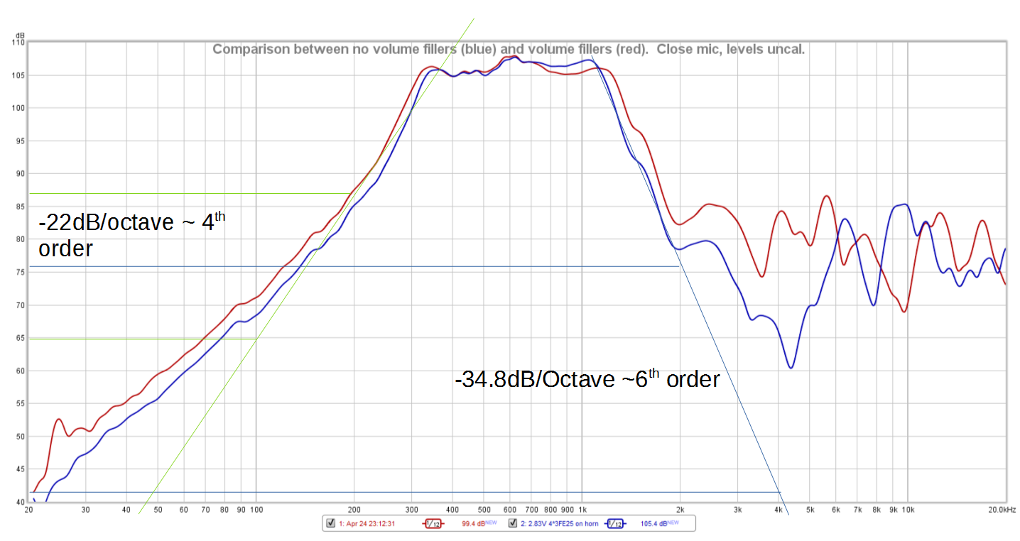

Here are some close mic'ed measurements of my unity mids (at horn mouth), as you can see the intrinsic high frequency roll off is quite steep and higher than 4th order bandpass due to the offset horn cancellation notch. I didn't need any electrical low pass on it, all acoustic.

Was that raw, or with some filters?
If fully raw and without any kind of high-pass, what did you end up doing for hp?
Did you add any para or shelving EQ's on the low-pass side, to bring response above 2k down any?
I'm ok with skipping a low-pass, when natural rolloff is sufficient.
But I do try to keep an acoustic rolloff target order to hold down to -30dB.
So i'd probably add some paras / or shelving to knock that down some,.....
that is, if i was in manual IIR tuning mode....but that's just my approach, being a fan of out-of-band EQs..

The mid responses are raw responses but the response is measured at the horn mouth so directivity effects are not accurate.

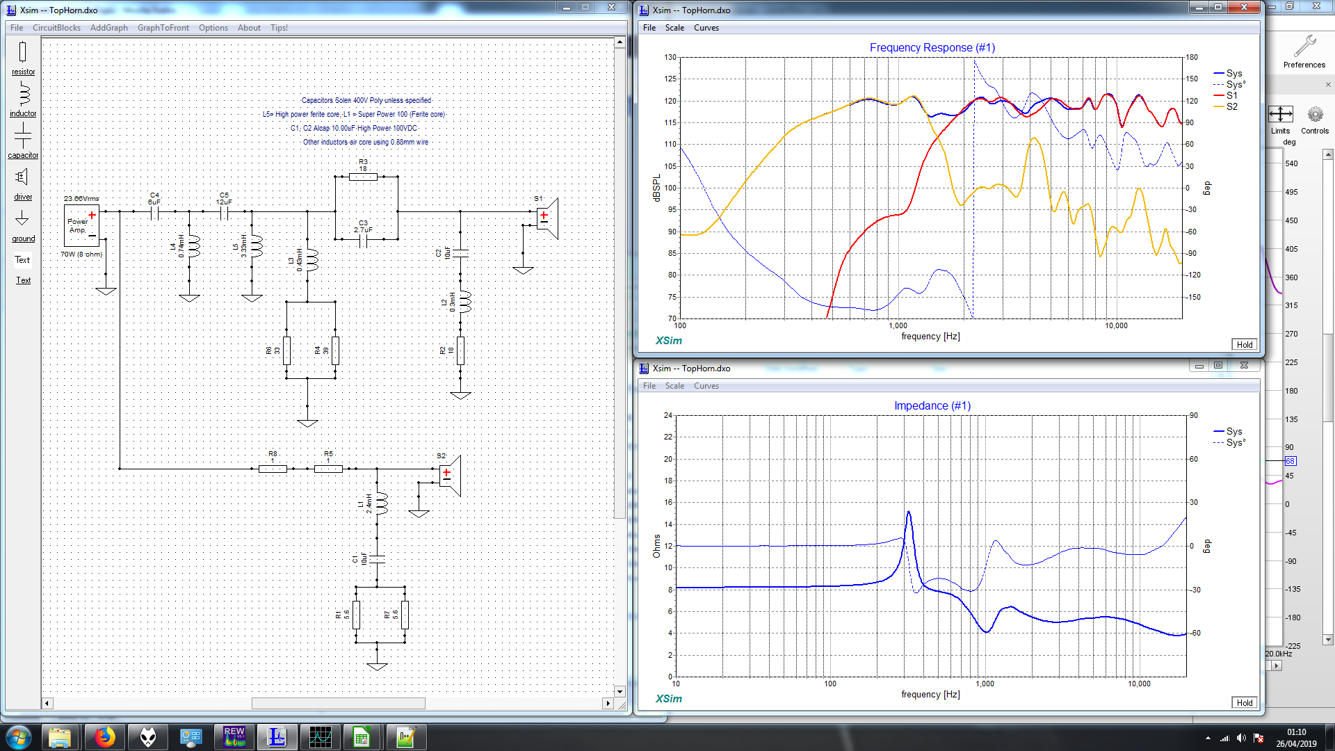

I think this is close to the final filters (S1 tweeter, S2 mid) :
I would probably skip the passive filter apart from sensitivity padding and a protection capacitor now I'm more confident with fully active systems though.
