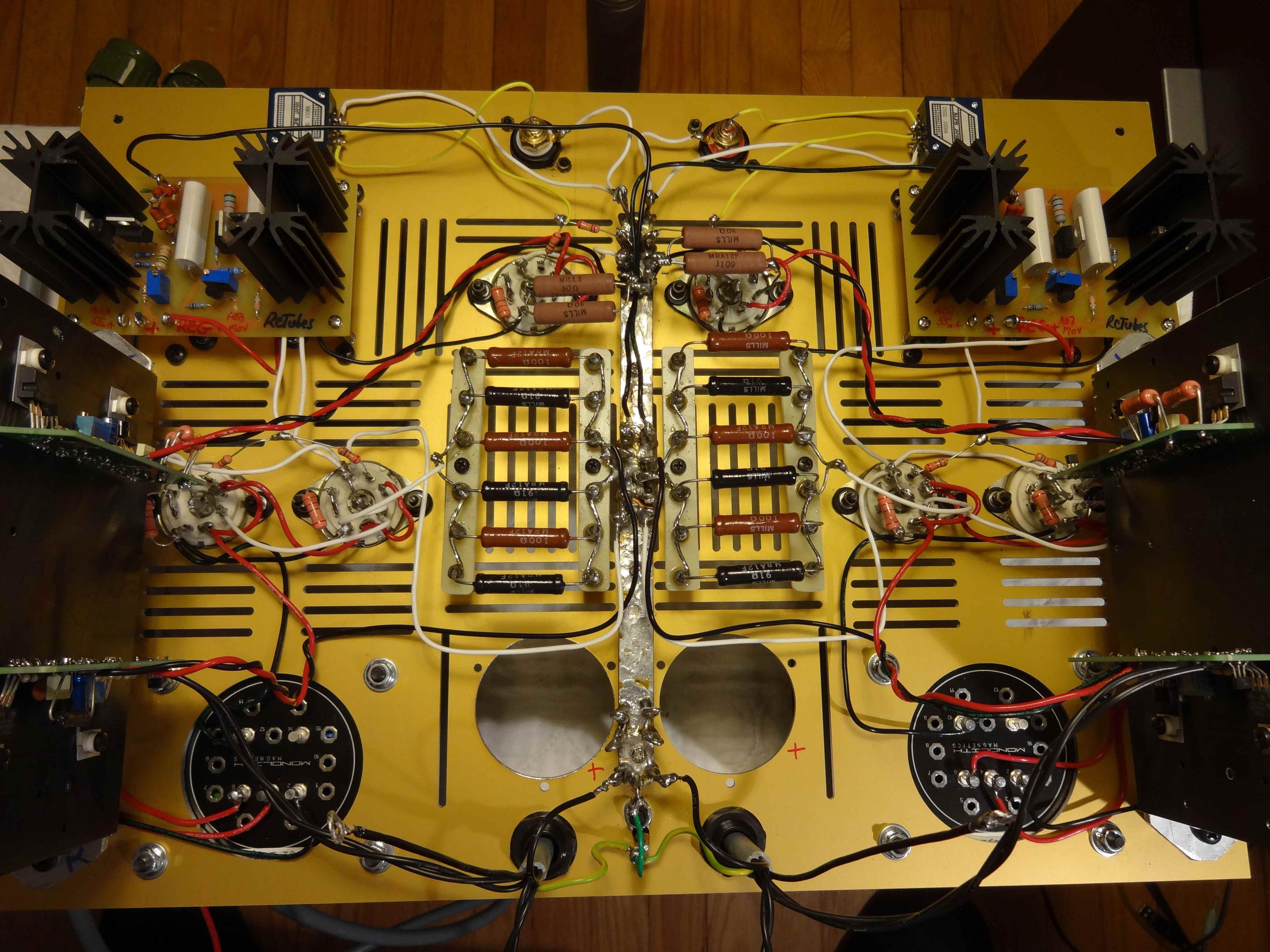

I prefer P2P for most of my projects and built mine in two separate chassis, the grounds are common only in the supply..
No hum or noise either.
Mine is all ground buss, with one connection to the chassis in each box. The RCA jacks both ground at this point and the supply connects to this ground point as well.
The power supply ground point is connected to the safety ground through a 10 ohm resistor with anti-parallel diodes connected across it.

In my power amp builds I am connecting the ground bus to the safety gnd directly and never had a problem. ( see picture, PSU is in a separate enclosure). What is the role of the 10R and diode anti-parallel? Is this typical for low level signal . ( I saw this setup in the Salas's simplistic RIAA).

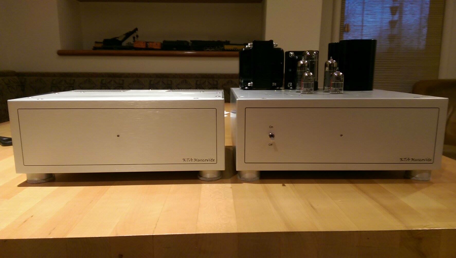

New Muscovite Build
I have been working on a Muscovite build after hearing Kevin's a lot for quite some time. Thanks to Kevin's guidance and Raymond Koomce of Time Bandit close by to me in Tyler, Texas, it is finally finished. I will set it up soon but I am so excited with the great esthetics of the unit that I wanted to post some pictures of the unit. The pictures do not do it justice, as the cases are very nice and hefty. I am very appreciative of the assistance of Raymond Koonce and Kevin to help get to done! Listening impressions later.
Wow, very nice build indeed. Thanks for the photos. Glad to hear someone building this design. It's beyond my abilities at the moment so I'm working on one of the "mini" versions. I look forward to hearing your impressions.
