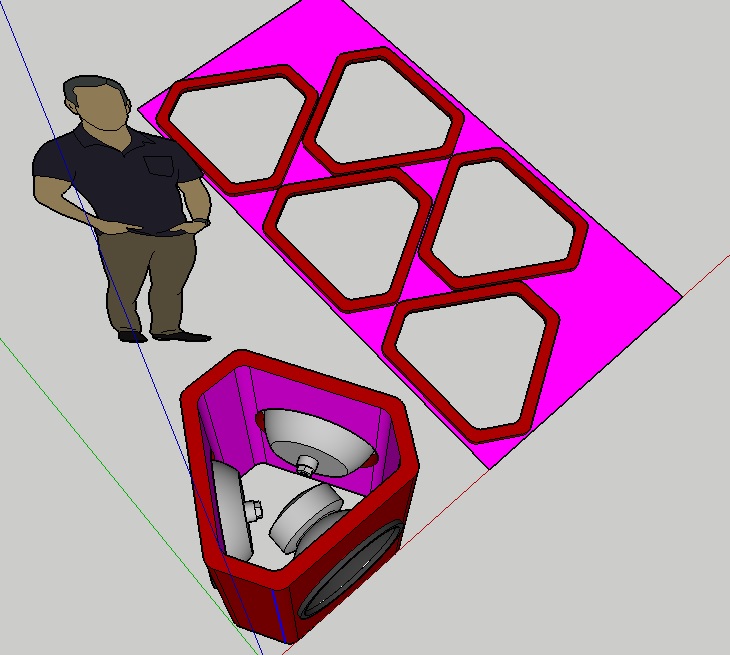

Last night I came full circle back to where I started...
Except instead of ply to make the centre section, I might build it using layers of 25mm thick ply.
If I make all four sides no bigger than 600mm x 600mm I could get 8 slices per sheet. So 5 sheets would be enough to build the cabinet.
Building the internal bracing into the same piece as the side walls would allow me to cut more elaborate patterns per layer, that I couldn't do with flat ply.
On the layers where there is no bracing I could use the big cut out pieces for other smaller speakers, like Russian dolls.

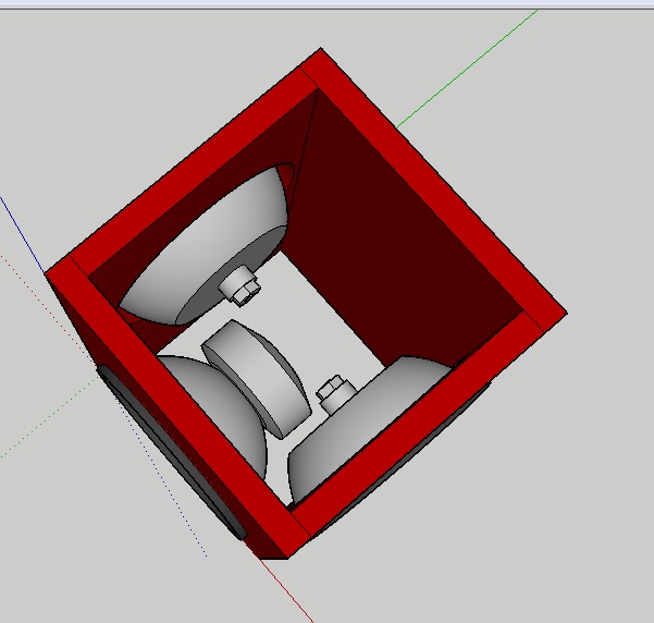

I'm going to add that I really liked your 'number 4' graphic earlier. I'll explain why. -Triangles are natures strongest shape, unless you are talking circles and radial pressure.
-If this was made into a triangle, your glue joints would be larger in the corners.
-Your feet underneath would be in 3 spots and placed well out of the central weight of the drivers and mass. This creates tremendous stability.
-Bracing would be less of an issue with fewer panels to flex or vibrate.
-Even if just barely a hexagon by making the corners flat and such, I feel this would be a great approach.
-If nothing else, you've given me fire fodder that I might build one such as this.

Squares can also be very effective in bracing. The only problem with a triangle shaped sub is the size of the pieces when cutting from a sheet, then a square comes into its own.
Biggest issue I see with a triangle is moving it. You are probably talking few hundred kgs minimum. Really hard to get the centre of gravity over on a triangle, and you risk damaging a PR or driver on ever side.

So long as the bracing is open and the box has a reasonable aspect ratio, the air within the box will act as a simple spring. One you get towards high-aspect-ratio cabinets, transmission line effects start to come into play.
Your cabinet will be fine.
I'd go for PRs arranged opposite to each other, so there's force cancellation and the cabinet itself doesn't walk around. You're looking at over a kilo of mass vibrating around.
So, the conclusion is that your cabinet is fine. Just make sure the PRs are mounted on opposite panels when you build the thing. You could have main driver and one PR firing forwards, and one PR firing backwards, or PRs firing out of each side with the driver firing forwards, or...
You get the idea.
Chris

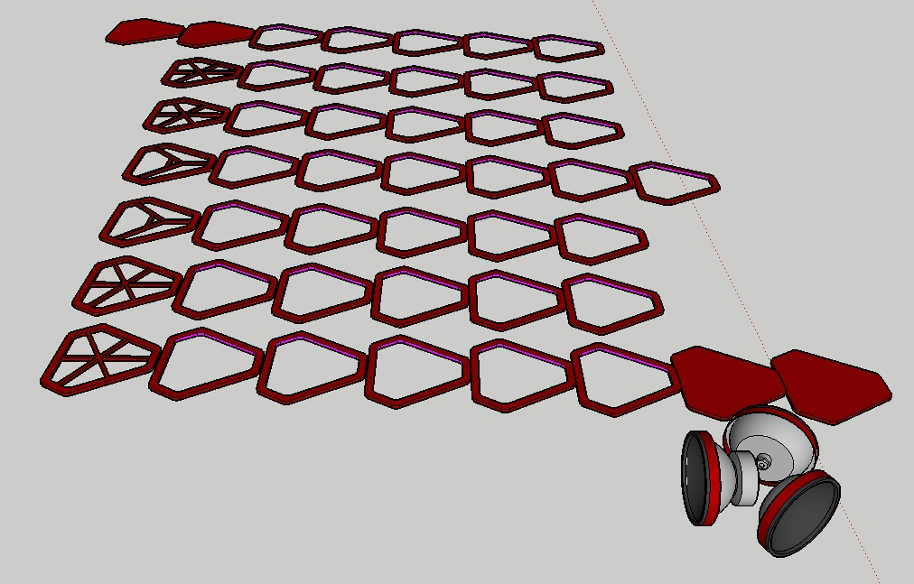

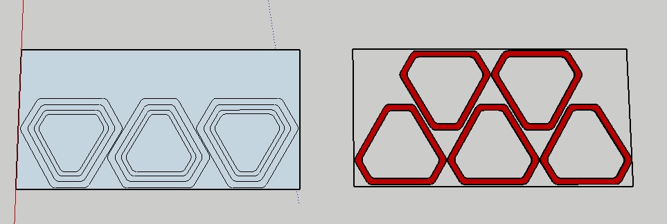

I have been revisiting the idea... Can only get 5 pieces per sheet which would mean a minimum of 8 sheets if I make no mistakes possibly 9.
At around $100 per sheet for 25mm think ply it is doable, but not cheap.
I should be able to just do this on my CNC machine.

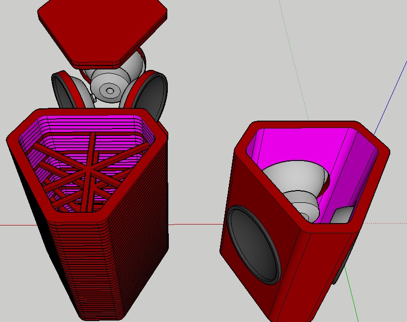

Not sure why you are cutting 5 tops and bottoms out of a board when you only need two, unless you are translaminating the thing. Seems that you could cut 3 pieces with the proper angles, mate to 3 smaller pieces with the right angles, and then add your bracing. You would be out less material, not require translam style, and still be able to brace well with CNC'd bracing as you have pictured.
FWIW- Paradigm had a box shaped like this, and it was a doozy of a sub according to spec and reviews.
And yes- I know rectilinear prisms can also be well braced.
That is the plan, I count 46 pieces and if I get 5 per sheet, that's 10 sheets. The idea is to make the walls 50mm thick which means two 25mm top boards and two 25mm bottom boards. 1150mm high in total. Flat to flat side just under 700mm, so is a good size without being over the top. What I like about this design is the PRs and the driver are on the same plane, and top and bottom can be easily padded without getting in the way of the drivers.

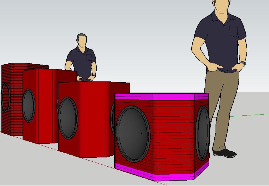

After some measurements and considerable thought I believe I have a final design. To avoid compilation and too much board juggling I have decided that if I get three pieces per sheet I am doing alright. I did multiple versions getting progressively wider / lower, and with only about 80mm difference in width, I can reduce the height by roughly 40%. At 770mm between the flats I don't want to go any wider. Funny enough going bigger and getting less pieces per sheet I still wind up using less sheets.

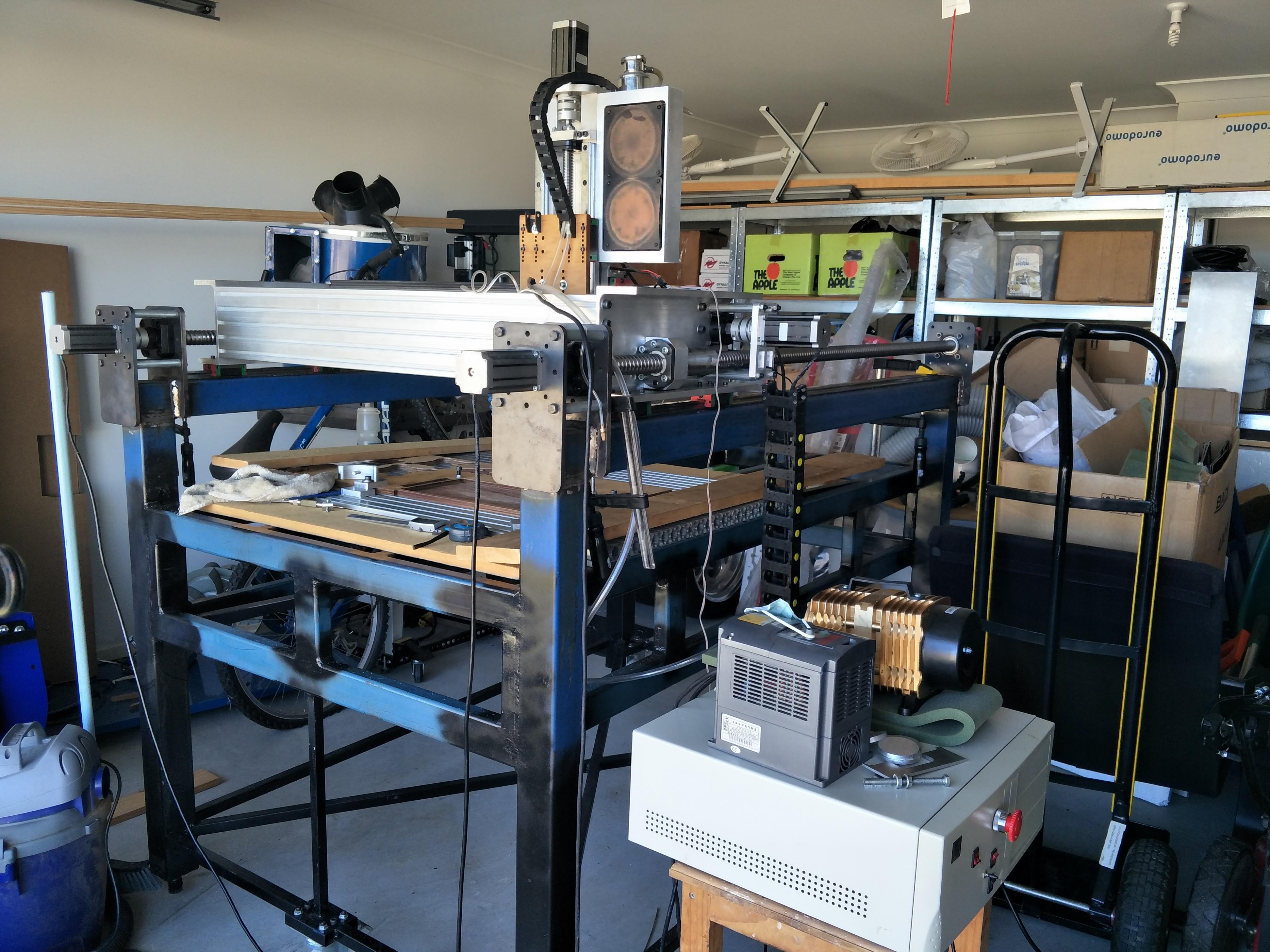

By offset I was referring to cutting pieces out of the 1200mm x 2400mm sheet.
I built the CNC to be able to take a full 1200mm wide sheet in from the side (meaning I don't need to pre chop the full size board).
I don't currently have full 1200mm of X length (more like 1100mm) In the next round of modifications I plan to extend to 1200mm but for now if I chop from one side of the board I can get three pieces out of one side of the board with spares for future speakers.
