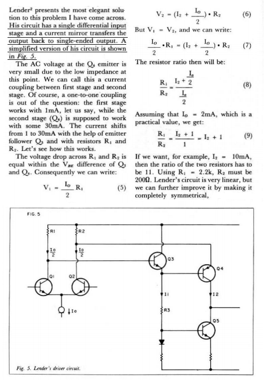

I would have to think that the local feedback, accomplished with no extra parts, would have to improve the linearity.
Do you have any measurements to back up your doubt?
Could it be improved on, given a different topology and more parts? Maybe, maybe not. Tests and measurements might help, but will it sound any better?
Active current sources for loads in the front end improve the open loop gain, and while that reduces the distortion measurement, it may sound worse. Is this progress? Is this worth increasing the complexity and parts count?
From my perspective good amplifier design is about maximising forward path linearity while maximising forward path gain, and, simultaneously, minimising forward path poles.
Folded (or complementary) cascode arrangements like those of Borbely and Lender are effectively single gain-stage designs which do not maximise forward path gain or improve forward path linearity anywhere near enough to justify their use.
The best compromise is obtained by using a two stage design where local feedback can be used to enhance forward path linearity without excessively reducing the forward path gain necessary for adequate loop gain when major loop feedback is applied.
Moreover, the two gain stage design generates two dominant poles in the forward path that can be split by means of minor loop feedback (Miller compensation, TPC, "TMC") about the second stage to stablise the major feedback loop.
".of course active current sources add to distortion. "
I have actually seen measurements showing the distortion decreasing by an order of magnitude, yet listening tends to show the opposite.
"Folded (or complementary) cascode arrangements like those of Borbely and Lender are effectively single gain-stage designs"
Are we talking about the same topology?
I think not.
Maybe, reading EB article in a thorough manner will help to uncover the
"mystery" of Lender design.🙂

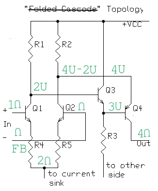

To help folks to understand the specifics of these arrangements better, I supplied
the Lender-Borbely input circuit with the signal flow (digits) and the signal polarities
(U, and inverted). That will explain that there is no cascode action whatsoever,
and the Miller effect is reduced only due to the Neg. FB signal' amplitude reduction.
Without Neg. FB the Miller effect at the input FET will be in full bloom.
In fact, we create the same problem for the second FET in the LTP, which receives
the FB signal.
The correct assessment of this arrangement was given in:
www.diyaudio.com/community/threads/power-amp-driver-block-topology.2309
posts ##2, 6, 16.

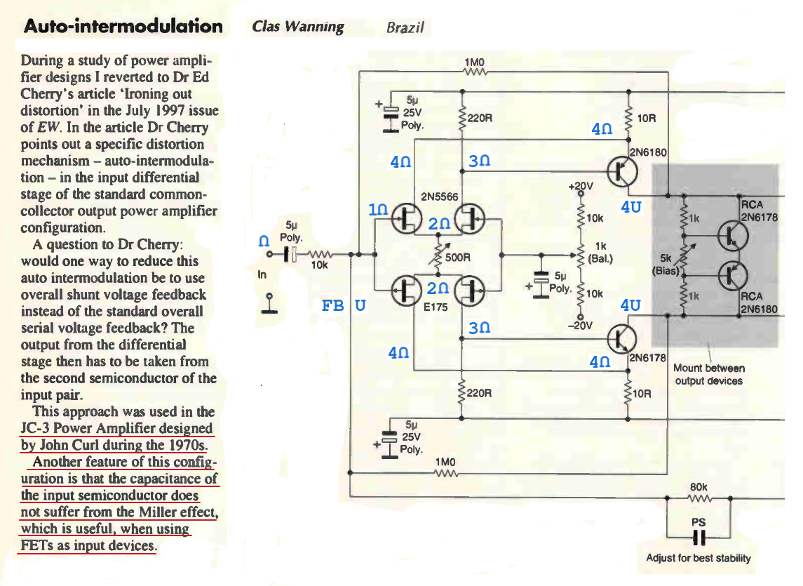

In comparison, JC3 input (schematic is taken from LtE in the "Wireless world" mag.)
not only compensates the gate associated input capacitance to zero, but can
overcompensate that C when the bootstrapping action will turn into the Positive FB
due to excessive first transistor gain ⩾ ½Gm×220Ω -if it will be more than ≈1.
That compensation is important since we employed the series 10KΩ resistor at
the input in the shunt/parallel Neg. FB arrangement - to eliminate/reduce the
significant value of the input τ=Rin(10K)×Cin.
And in this circuit there is also no cascode action whatsoever, just bootstrapping -
imposing the proper signal polarity on the input FET' drain for the desired effect.
Consider yourself warned.☝ ☺

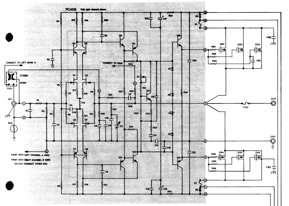

It will be helpful to some members here to add an useful observation from JCarr on the subject:
Very interesting.
Just one comment, from having looked at many power amps from Borbely I can say that he usually cascodes the input quad. Sometimes he uses a fixed cascode, sometimes a Baxandall (common base/gate referenced to emitters/sources, not fixed).
I like the Slone dual mirror, I know it's not a straightforward thing (as shown in the book it has undefined bias, unbounded VAS drive - no current limitation at all). I am working on my solution in the sim, and I want to give it a try
Hafler-XL280 (probably designed by Mr. Borbely)
At first glance you might think the schematics are wrong (look at the references for cascode bases).
What he's doing is very clever: the driven cascode is used only for the P-channel jfet, the 2SJ72. This arrangement mitigates the reverse transfer capacitance, bootstrapping it to a good degree. The P-channel is much more troublesome than N in regards to capacitances and high frequency, but with this bootstrap the whole input stage will behave more symmetrically at HF.
Reactions: DavidT and mlloyd1
