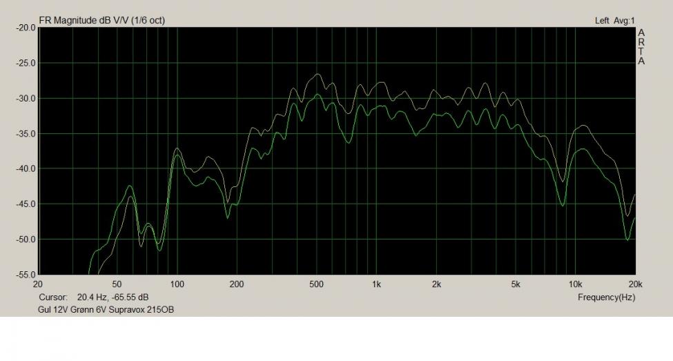

"This driver also have a broad peak who is not representative for the overall sensitivity. I have heard this fieldcoil version and it lacks a little bit attack IMO"
Attached is a meassurement of 215 exc OB in my living room
Can you show me what you mean?
Oooops, are you here 😱
I was refering to the measurements here: Supravox 215 EXC Mesurements - page 1
Is your measurement on axis? Lookin good. But still, my main focus in this thread is max SPL pr W.
