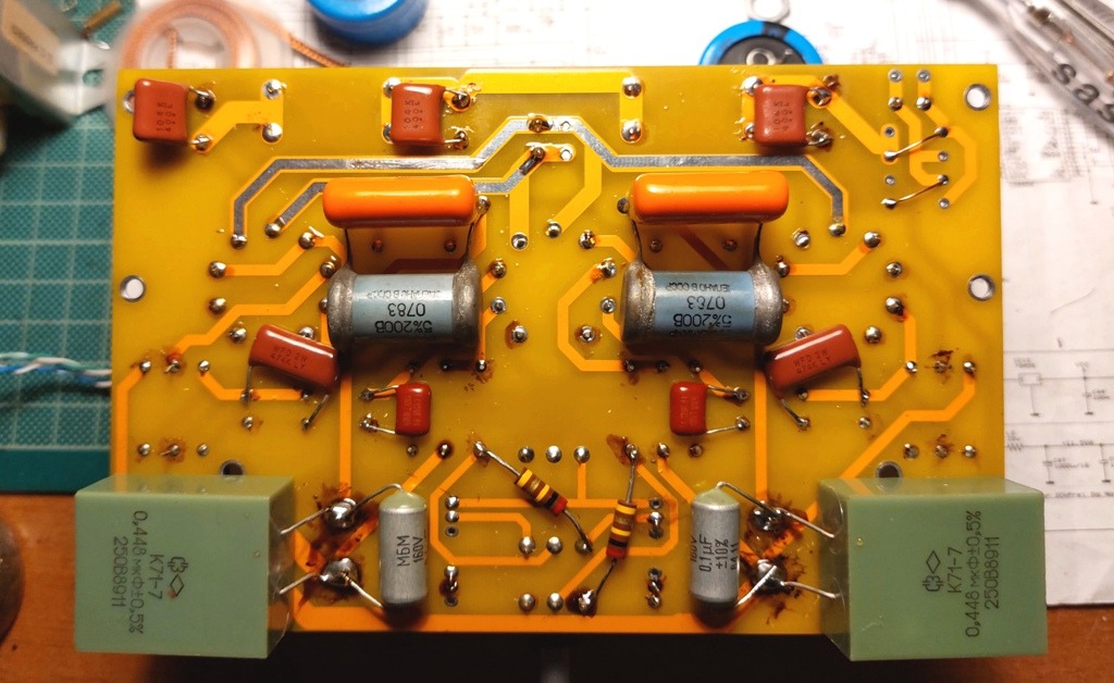

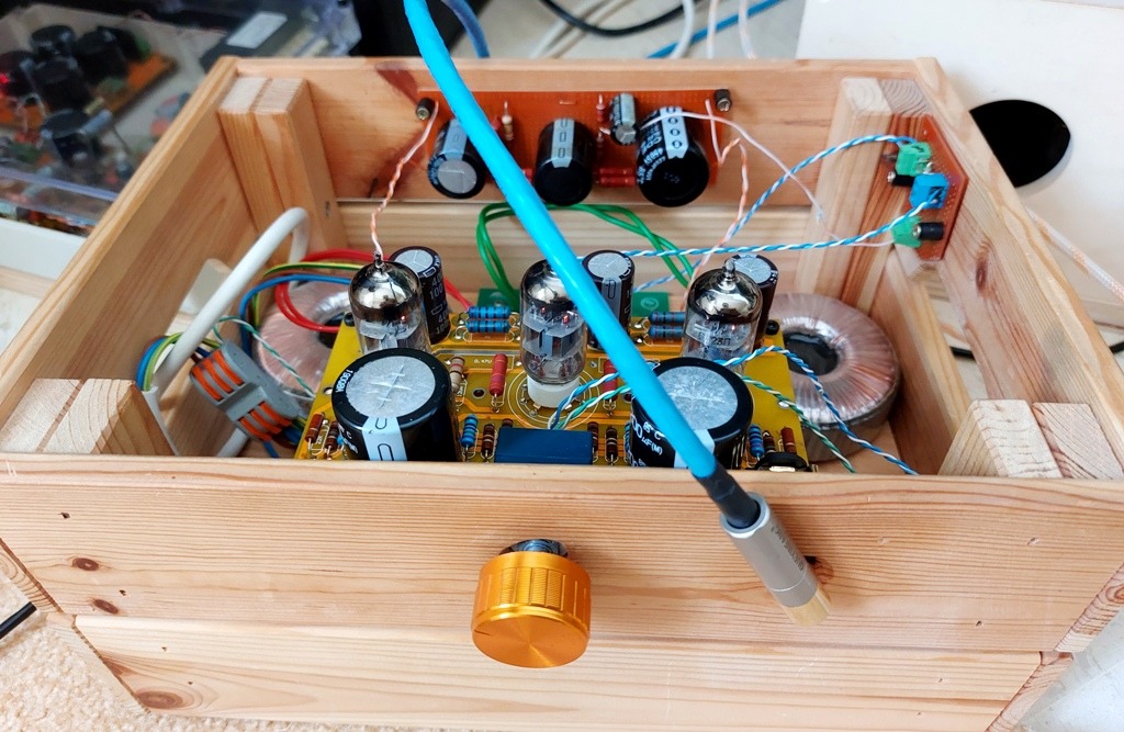

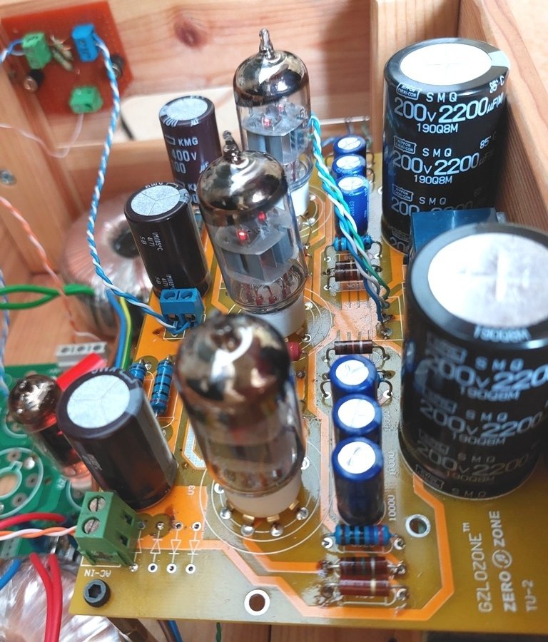

Hello folks.
I recently joined you in building an optimized version with feedback. Tubes used, are ex-Soviet 6N23P.
Followed the schematic provided here, with some minimal modifications.
Changed 22kΩ output resistor to ground to a 2200Ω one, in order to minimise pop when inserting my 50Ω cans.
Also bypassed all electrolytic with ex-Soviet paper in oil & polystyrene film.
A nice 'fix', especially for those worried about using electrolytics in the signal path of any OTL.
When in parallel with good ol' PIO & film caps, there is no loss in transparency due to electrolytics.
Quite on the contrary, they blend perfectly together.
To the point that I sometimes use bypassed electrolytics even if I could avoid them (i.e. in positions where value needed isn't more than 10uF).
But, I digress.

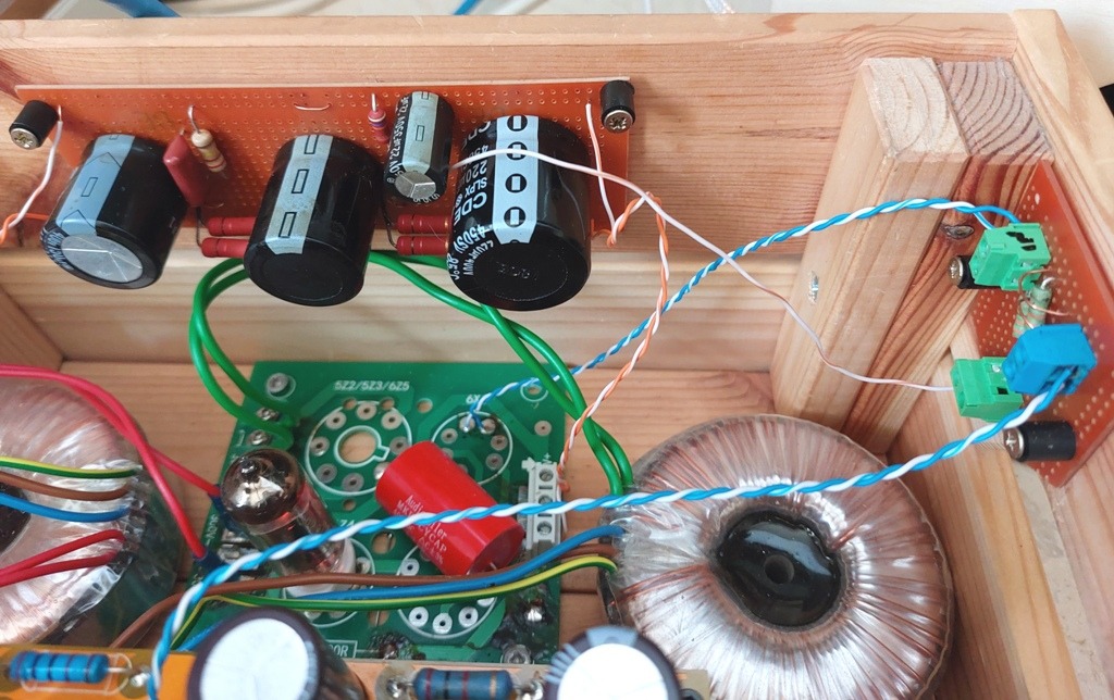

Power supply wise, i used an indirectly heated 6C4P-EV valve rectifier, followed by R-C filter stages.
Heaters are all AC-lit with an artificial center tap and eleveted at around 50VDC. The amp is dead-silent.
The end result exceeded my expectations.
This little amp sounds very good, in my opinion.
Better than several previous builds of mine.
For example, it's more detailed and dynamic than Tortello's Zen-like solid-state.
And better articulated than my valve-rectified 6922 + 6080 OTL.
Some pictures:
I used this IKEA box until i find something better to put it in.
PCB top side
PCB under side
PSU section
