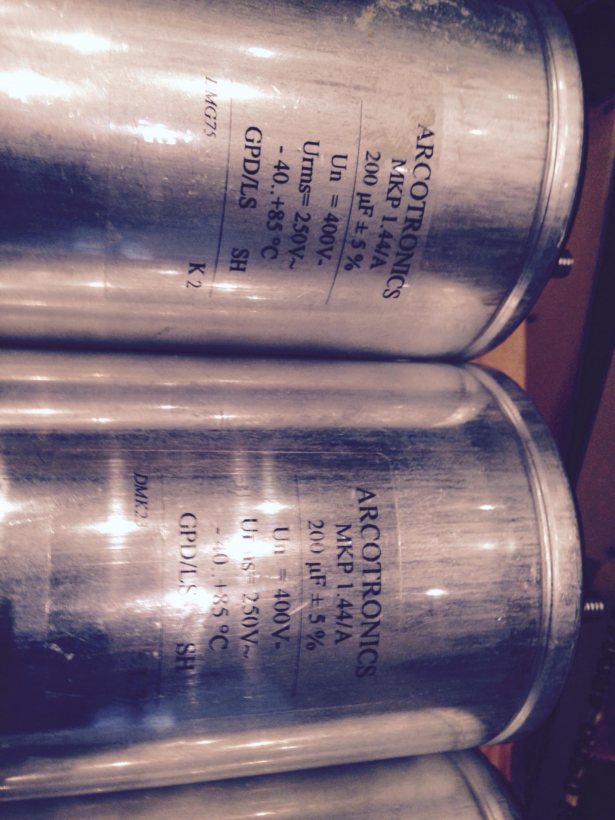

My guess is that most of the verdicts on the sound of this amp will be verdicts of the output caps. Anyone tried with big MKP or bypassing HQ lytics?
I did. I didn't have room for big MKP's, but I bypassed the 470uF 'lytics with some nice MKP.
