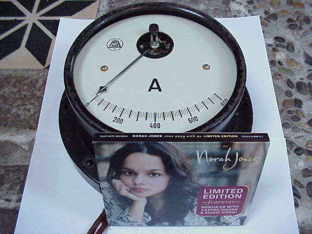

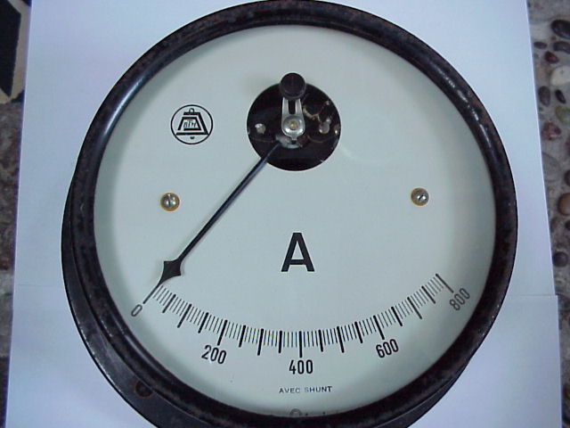

I have no idea what kind of currents we are going to face in the monster amp. Since I’m not involved in the development but would like to contribute in some way, I might have an interesting item to add for the final layout.
Here’s a massive ampere meter. As you see the range is 800A and the diameter is 18cm (+/-7.1inch).
It weighs 2.3Kg and if the shipping costs are reasonable, I’m prepared to donate and ship the thing to the ‘final assembly plant’.
/Hugo 🙂

OMG! Do you have six of these (or know where I can get ‘em)? I suspect the Environmental Protection Agency would pay us a visit if we biased them to 400A, but a snazzy new brushed aluminum faceplate with a PASS-ified scale would be oh-so-cool…
PS: Nice CD too! I have her on 5.1 SACD. A definite favorite.
PPS: I’ll try and post a construction update some time this coming week.
-Casey Walsh
