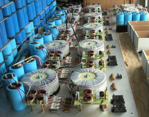

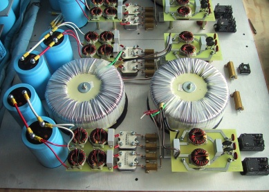

And links to HiRez versions...
http://photonlogic.com/PicServe/PM/IMG_3187.JPG
http://photonlogic.com/PicServe/PM/IMG_3181.JPG
-Casey Walsh
-Casey Walsh
that is A LOT of work you got going on there!
looks great! I'm glad to see you making headway on this project.
Can't wait to see the end result.
