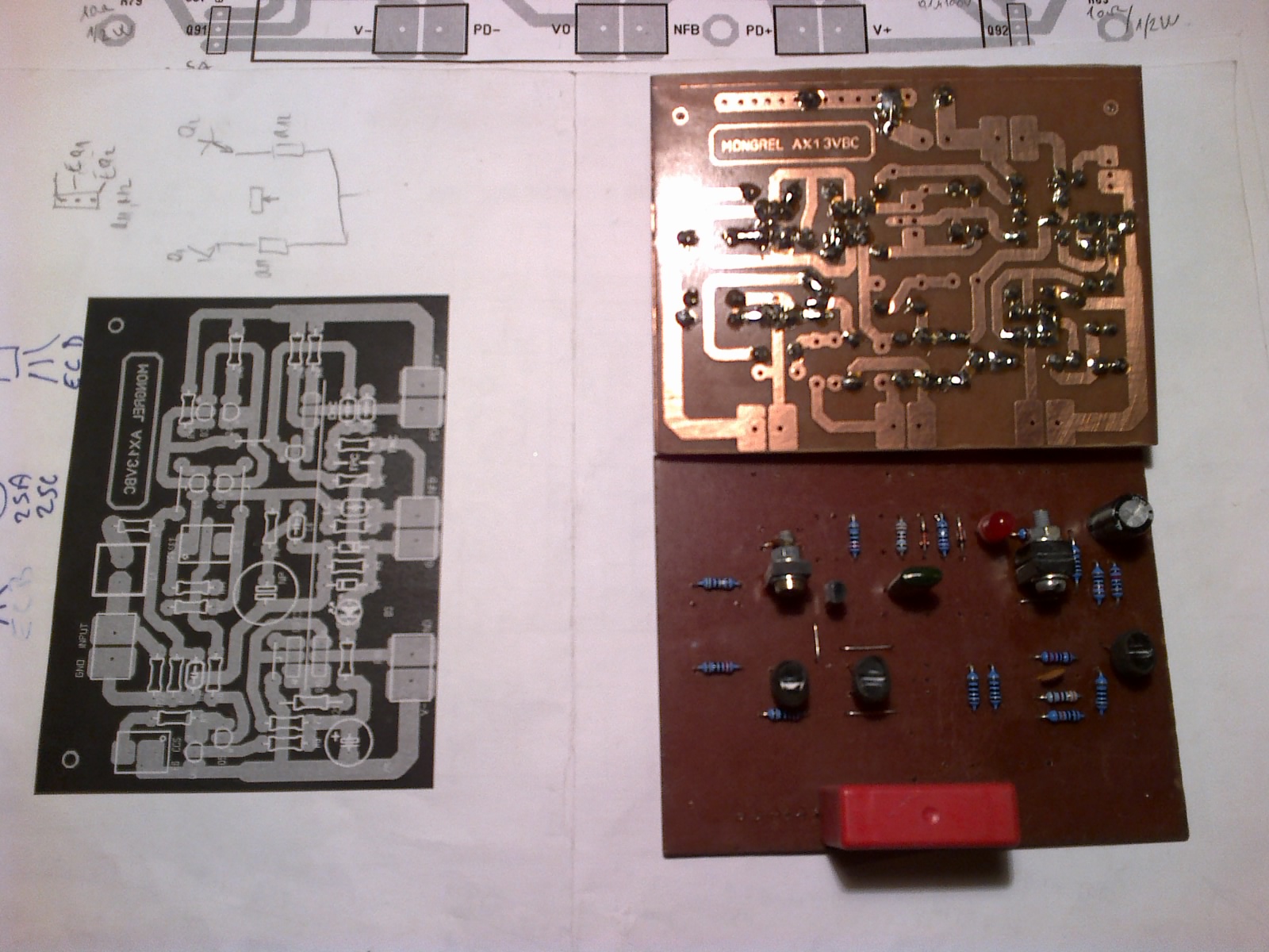

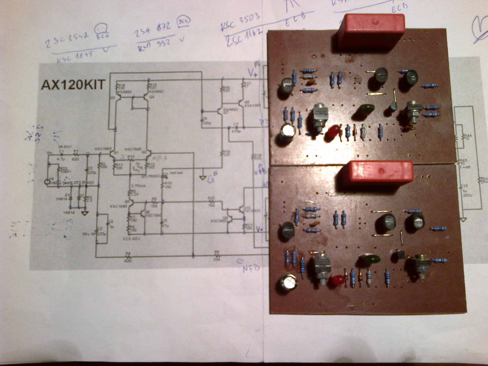

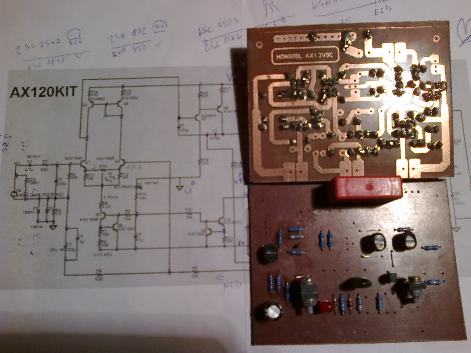

AX1,3 final KIT
I got no help about misterious R8 in CX1.3 so i decided to do a copy of a final version AX1,3 and here it is. I sincerely hope that someone will still help me about CX1,3 and R8 problem,just point me where to look or how to think about it.

Maybe this would help? I am not so sure what is the latest schematic but this is what i have:
I am guessing that R8 is the resistor in the tail of the input LTP, before the CCS.
But the pic is so out of focus I can't read much of it.
What's the point of posting a >500kB pic that can't be read?
Yes, I'm sure that's a 2.2k resistor for R8. This resistor isn't needed for dissipation reasons; It was intended to increase the CCS impedance at high frequencies. It does help during fast pulses. I would put it in, but you could just as well short it.

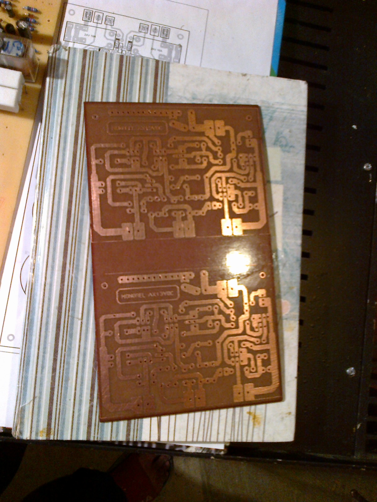

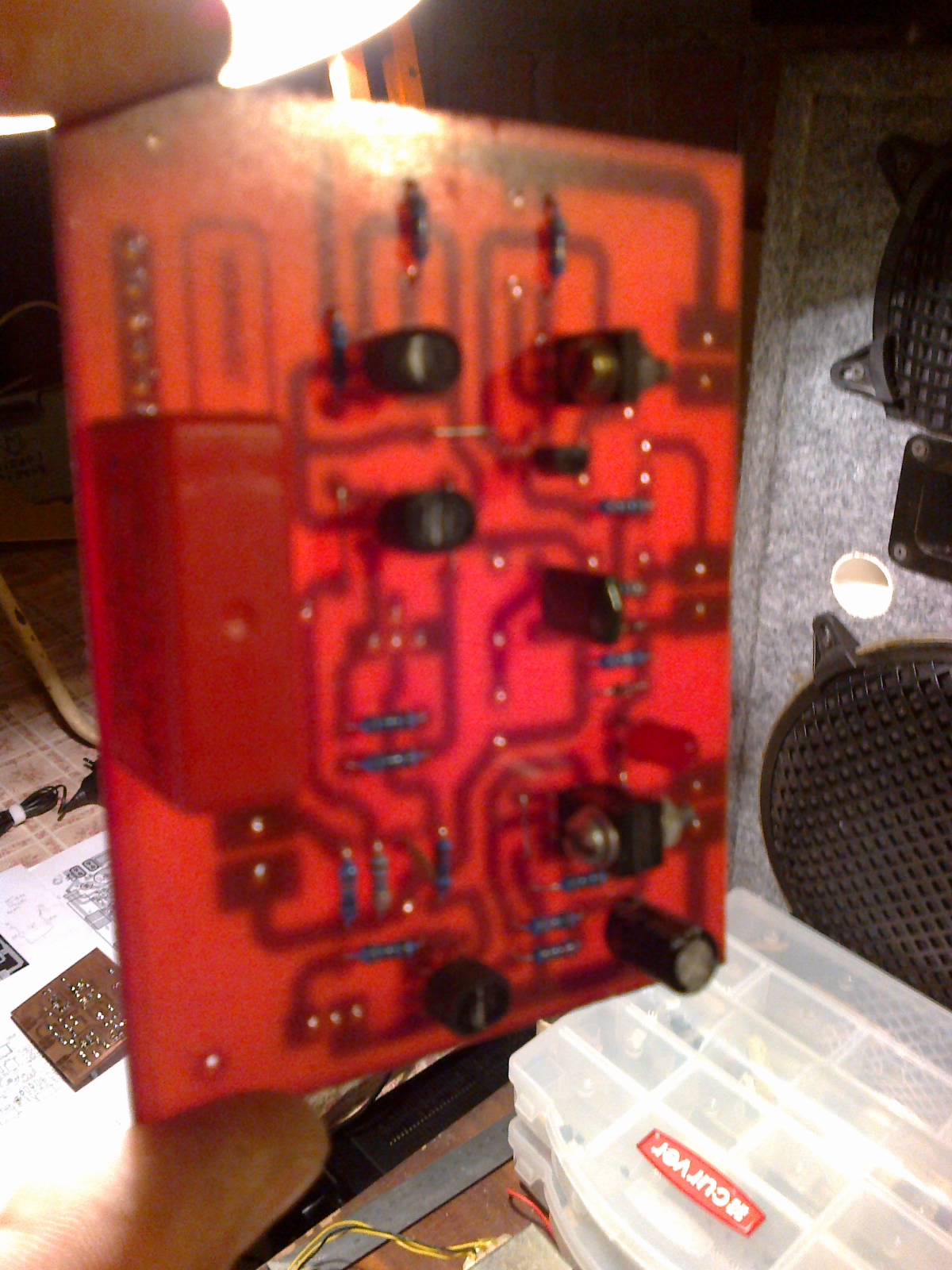

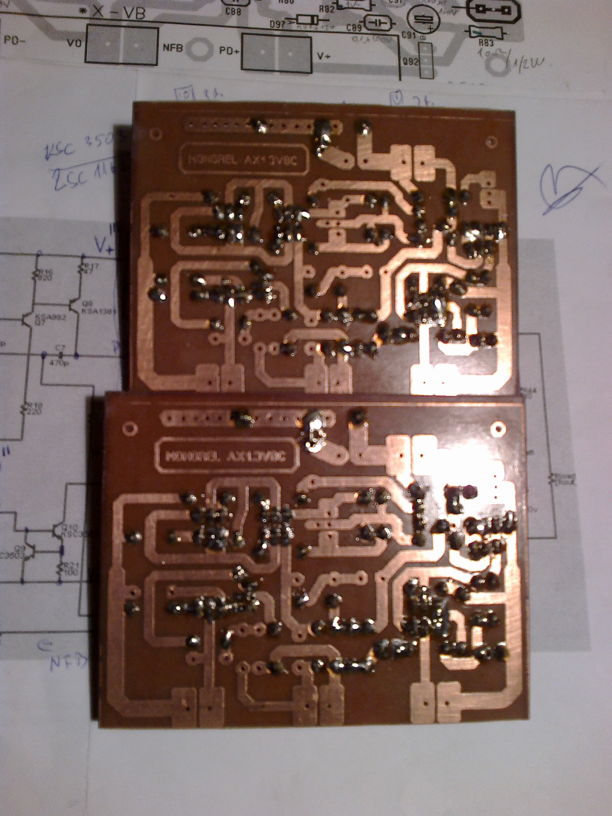

This is what I ended up with. No more changes , it will fit in my nice Altec case.
I just have to label it , run the snot out of it... before I trust it for others. I can't blow my one prototype , so I don't fear the stereo pair. (below)
If alex can come close (but prettier) to the style below - let em' at it.
A long board is the one on my single prototype now , below is the "L" bracket deal.
