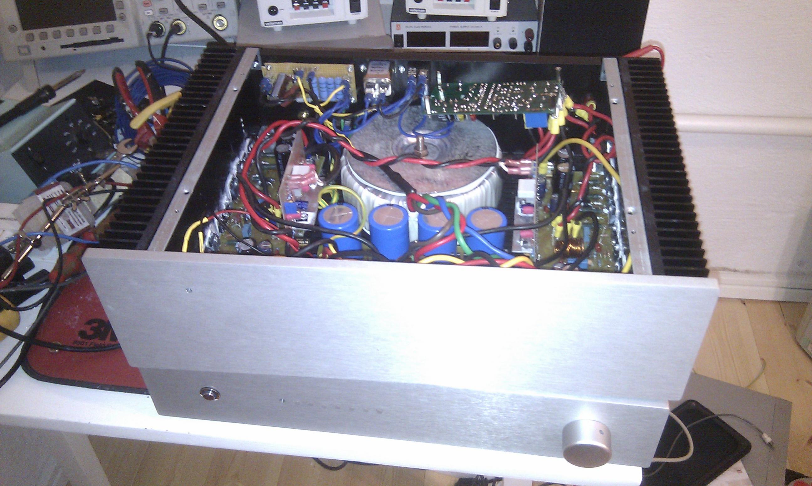

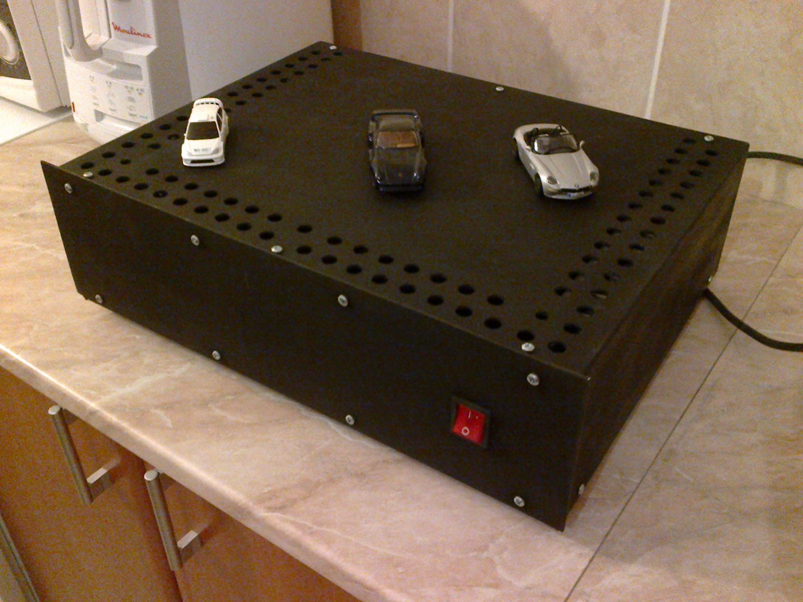

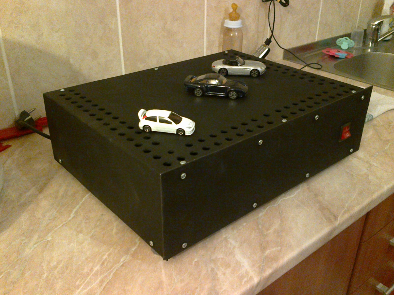

After building occasionally for the last half year I put the lid on to my AX-PB250 combo today.. It sound very nice and it does not loose grip of the speakers even at very high volume. Much better then my old arcam A75 in all respects, The old amp temporaily acts like a preamplier until I've finished the one I am building (below in image). I will get there some day....
For a while I had some hum problem, very weak but audible close to the speaker. By rearranging ground connections and cabling it became lower but did not disappear totally. It also got worse when connecting the pre-amp, indicative of a external ground loop. It turned out that the ground lift diodes, D1 and D2, both had blown on both boards. On one board one was shorted and the other one open. On the other both shorted. Must have happened during early testing where also some transistors blew. However, after replacing the diodes it is really silent
The board upside down in the back of the amp is a speaker DC protection and delay circuit. There was no space for it other then mountning it on the lid.
Thanks to OS and al others involved in this design.
/Pelle

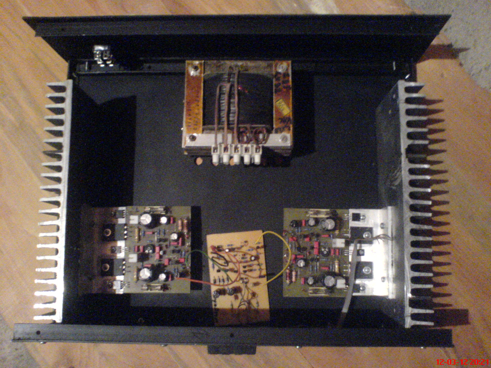

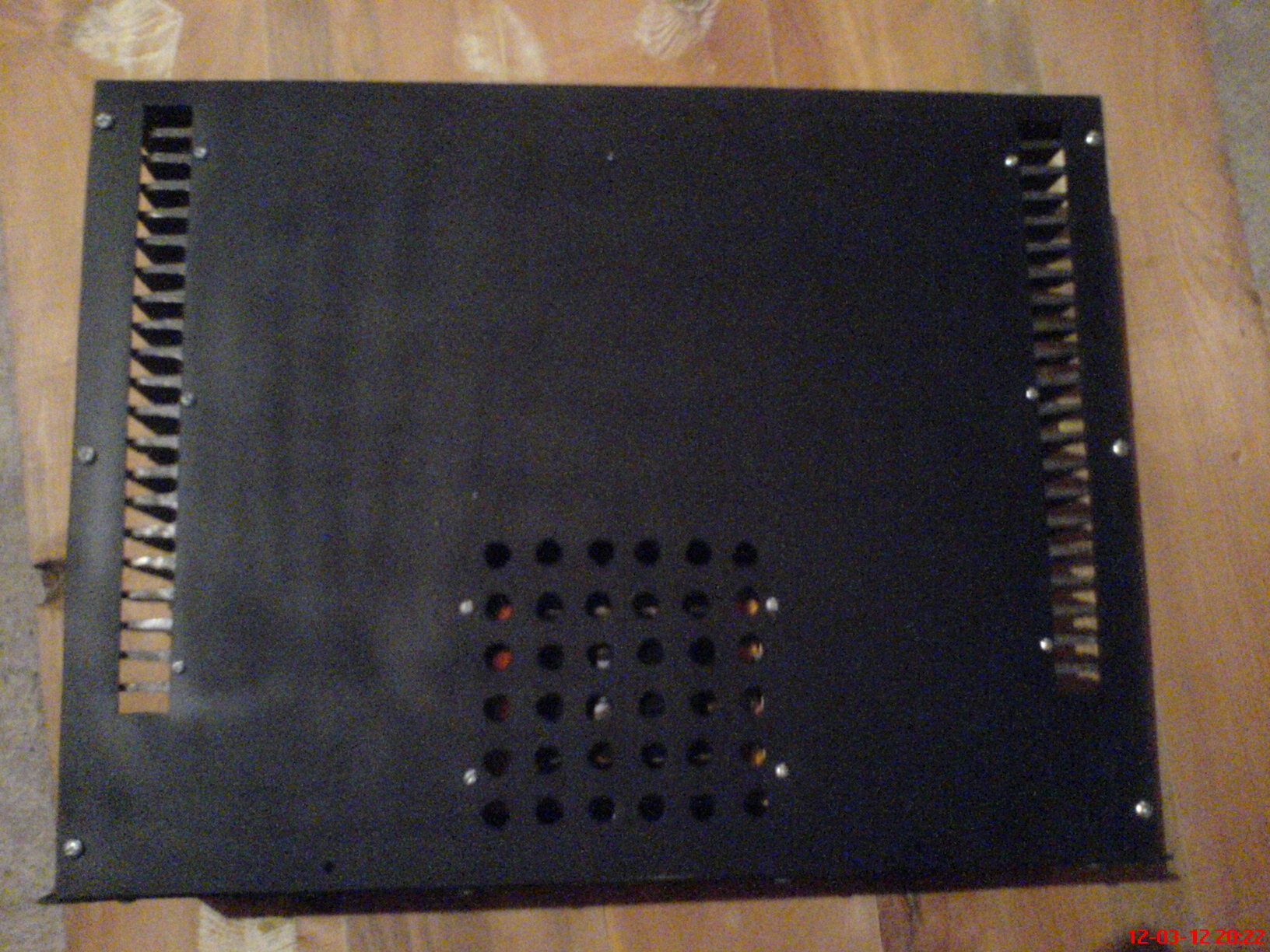

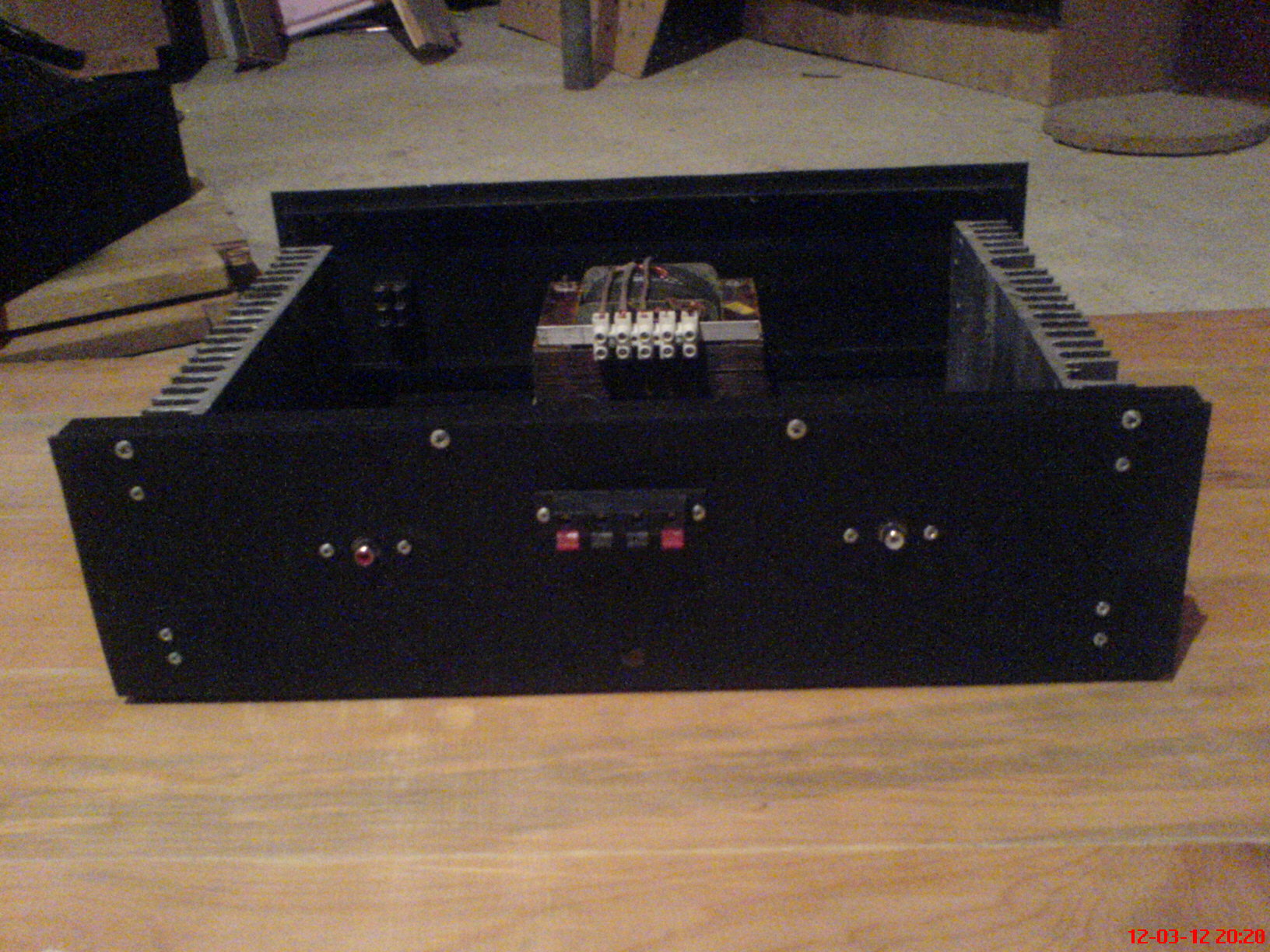

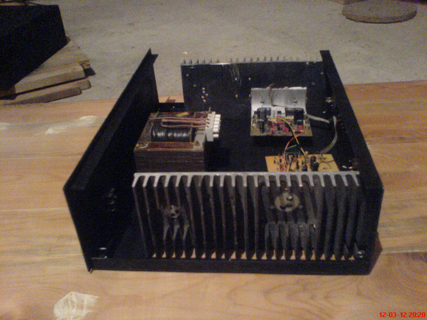

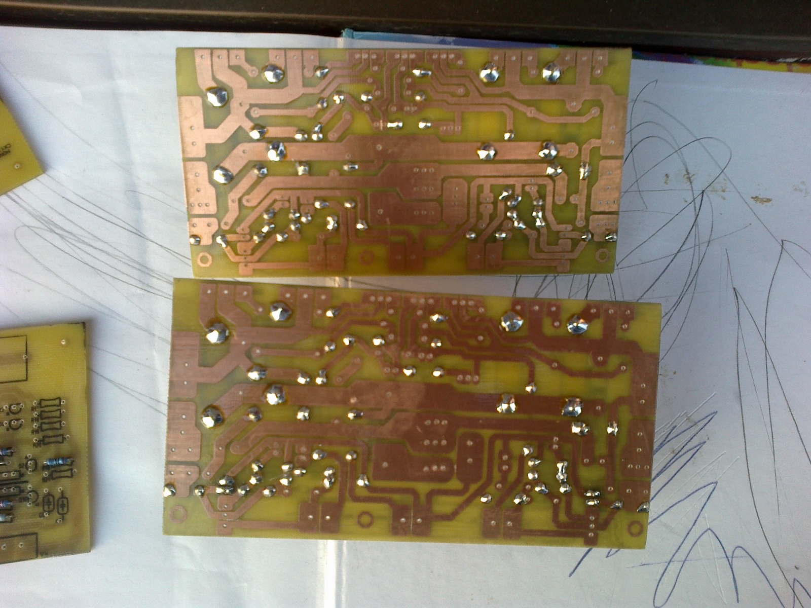

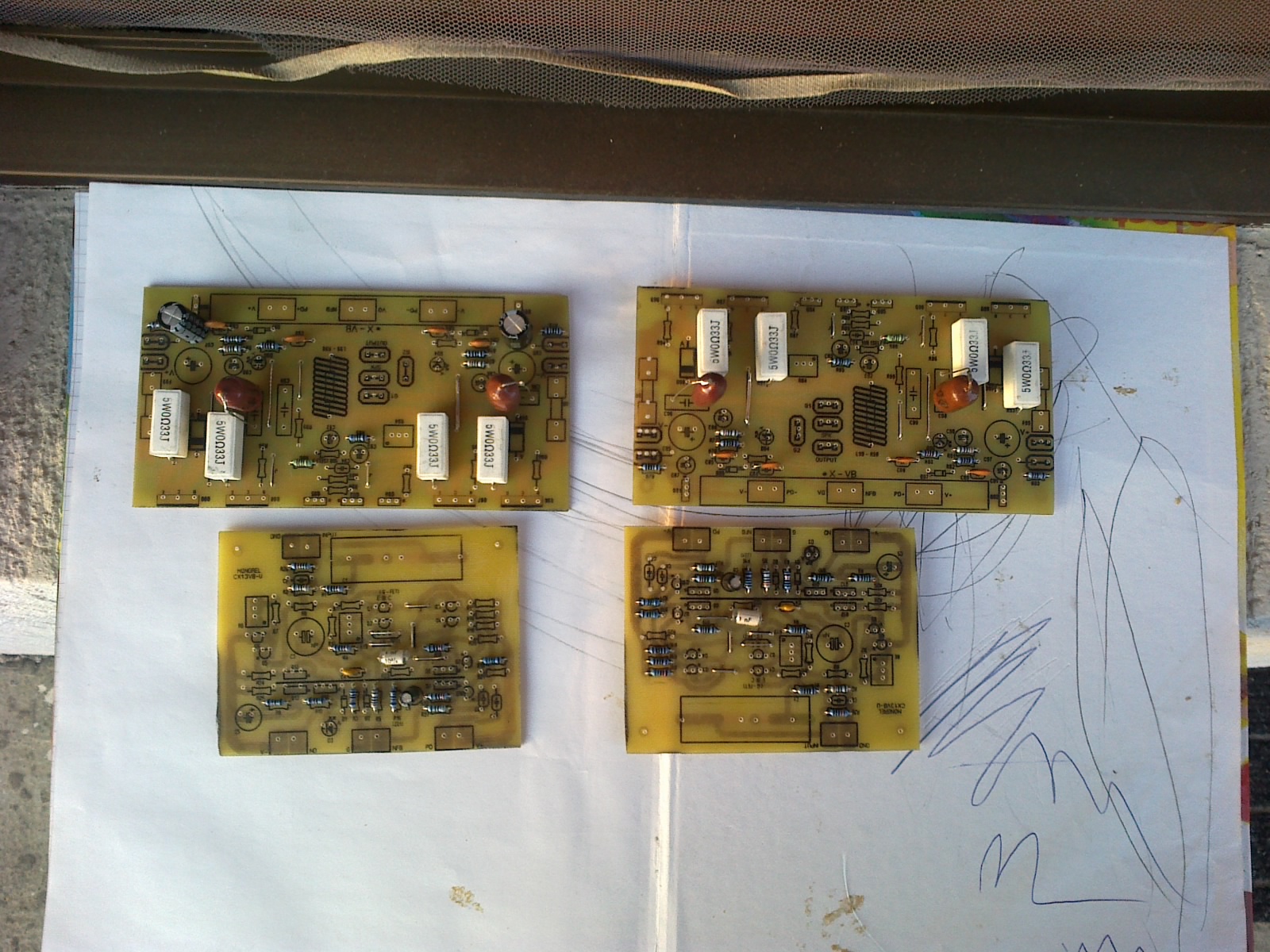

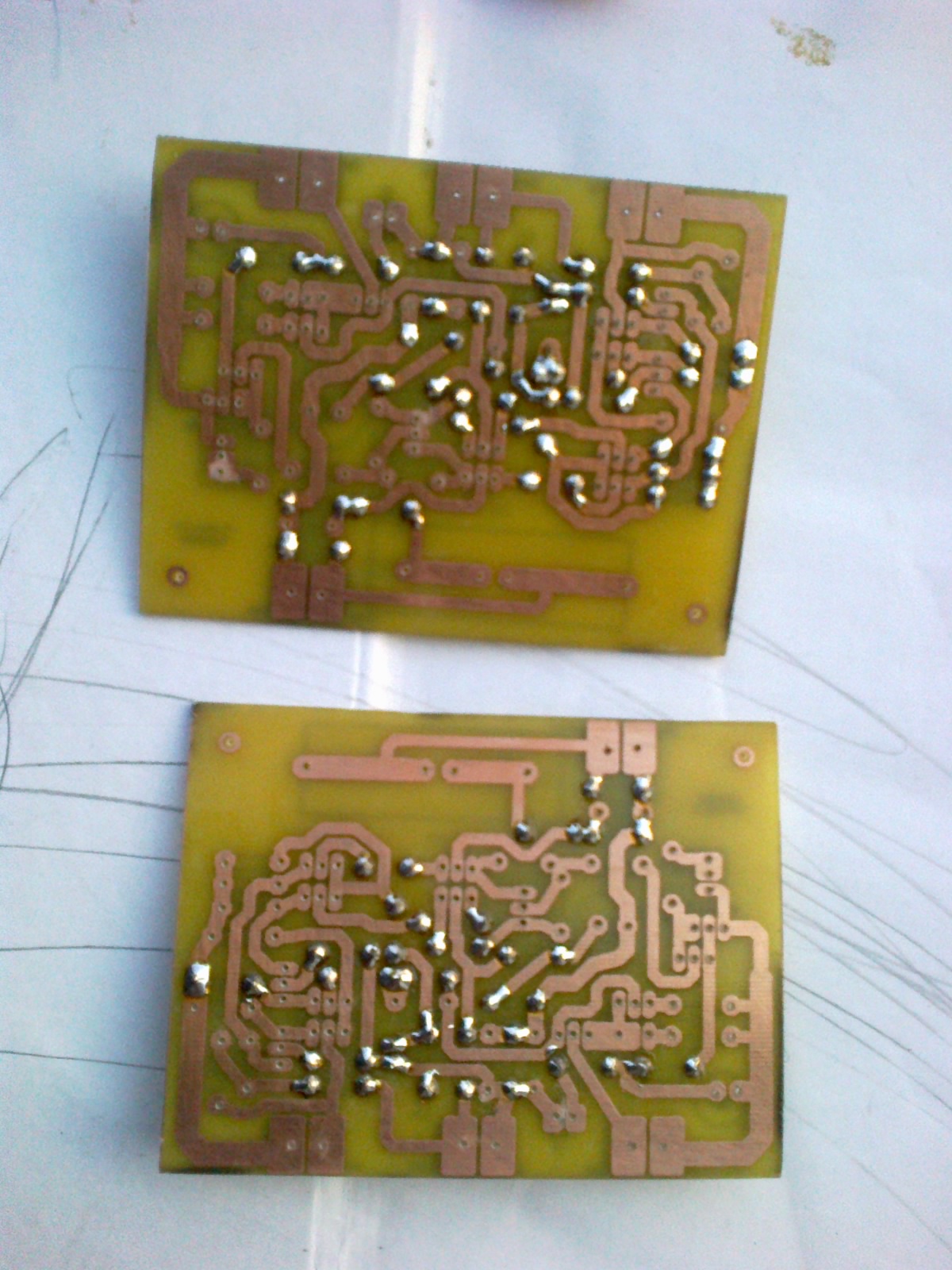

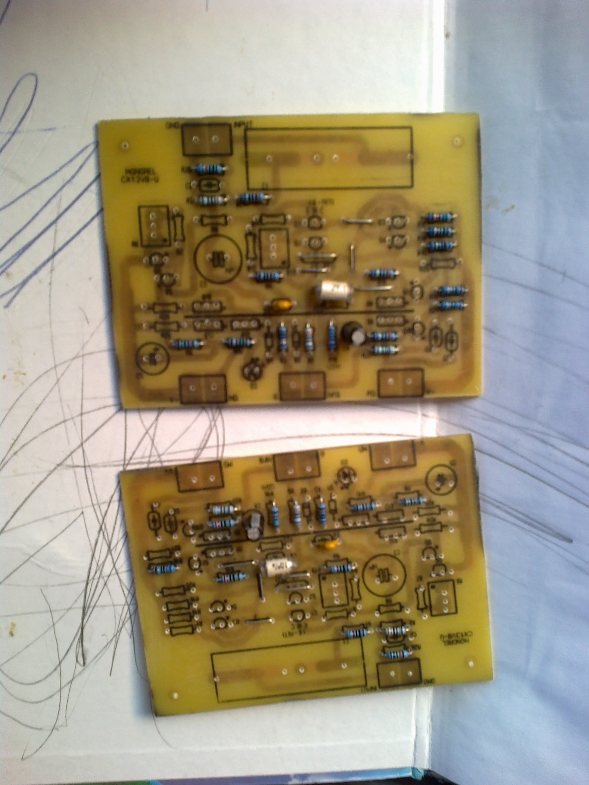

nikko (http://www.diyaudio.com/forums/solid-state/169590-mongrel-supersym-ii-129.html post #1287) has given me a pcb of SymAsym a few years ago,and told me that this would be logical next step. Recently i have re-done a SymAsym case and i am listening it right now. I have another case with 1kVA transformer with 2 x 35Vac,heatsinks and 4x20 000uF in PSU and some parts. I have asked nikko for files but he had some troubles with his computer,his hard-disc collapsed so i decided to search for a whole thread to find needed files. So i started with page one,have read a lot of things i don´t quite understand (i´m a beginer and practically just assembler,but anyway i cought some guidelines "how and why" ) and on page 181 post #1808/1809 found all i need-thanks to repeet!
OS did a great job here,he shared each step he did with the readers,fought out on his own with all opsticles that were before him and unselfishly shared numerouse files and experiences with all of us. THANK YOU SO MUCH OS!
One question for a start-i have two pairs of MJE21193/MJE21194,can i use them as output transistors? Also i have two pairs of 2SA1943/2SC5200,wich (if any) would be better replacement?

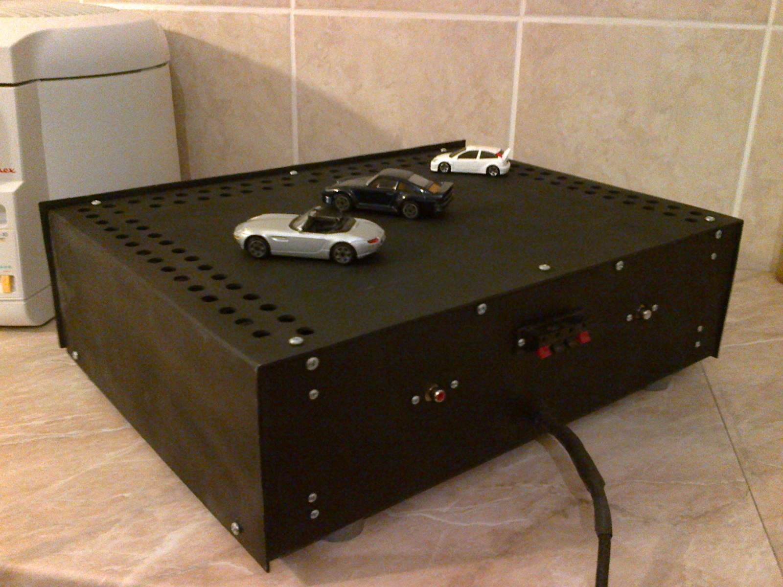

Here are some pictures of SymAsym,and hope soon there will be some pistures of a PB120N.

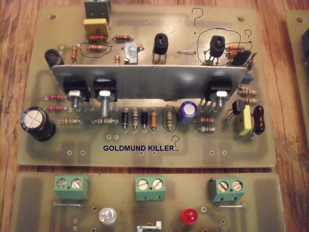

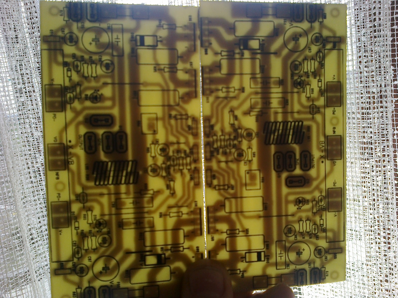

I have a few questions about CX 1.3 VB-U
The emitors and collectors of Q3 and Q4 on layout have switched their places comparing to a schematics.
1;On schematics the emitter of Q3 goes to a collector of a Q1,and by layout the collector of Q3 goes to collector of a Q1.
2;On schematics the emitter of Q4 goes to a collector of a Q2,and by layout the collector of Q3 goes to collector ofa a Q2.
3; R8 exists on a layout and picture of finnished pcb but there is no R8 on a schematics.
4; Also,places of R16 and R17 are switched.
Could anybody please help me about this...
I have done that,and pinout of transistors are correct as they are on right down square of a schematic. Same thing is in VRT,so the pinout for him self is ok.First thing I would check is transistor numbers and pinout for these transistors.
The pinout on a pcb is not,and I think that the pins E and C should switch places.
The resistors R16 and R17 should switch places too,and judging about a text that says "12/15V zener optional for R17" the value of R17 should be 15kOhm because in series with 56kOhm and about 50Vdc supply the voltage on the base of Q3 and Q4 would be 12Vdc.
R8 is one thing more,i can´t find it on a schematic and it exists on layout and even on a picture of a finished pcb. I am a beginner in these things and my questions are maybe nonsense but i´d say this time i´m right...
