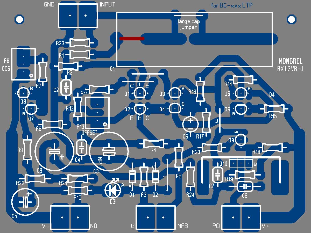

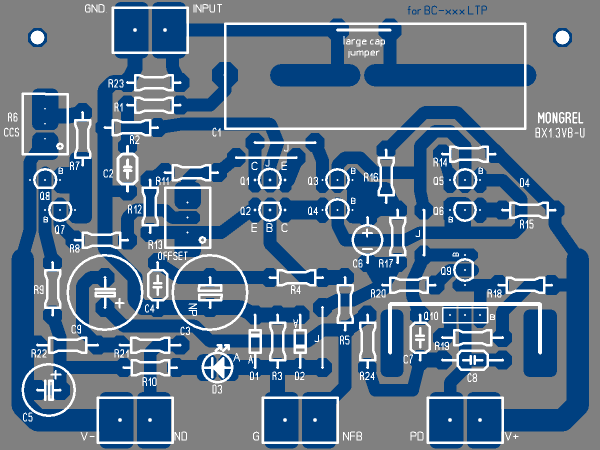

BX1.3 is a "world board".
Added better universal input cap layout and a second PCB jpg. to accommodate
BC556 or similar (BX1.3VB_BCxxx.jpg). It is included in the .zip. Now , since it is cascoded , it can accept ANY fet or BJT to-92 device. Also , C6 has some extra "leg room". :yinyang:
OS

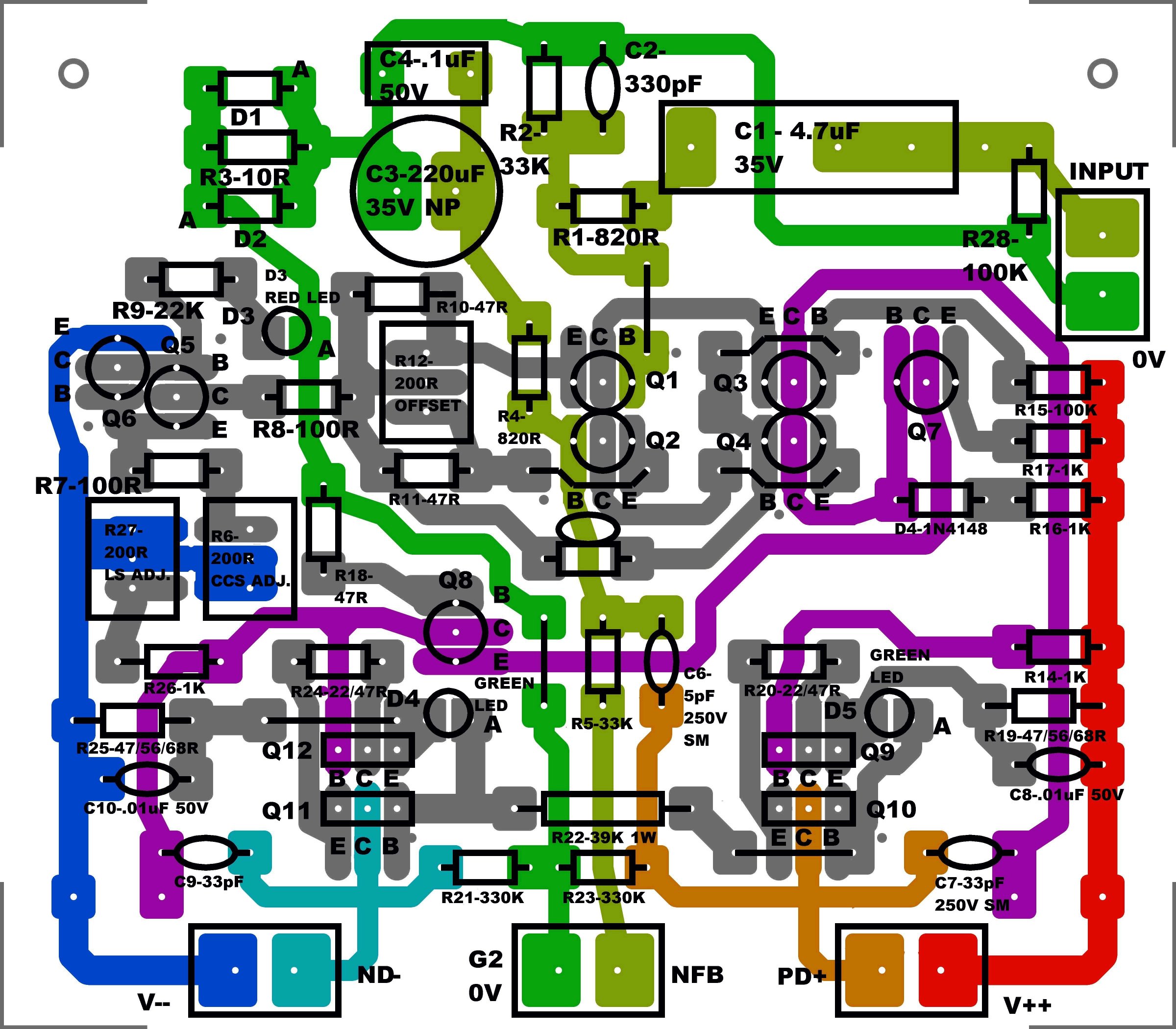

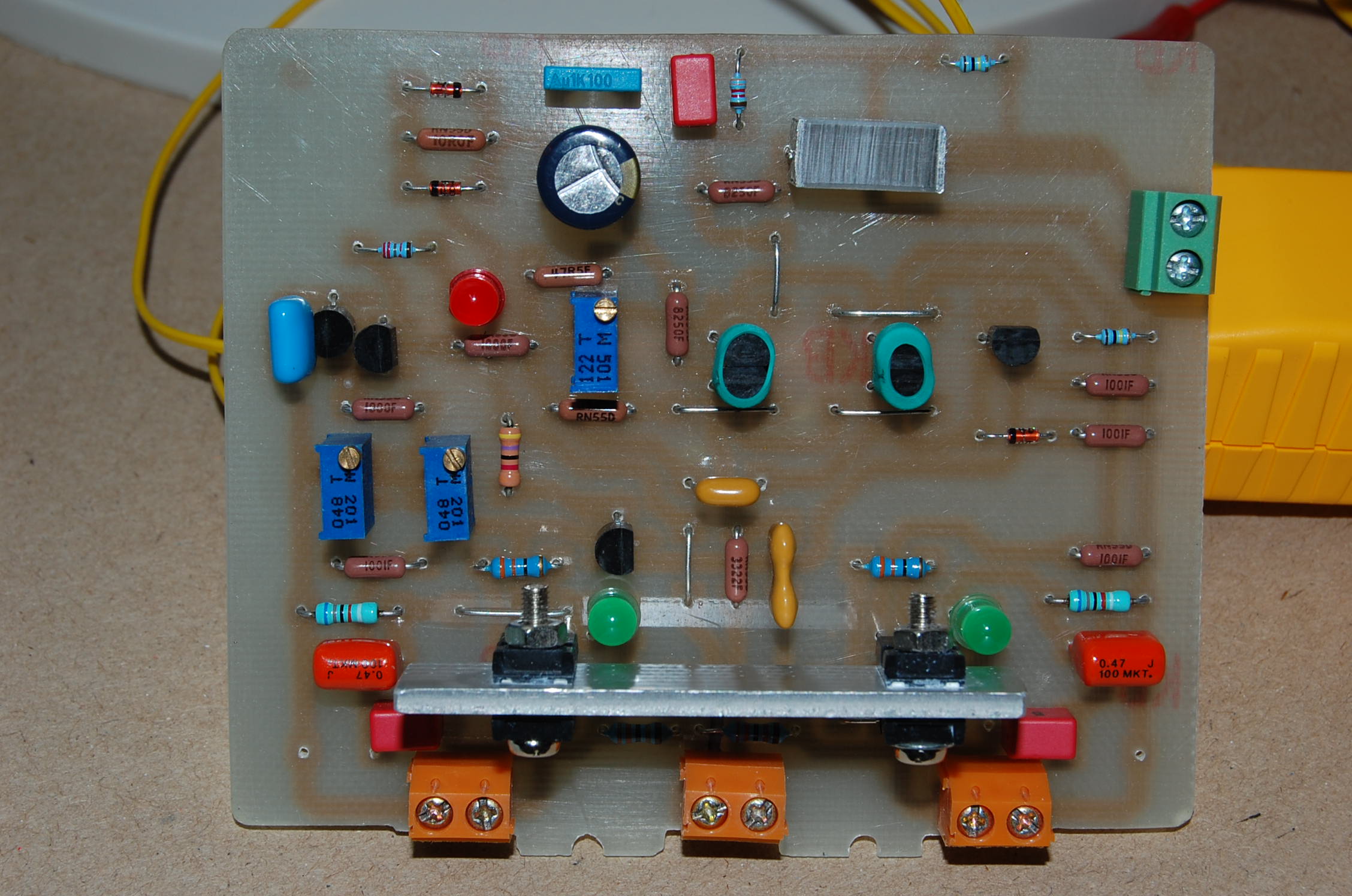

GX1.2 VB Photo
Pete,
Concentrate on the GX1.2 voltage board as the base voltage of Q1 & Q2 does not look right to me. Check the transistor types & the resisters value against the schematics AND BOM AND the Overview diagram, (YES, triple-check & sometime you will find some inconsistencies).
I eyeballed my GX-VB, the flat-side of the green LEDs are facing away from each other - the flat side facing the nearest PCB edge. Both Green LEDs should be dimly lit.
What type of transistors are you using? Post a list here & see if we can spot something.
I attached a picture of my GX-VB so that you can compare against yours.
Cheers, Stanley

If both green leds light up your cascode works , make sure you did not do as me and confirm that you have NFB from the output to the nfb terminal. I still have the original layout/ overview of the GX (below) , even as I will soon give it a "facelift".
