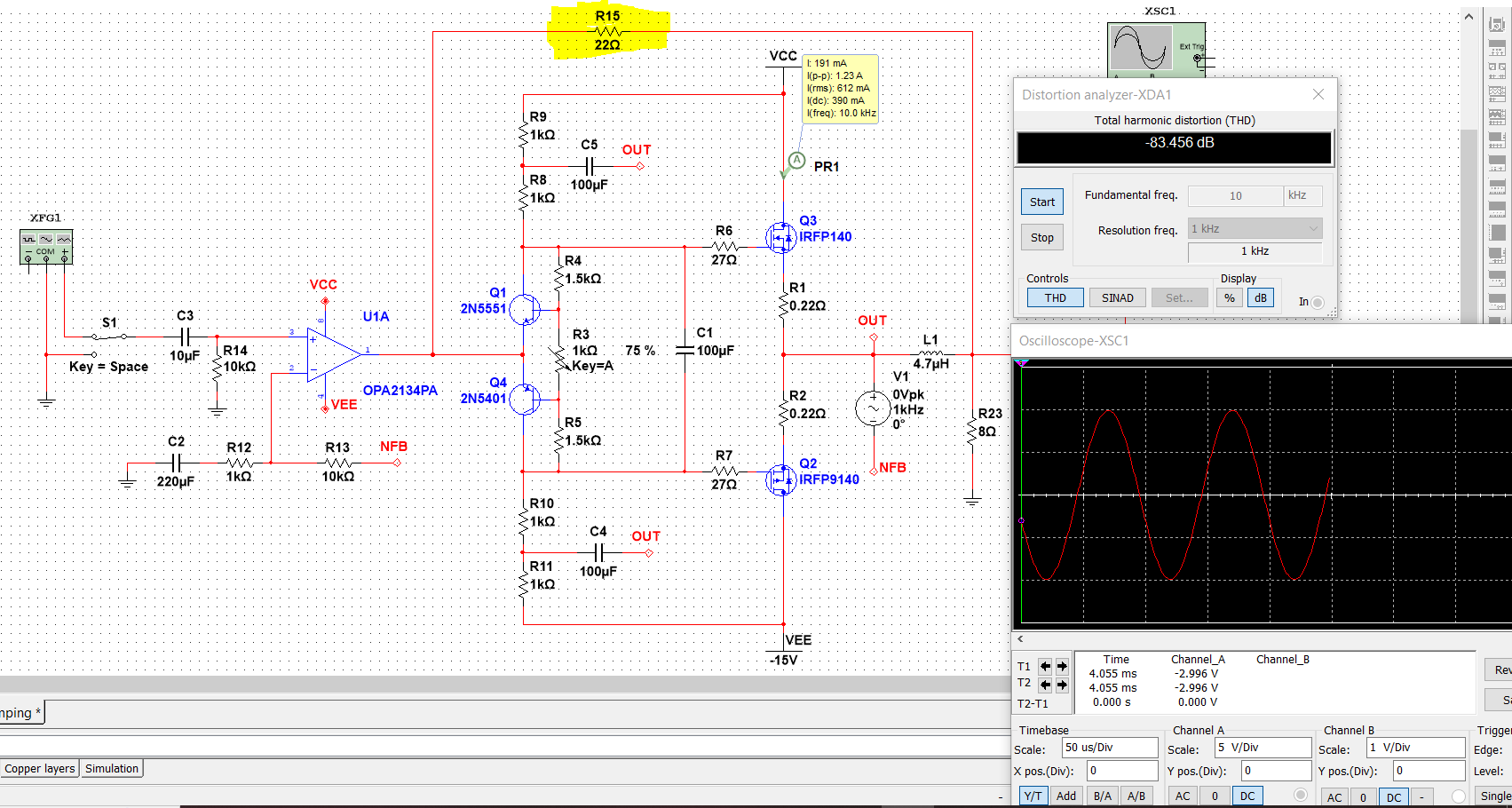

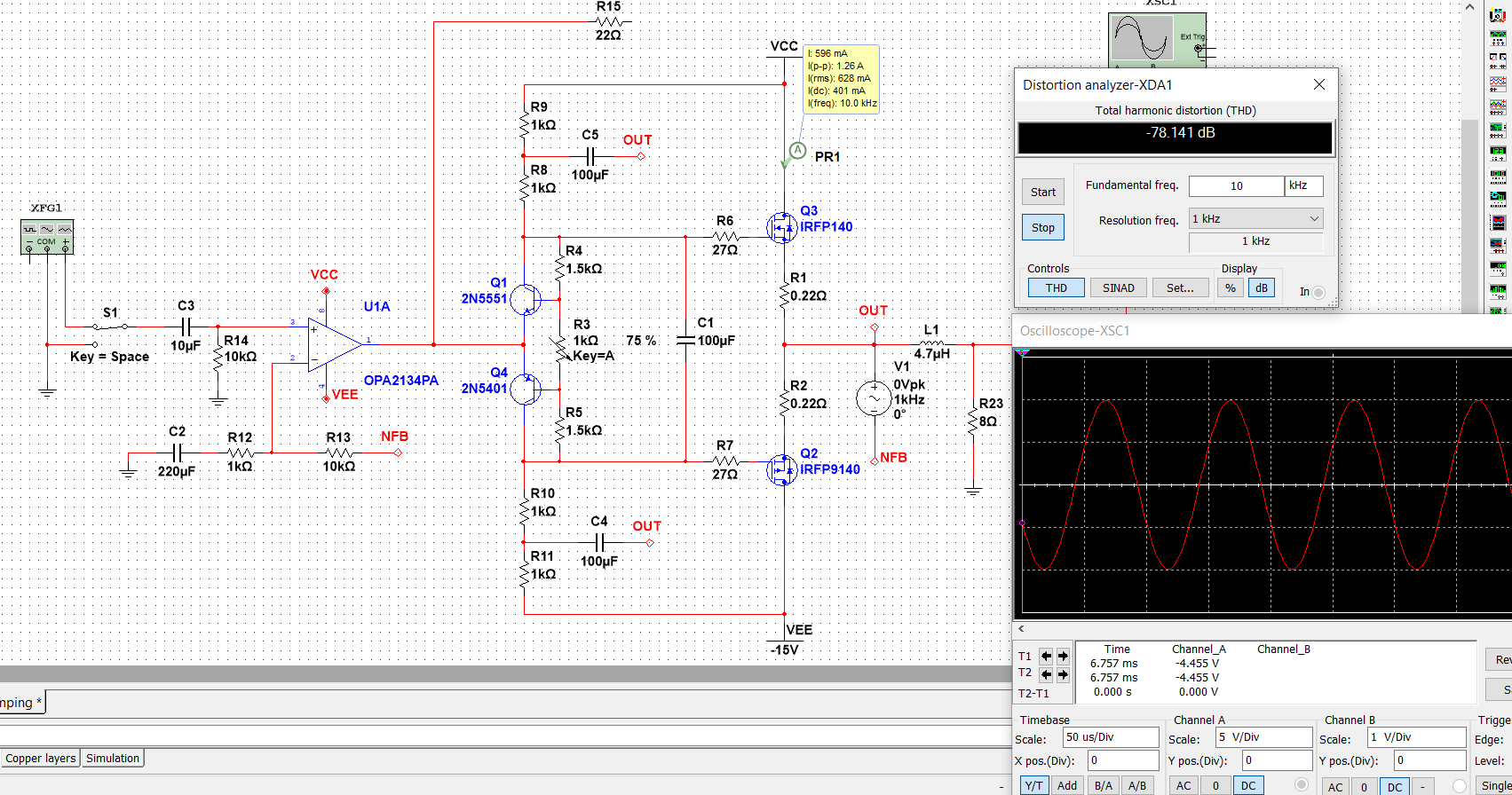

What’s the minimum requirement to use opamp as the input stage of the power amplifier? It might be:
1, Good voltage swing, as the power rail voltage is often limited.
2, A bias network that could provide a fixed voltage for the output stage.
Here we go.
The bias network is bootstrapped, so you loose little to none voltage swing. The output stage could be mosfet or EF2, etc. Change the resistors from the bias network to fit your need.
Here we go.

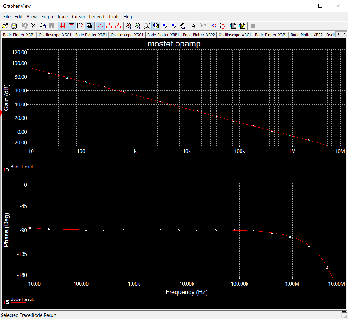

Have you tested the GainMargin and Phase Margin?
You may need a capacitor from opamp output to the inverted input.
As long as keep the unit loop gain bandwidth below 1MHz, it should be fine. Take OPA2134 for example, from its manual, it has “Gain bandwidth product” 8MHz. If the close loop gain is 20 times. Thus, the unit loop gain bandwidth is only 400KHz. I don’t need small cap on the feedback resistor.Have you tested the GainMargin and Phase Margin?

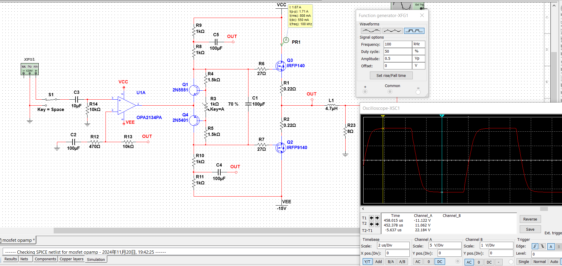

Check with at least 20kHz sine wave signal rail-to-rail to see if the circuit is able to provide enough current to the mosfet gate input, since the input capacitance is considerable (Ciss=1700pF).

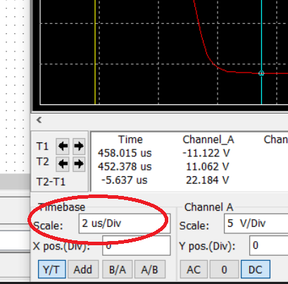

For source follower, the input capacitance is essentially bootstrapped by the output. That should not be an concern. Will do 100K square wave to demonstrate that.Check with at least 20kHz sine wave signal rail-to-rail to see if the circuit is able to provide enough current to the mosfet gate input, since the input capacitance is considerable (Ciss=1700pF).
Sure, for digital source 20KHz sine wave and Vpeak=15V, you only need 1.8V/us.
Even if we consider an input signal filtered @100KHz (LPF) you need 9.4V/us.
