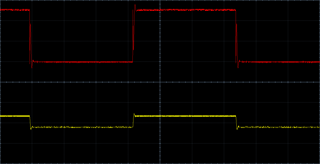

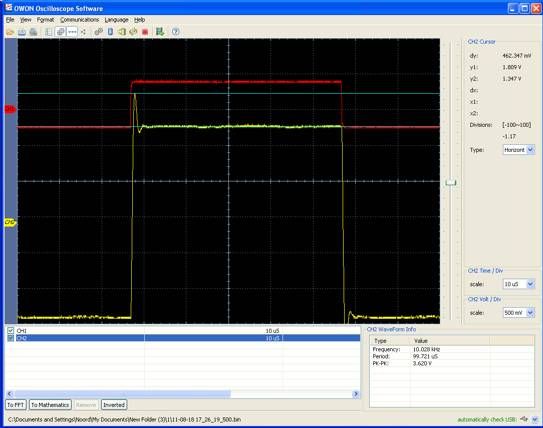

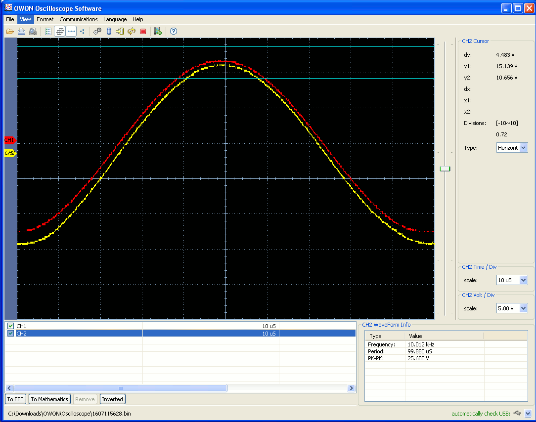

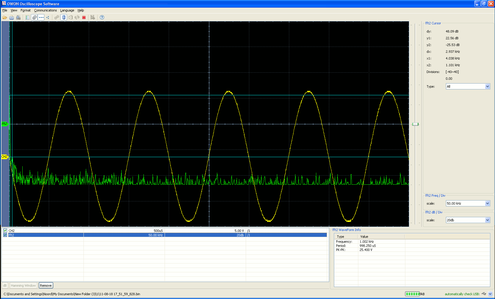

Hi guys, I realised I was posting in the F5 thread so getting some data back into this thread... I have added the 10pf cap of the feedback resistor as well as the 1nf cap suggested for the one protection transistor.
It seems to have fixed the ringing in the sine waves problem. I can get a very nice and clean wave up to 9V RMS into 8ohm now which equals just north of 10W by a bug hair.
It did not solve the overshoot on the sqare wave issue thoug. There is a 450mv overshoot in the example I attach. any suggestions are welcome at this stage.

hmmmm, it seems the square wave thing is realy caused by the lead, I reverted to takeing signal 1 from the amp's input rather than on the other side of the cable at the generator's output, I'm not saying it is definative, but you will see the overshoot on the incomming signal now, so to some extent the amp is only doing what I'm asking.... garbage in, garbage out.
