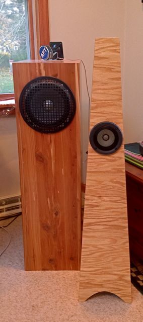

Had to build another pair for the Fostex FE103en drivers I bought early this year. I had tried them out in the Mets I built for the FE108eS and liked the sound. So here is the latest pair, adjusted slightly from the original formula used for the FE108eS, and with a different BSC as well.
L= 40"
Z(d)= 14"
S(0)= 1"x2.5"
S(l)= 4.5"x8"
port diameter= 2.2"
port L= 3.5"
BSC: 3 ohm Mills resistor & 0.6 mH inductor
Baffle is 3/4" ply that came with oak veneer (scraps from another project)
sides & back are 1/2" Baltic Birch ply (which I veneered with red oak, but with normal grain orientation)
Binding posts are artfully concealed on bottom by the port.
Photo below shows one of them next to my Pappa's TL (not that you wouldn't recognize the Met!)
They sound slightly different from the FE108eS, but rather similar. If you find the FE108eS a bit too peaky, then you might prefer the FE103en, which I find smoother. As always: YMMV.
Cheers, Jim

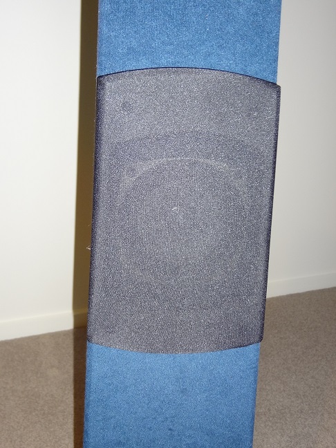

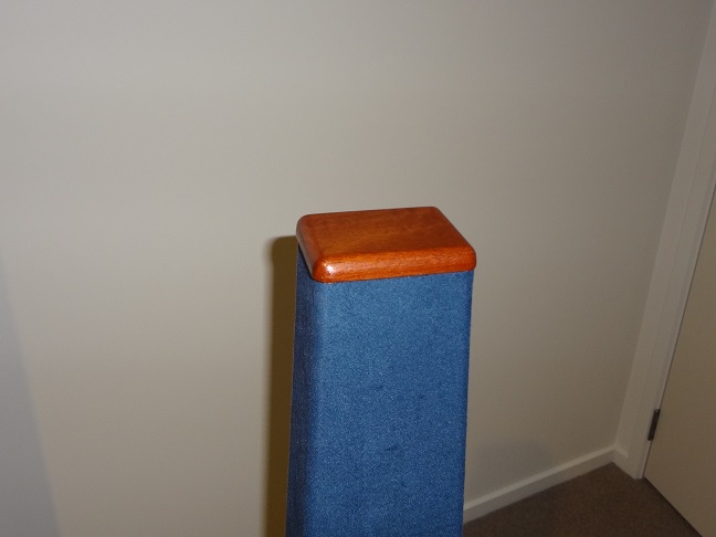

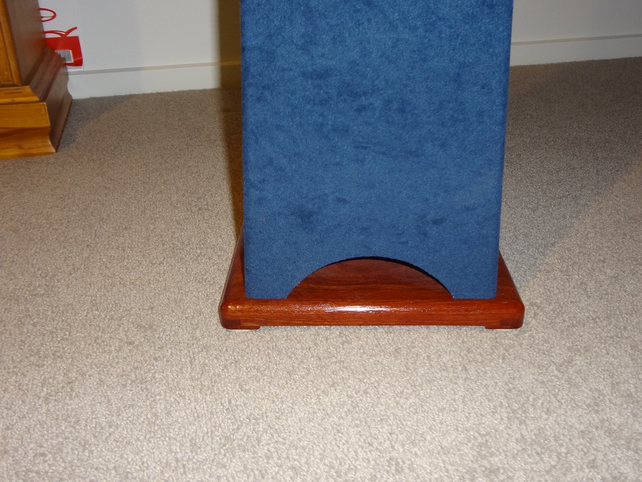

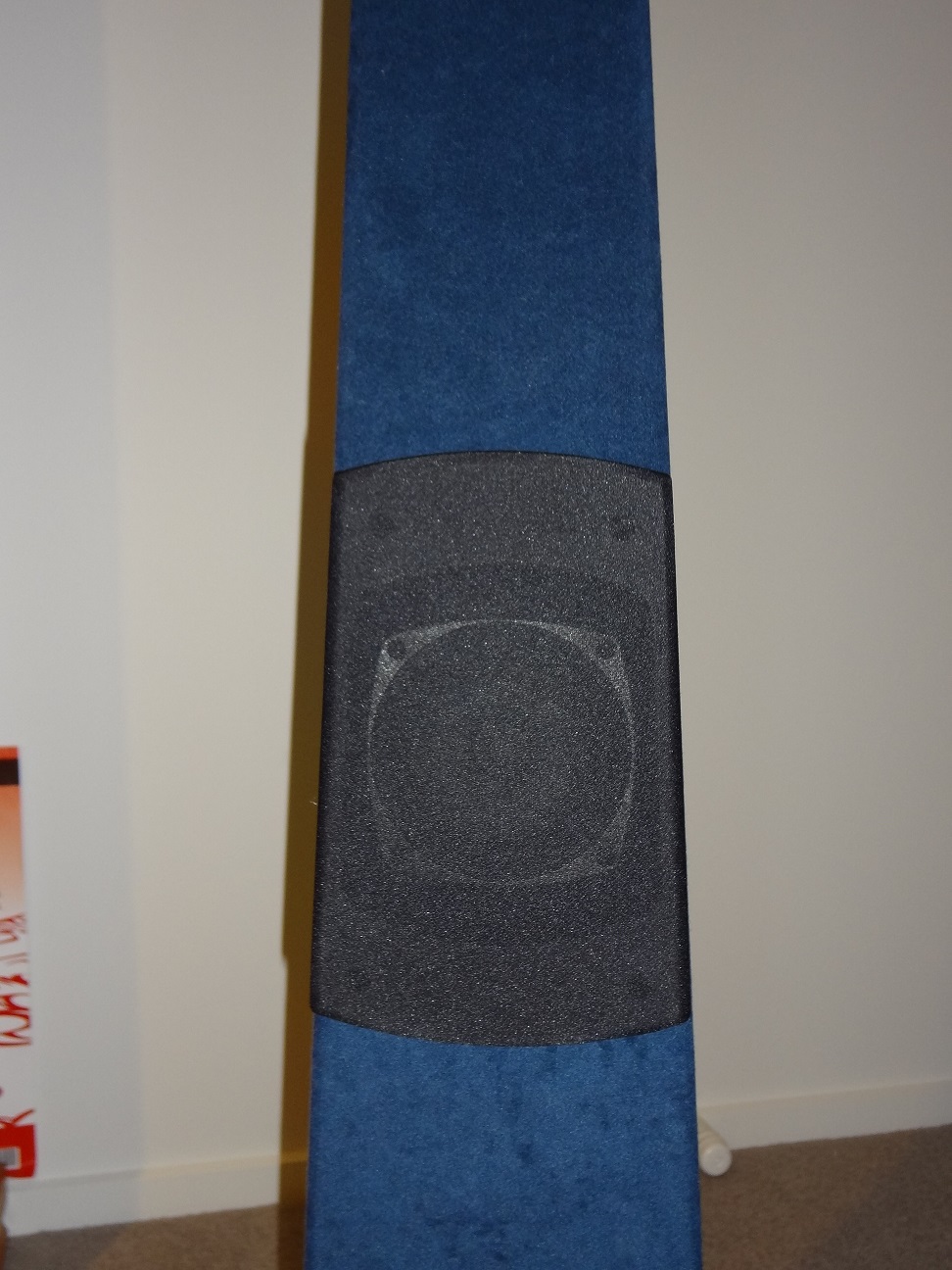

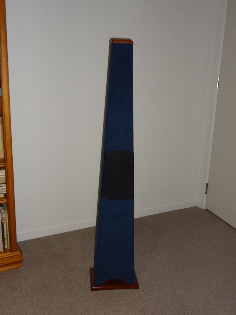

Interestingly, AmadeusMozart built a Met for the FF125WK and FF105WK. It seemed he may have slightly preferred the FF105WK but it was probably a close call. Look back at around 101.
I still prefer the FF105WK for sound and size. Top and bottom attached to enclosure and covered with upholstery cloth (slow drying water based contact glue)
The main differences between the 125 and 105 are that the 125 has a more noticeable peak and goes slightly lower (but hardly noticeable) in frequency. SPL wise they are much of the same since the 105 has a larger xMax than the 125. Prefer the mids on the 105. Should try out the FX120 in the 125 but recently have become locally hard to find. (plus more expensive)
I no longer have good use of my right hand - if I had I would try out a metronome with the FF165WK in it.

The Fostex grills do fit the FF125WK except the little paper ring in the front has to be carefully removed to make it sit flush. One the 1FF05WK I made some grills.
