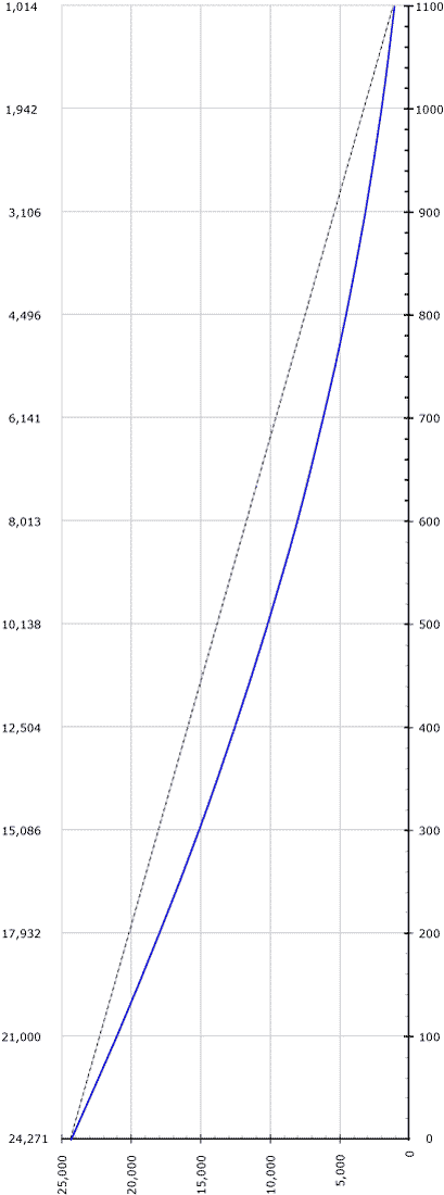

I have not built on of these, but I did do the modeling exercise. I went to the effort to figure the cross section as a true quadratic expansion and used the sections worksheet. While there were minor difference between the between the quadratic and conic expansions, I don't think it is worth the effort. Modeling a metronome as a TQWT is closs enough.
Bob
Bob
How is the Metronome not a conical expansion? Unless the aspect ratio of the rectangular cross section changes from the start to the endpoint, it is conical, AFAIK.
A linear expansion as is typically used in TQWT does differ from conical. By this I mean a wedge shape, as opposed to a cone shape.
It's funny and not intuitive at all, but it is conical if two walls are parallel so that expansion is only in 1-dimension. When both sets of walls expand and are non-parallel, it mathematically is a parabolic expansion - that is, the cross sectional area is proportional to a*x^2 where x is axial distance.
Yeah, I understand that perfectly. I guess the confusion is in the terminology. I'm calling the first case 'linear', and the second case 'conical'.
I've always understood conical to mean conic section, as in part of a cone.
In the second case, if both walls are expanding, the cross sectional area is going to be the same as a pure conical section even if the cross section is square or rectangular, as long as the proportions of the rectangle do not change.
BTW, I've put the same drivers in equivalent ML-TL, 'classic' TQWT, and quadratic/conical TQWT, and they definitely sounded different. The ML-TL measured best. The conical TQWT sounded best, and better than the classic TQWT. However, the linear TQWT was folded, so it's not a fair comparison. This was just in the process of prototyping. It'd be interesting to do a more controlled test.
I think it may depend on the type of music you listen to that matters. The quadratic/conical may have more harmonics which when playing jazz brass and woodwinds sounds good to my ears. Cello and double bass also sound better than linear expansion or straight expansion. I have also done same driver but different boxes.
