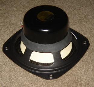

Pulled the driver's out last night to do the precoat to enabel. One coat last night and the other tonight. Enable will come at a later date when I get my nerve up to do them. I went ahead and glued the braces like Dave recommended for the driver brace too.
The other thing on the list was to do some basket mods. It isn't as dramatic as what Dave is doing here http://www.diyaudio.com/forums/showthread.php?postid=1649080#post1649080 but can tell this is going to help by the differance between the ping of the finished and not finished driver when tapping on them. See pic below.
I installed the phase plugs last week. The best way I can described it is they are doing better in the upper mid's and high's like the fe127e's did so well in my fonken floorstander.
BR

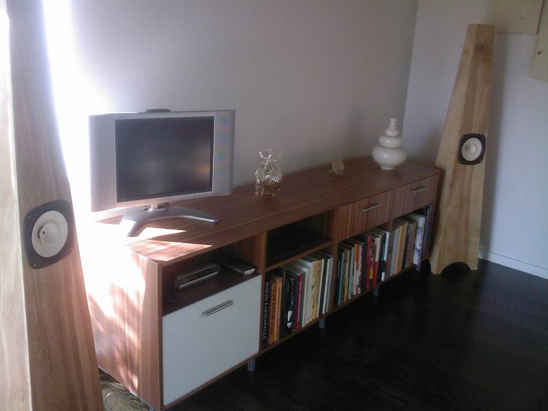

I decided a few weeks ago to build a pair of metronomes. Thanks to Dave at Planet 6 who provided the awesome drivers.
This is my 5th pair of speakers, and my second set of full-range speakers. The first set of full-range speakers were the zigmahornets, and honestly I was disappointed with them. I was seriously considering not doing another full-range project. It isn't that they sounded bad, it's just that I went into a full-range project thinking to myself that there'd be holes in the frequency range that I could hear that I wouldn't be able to get over. And guess what? There were holes.
Anyway, I talked with Dave a lot (I'm sure to the point of irritating him more than once) talking about the metronomes and the drawings of the plans. I decided I'd give full-range speakers one more try, and ordered the 127's from Dave.
I found these not-too-hard to make. When I started woodworking, it was in the living room of my apartment with a circular saw and a drill. It was funny to open the door to my deck so the sawdust could fly out into the outdoor common area. Anyway, I think this is an advanced-beginner project, because you could do the whole thing with hand tools if you wanted. Actually, some of it is done better with hand tools, especially the cutting of the shape of the front, back, and sides.

I started construction of these before the drivers arrived. Here's a flickr photoset of step-by-step construction. I've assembled them on three sides, with a side incomplete so I can play with baffling if I want.
I found a few tricky things along the way - the plans didn't exactly match the table that Dave provided of what size the enclosures should be at the bottom and the top. I followed the table instead of the plans.
I found the top took a little thought because it is also at an angle, but I decided to make a joint at the top that you can see in the photos and that made it a bit easier.
I also put a piece of tile underneath the speakers since my room is carpetted.

Listening impressions:
These have more base than they have any reasonable right to produce. There's really no comparison between these and the zigmahornets. Maybe I did something wrong on the zigmas? Because the metronomes just put them to shame.
They can handle higher volumes than they have any reasonable right to handle. I'm keep expecting them to get sloppy in the base as I turn up the volume, and I'm just stunned that they aren't.
They seem a bit bright on some songs, so I'm going to play with a little baffling, but really, this feels like seasoning to taste. At the very bottom of the base, the drop off is quite fast. Honestly, I started pushing the extremes, so when I got out the Bach Organ Music, I was going to be surprised if they were able to deal with it. That wasn't a fair test, but I hadn't found the limits until I pulled it out.
Also, I haven't put in the brace yet, and I'm sure the clamps on the enclosure don't help the sound any, so I'm optimistic that it gets better from here.
If you can't tell, I'm really pleased. I would be hard pressed to find a better speaker that could be built for $300.
