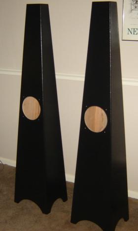

I used some 1/8 material I had laying around to determine these measurement to cut out the panels. The 1/8 pattern later came in handy for cutting dampening material and figuring layout for the brace for the driver.
As others have stated a table saw is useless for this enclosures except for cutting the endcaps out. The tool I found most valuable was my router.
I would recommend cutting one of each panel exactly then use it to build the others. I layed my pattern on the boards to cut then scribed out then cut them outside of the lines(recommend drawing one side of pattern then flip patten to draw the other to make sure both were the same angle, hope that make sense). I then used a straight edge as a quide for the flush trim bit in my router to get a strait 90 degree cut.
Make sure you draw a centerline down the long length of the board before cutting out the arch on the bottoms. I used a scrap piece of wood and cut a 12 1/2 and 8 inch hole in it for a pattern for the arches. Again draw a centerline before cutting the holes out. Mark your side panel at 3 1/8 from the bottom then line up the centerlines of the circle pattern to this mark and draw out the arch. The centerlines should keep your arches square. Cut excess outside of the line with a jigsaw then clamp pattern down and use flush trim bit to cut to your line.
The first pic is oversized by 1/4 inch. Reason being is I used a 3/4 straight cut bit in the router with a staight edge guide on the router to prep the front and back panels for glueing (see second pic top left panel) Staightedge was adjusted to 7/8 inch and the depth of the cut was 1/8 inch. This made glue up a breeze. You will later need to fush trim th 1/8 excess after your panel have been glued up.
I used all 4 sides to glue the panels together but did not glue the back. Note that all sides of the side panels were cut at 90 degrees. The bottom I didn't worry about, see third pic (bad batteries) for how the top was done. I used a clamp to hold the back panel to the three sides that were glued and place the enclosure on a level surface. Note in pic that two boards with straight edges were clamped above the top cap and leveled. I used this with the router and straight bit with the depth set to a 64 3/8 height mark scribed to one of the side panels.
Last pic show everything glued except the rear panel. I elected to use the bottom for an access point in the future. This also made installing the port and banana plugs easier. A table saw was used for cutting out the caps. 1 degree and 4 degree cuts prove to be close enough. Note that having a centerline on the baffle before glueing and cutting the arches helped in positioning the driver brace. Also note that the top bottom caps and the driver brace are short 1/8 inch to allow the rear panel to be glued in.
This isn't everything to the build but should provide some tips that helped me along the way 😀.
I played with the dampening before glueing the rear panel and hope to have the drivers installed this evening. Working today and tomorrow along with Sunday and Monday night football will delay listening until Tuesday evening. Hope to have some listening impressions before going out of town next weekend starting Thursday. The drivers have close to 200 hrs on them already. Also looking forward to getting some phase plugs, thanks Dave.
Brad

ecir38 said:Note that having a centerline on the baffle before glueing and cutting the arches helped in positioning the driver brace.
Itr looks like you put the holey brace dead centre... for future reference it is best put just off-centre (ie one edge of the brace on the centre line is how we usually line it up)
dave

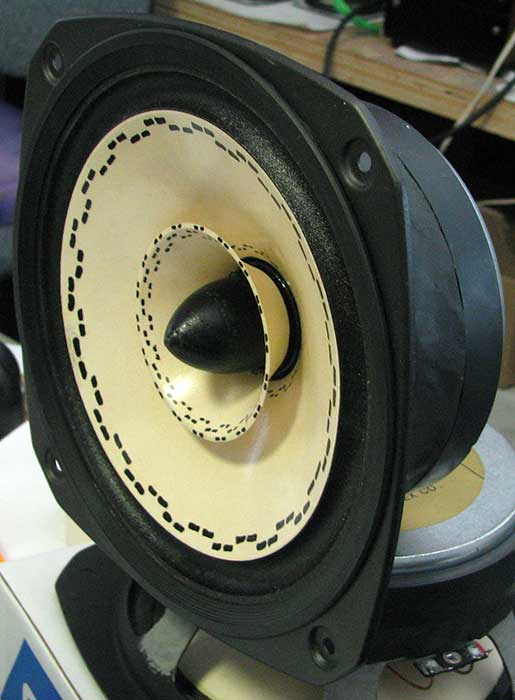

Dave, have you ever tried the war paint on the FE207E. I did it to my FE127e's with good results and was just wondering. Would the 9mm and 17mm marks apply to this driver too?
BR
BR
ecir38 said:have you ever tried the war paint on the FE207E. I did it to my FE127e's with good results and was just wondering. Would the 9mm and 17mm marks apply to this driver too?
The trifoil pattern only applies to the FE126/127 cone.

Similar treatment to FE206 elicited this response from a client
FE20eN) Dave, make no mistake. This 206En is killer. You can take my opinion for what it's worth, but your driver doesn't just compare to the ESR, it smokes it!
Jeff C
so you can look forward to milking much more preformance out of your 207 than just what the phase plugs will do.

(picture is a 206 i couldn't quickly find a 207 pic) BTW the 1st pair of FE207eN are Marc Englands, he has made some comments on the Curvy Change thread

Hope I didn't mess too much up by having the brace centered, should have known better 😡 since I built the Fonken floorstander that way. This comment has me a little worried now.

Would you by chance have the pattern for the 206 / 207 handy? If not that pic should work.
You can band aid it by fitting a small piece next to the holey brace on one side only (say 18mm x 2"). The dimensions at this point are not that large and are a trapezoid so issues will not be as significant as with a rectangular box.
Here is my pattern secret... i take a generic pattern, scale it every which way, print them all out and then use the one that fits. A3 on the outer edge, A5 on the whizzer edge, 56 for the voice coil & phase plug, and A3 or A4 (on edge) for under the whizzer (use the spots on the whizzer as a template). Under the whizzer is a real pain and don't expect to be super tidy, have lots of q-tips handy, but a 207 is a lot easier than a 167.
dave
Should this piece extend to the rear panel? I do have a minute gap between the driver and brace where I used some blue tac if that helps.planet10 said:

ecir38 said:Should this piece extend to the rear panel? I do have a minute gap between the driver and brace where I used some blue tac if that helps.
No time to draw a pic, but it is a piece that goes edge on to the baffle/cab rear and moves the apparent middle of the holey brace off to one side (ie makes the unsupported panel on one side the thinkness of the new piece smaller) They would run vertically the height of the hoely brace (front one would be 2 pieces (no need to obscure the driver anymore)
dave
