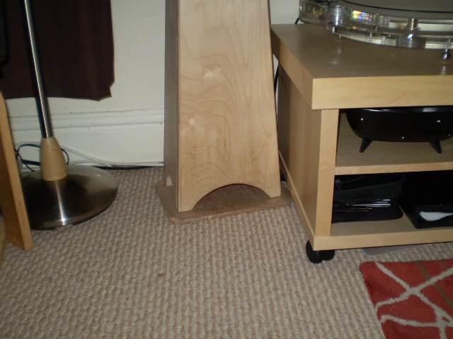

Interesting news about the subwoofer Steve, my FE127 Metronomes are in the corners of a smallish wood floored room and they produce loads of bass, absolutely no need for a sub. My build did used separate feet screwed into the main panels instead of the "Eiffel Tower" design - maybe this frees up a bit more space for the bass to escape.
You're probably also affecting the damping applied to the vent. Something well worth exploring anyway.
I will say that one of the more startling things I've heard was the difference between a port length of 2x3 inches (as bought, not much bass) and 2x1.75 inches (lots of bass) that they are supposed to be...
gychang said:
any chance for the picture? gychang
It's not much of a picture as it only shows the base with the board but that's the important bit.

Well I don't know how low they go but I have been able to give up the sub with very little loss of extension. LF power? Yes I have lost some of that but the 108EZ Metros seem very extended at the low end with the baseplate attached.
Of course they are not giving the chest thumping wallop that the sub gave but OTOH they sound well very balanced and dynamic with no evidence that I can hear of any peakiness or lumpiness in the bass response.

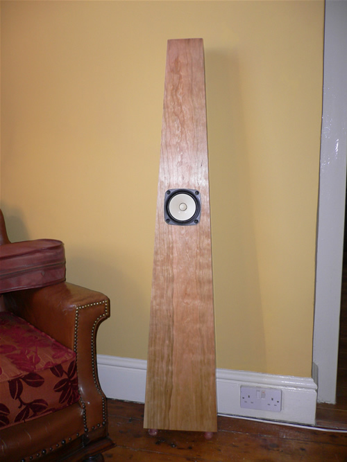

Metronome is a stealth box WAF-wise thou... it would be taller than the existing box (assuming we can find a metronome that works with it0, but even at its widest and deepest unlikely to come anywhere near the dimensions of the old box. And as a truncated pyramid, looks smaller, and more importantly is not a rectangle. Mount a clock face above the driver and tell her it is a matching pair od grandfather clocks 🙂
dave
Yeah, they are actually pleasing to the eye with their shape. They also don't look visually big because of the taper. My cardboard ones are the same height as my big 2-ways but they don't look nearly as big. It sounds like you'll have much larger ones, but still they have a way of blending in.

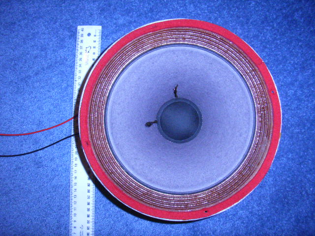

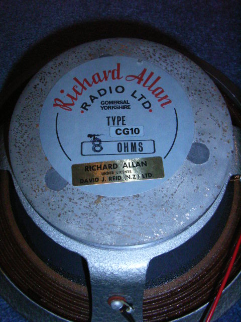

Drivers
Are a couple of pics of the drivers.
The dimensions
260mm Diameter.
89mm deep
The edge of these are very narrow, so i was woundering if it were possible to add some type of plate to the front. The speaker could be attached to this, then the plate screwe into the speaker. As it does not look like I can mount the speaker from the front, otherwise.

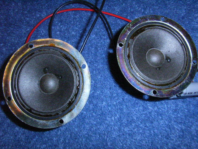

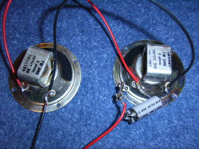

How big are those tweeters? Hard to tell from the front but you may have a nice set of thimble tweeters there.
dave
dave
tweeters
Dave,
The tweeters are about 80mm across, the cones are about 57mm in diameter.
There are/were two per unit, rated at 3w ea. in series. They have two caps parallel; 3.3mf.
Is there some sort of coating I can spray onto the cones of the RA's to stiff'n up the paper cone and/or preserve the paper?
Edit; just found some comments you made about plastecoat?(spelling).
I might try the PVA, but watered down, so it's thinner.

I used the following on an old set of 10" paper coat woofers (unknown origin). It worked great. Cones are much stiffer and the driver sounds improved - tighter bass.
I put one good coat on.
http://www.rustoleum.com/CBGProduct.asp?pid=70
It's waterbased, dries quick and is safe for paper.
