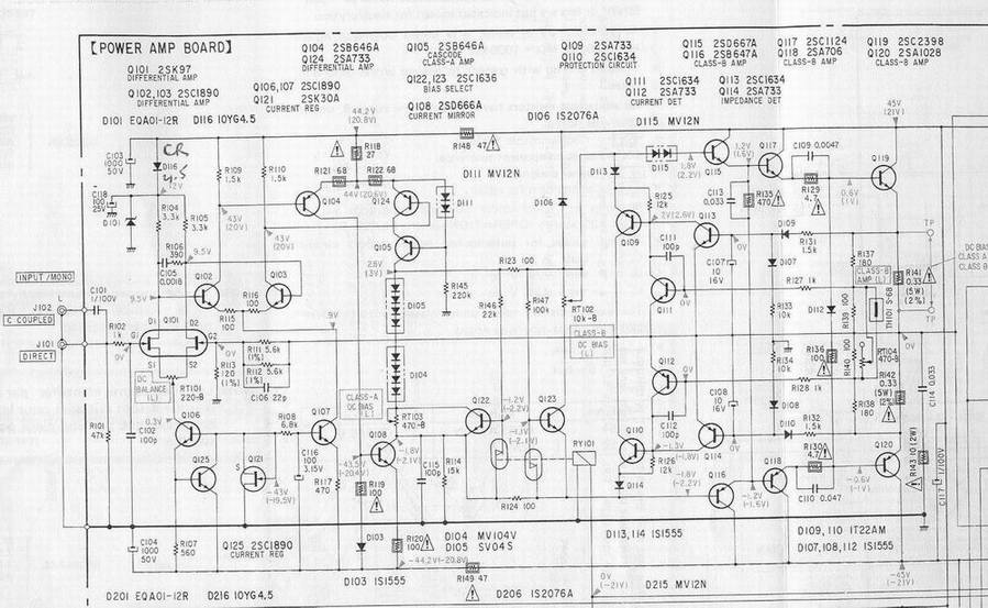

janneman said:I have received some info from Mr Hiraga about his test results, as we discussed before.
Interestingly, figure 3-2 in the article was produced by a rather traditional high-feedback design, the venerable Sony TA-N86 (of which I have two, hah!).
Thanks for finding out this info Jan.
janneman said:
...What is also interesting in the Sony is that it has a switching power supply, so there would not be any 50/100 Hz interaction of the power supply with the impressed 50 Hz test signal. Thoughts?
Jan Didden

For getting graph2, I think these 2 approach is right. But I think they won't sound the same. While the graph (with limited accuracy of the meter) looks the same, I suspect the high-feedback will contain more high order artifacts (which is not pleasant) than the low feedback approach.They seem to match quite nicely with your observation that the good performers probably are either high feedback or very low feedback, but not the in-betweens.
I don't know this amp. Anyone has schematic or topology that this Sony amp uses?the venerable Sony TA-N86

lumanauw said:[snip]I don't know this amp. Anyone has schematic or topology that this Sony amp uses?

...I still believe that the amplifier load needs to be reactive (as per a crossover/dynamic loudspeaker equivalent) such that the amplifier is attempting to drive phase shifted load current related to input. It is the amplified 'input' that becomes distorted, and high NFB designs are less likely to show back-EMF induced weakness when the load remains predominantly resistive...
Cheers .......... Graham.
No, the resistive load for the test is OK. The idea is precisely to segregate under controled conditions what is nominal load and what is back EMF. With a resistive load and back injected external signal. you have precise control on what you are hammering back. If this back injection were contaminated with extra EMF sources (reactive, speaker), results should not be consistent or meaningful.
Rodolfo
