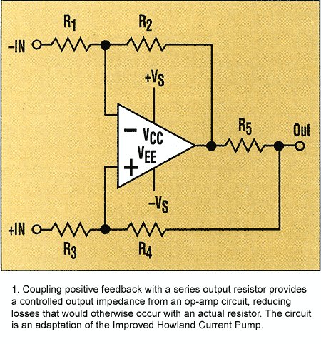

Excuse me, sirs, I would like to contradict. There are many ways to Rome. While it is true, that a HIGH CURRENT CAPABLE, low Zout voltage amplifier would give a good result here, [How many amps will flow in the, say, 20 mOhm output inpedance?], in the real world I would not be surprised if such a high feedback amp eventually would loose the fight half way up, and, while running out of current, would produce something like the fig. 3-3; fig 3- 4.
In the meantime, in my opinion, the fig 3 - 2. results could easily be reproduced by a Howland current pump, shown by the figure below, and proposed many times on this forum by Mauro, who includes it in his designs. Also the ESP project 56 would fit, although the actual measurement setup should be changed for testing it. But in the real life, with a real speaker it would behave exactly the same, if configured
to a high enough output impedance. A tube amp, while having a high output impedance, it is NOT a controlled impedance, and also comes with a high THD figure, this is how fig. 3 - 5 is generated.

Hi George,
Reading your above comments, I assume you agree that in any case good results depend on high feedback. A Howland current pump, having high output impedance, will absolutely produce something like fig 3-2, because the high output impedance results from strong feedback. A tube amp, which, as you say has also high output Z, will NOT nearly faire as well, precisely because the high Zout does NOT result from strong feedback! So, I guess we are all singing from the same sheet of music after all.

In the meantime may I point out, [about YOUR own circuit.. so you surely know it better than me] that this Howland Current Pump does exactly this - applies a tricky feedback topology, which process the input signals present between -IN and +IN differentially, and rejects
the external signal forced upon its output, because it will show up accross the feedback networks, like common mode!
[because R5 is chosen to be small in practice, and the open loop output Z is not small]
The byproduct of this type of functionality is the high output impedance, low damping factor.

Yes, we absolutely agree about the importance of the high feedback here! Then, obviously, it was only a guess from my side about Hiraga's original intentions..
But, I would like to note, that not only the figure 3- 2 diagram can be reproduced by a high output Z device, but also it CAN NOT BE reproduced by a low output Z device [ we would see only 1kHz]!
For me it's quite a proof that he used some kind of current generator.
