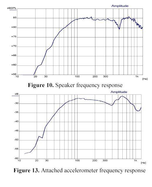

Re: Detrhoning back EMF
Very educative thread.
ingrast said:
....If we accept voice coil velocity equals sound pressure....
Voice coil acceleration equals sound pressure.
Part of the article about MFB:
"A comparison of the speaker's frequency response measurements, (fig.10) obtained by using a measurement microphone and the accelerometer (fig.13), gives compatible results (within 1dB deviation) in the frequency range of interest (20 to 300Hz). Therefore, it may be safely concluded that the accelerometer is directly applicable as a sensing element, in which case no additional correction circuits will be required. In addition, as Novak [7] points out, for a speaker with a diameter less than one-third of its maximum operation frequency, its far-field sound presure level will be proportional to the cone acceleration."
Milan
