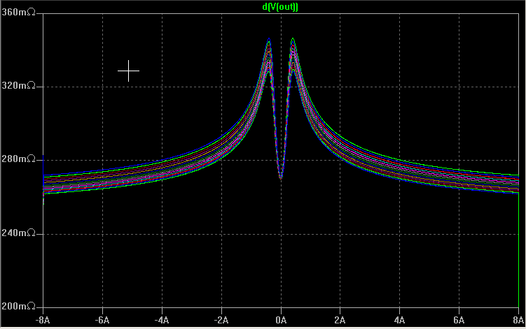

ingrast said:PS. About the sims. There is something worring me, in that the simulation conditions are for 0 output voltage. This should not matter if device behavior were irrelevant of output voltage, but for second order effects as we are interested, I'm, afraid it is not the case.
I did discuss this in my original post. My original text read:
In reality, this could be a multi-dimensional nonlinearity - that is, the output impedance could be a function of both output current and voltage, but I'll neglect that for now.
Here's a plot with the output voltage also stepped from -30V to +30V in 5V steps.

Then I applied a 1V voltage generator + 5 ohms resistor as a back EMF generator.
Detrhoning back EMF
