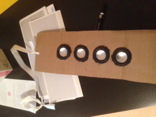

I bought four of these to try. I put them on a cardboard sheet, hung them in the corner and made some measurements. I cannot really say how they sounded. They sound fine. It's not fair to judge how four of these unequalized would sound compared to 75 of these equalized to perfection.

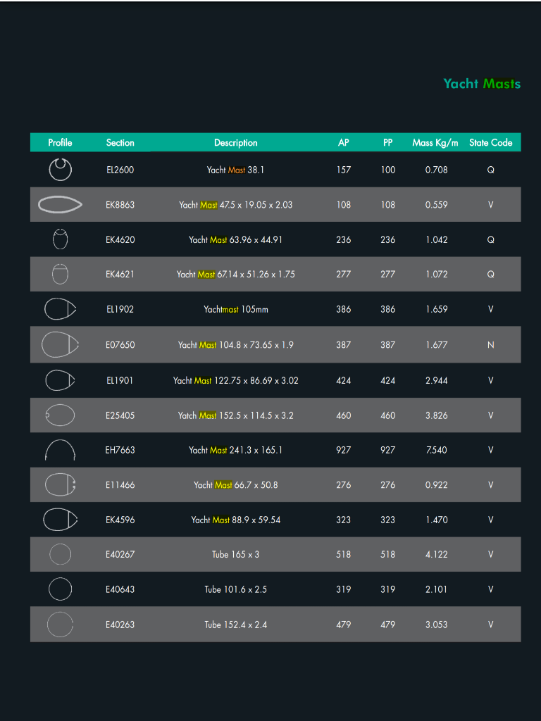

I found this catalogue while looking for an easier and possible cheaper way to build your beasts wesayso....
Alluminium boat masts!
These particular profiles would need some machining to create a viable driver baffle but the potential is there. Strong, long and would be sexy when finished properly.
See Page 41.
http://www.capral.com.au/Aluminium-Extrusion-Catalogue-PDF-View
This is just the first link I found, there must be thousands of different profiles built over the years...
Now looking through the secondhand market for a semi damaged unit, possible for free... ;P
Any input gents?
Four won't be telling you much.

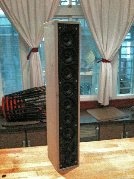

I built a 9-driver array prior to my 16-driver arrays.
Even with 9 drivers, the sweet spot was tiny. The moment I turned my head, it was gone. And the presence was nothing like I had with 16 drivers.
There's just nothing like a long row of drivers. You HAVE to be on-site and experience it, no amount of reading about comb filtering and correction will tell you anything of the feeling you get when you physically listen to a nice pair of arrays.

I see they even have an open baffle version 🙂.
The sizes seem a bit small to me, I build quite a solid mast in comparison 😉.
The biggest one still seemed small to me. I did see a fun oval shape in there, only 50 deep x 300 wide (page 73). A bit like a mini Genesis Dragon 🙂:
