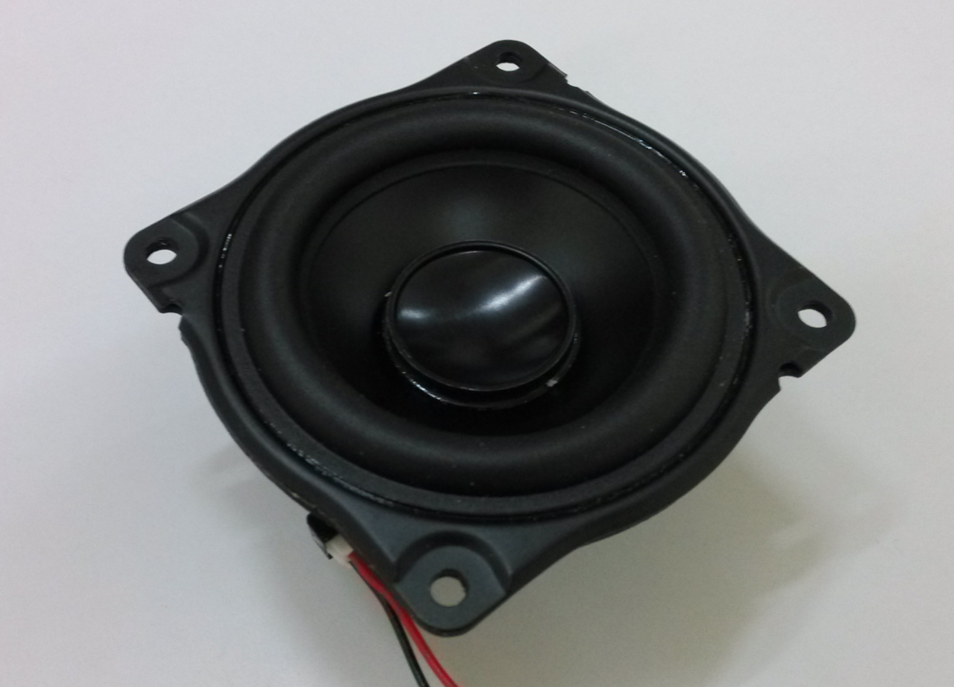

I'm still waiting on some info from the Aura guy... mainly if I can get a discount for buying 56 drivers at the same time! (a few extra ones, just in case) 🙂

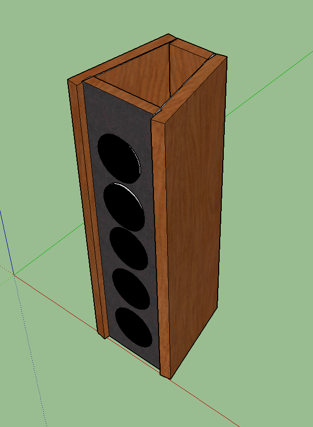

As for design... well, nothing exciting came to mind yet, so if nothing better comes out, this is a possible option, being a crude sketchup, and not showing the dividers between drivers:
Ouch... personally I would not use protruding sides. Unless it had a function!
I know not many may agree but I do think diffraction is to be avoided as much as possible. Remember my cross section?
I know many wouldn't agree, but I do think every little bit helps.

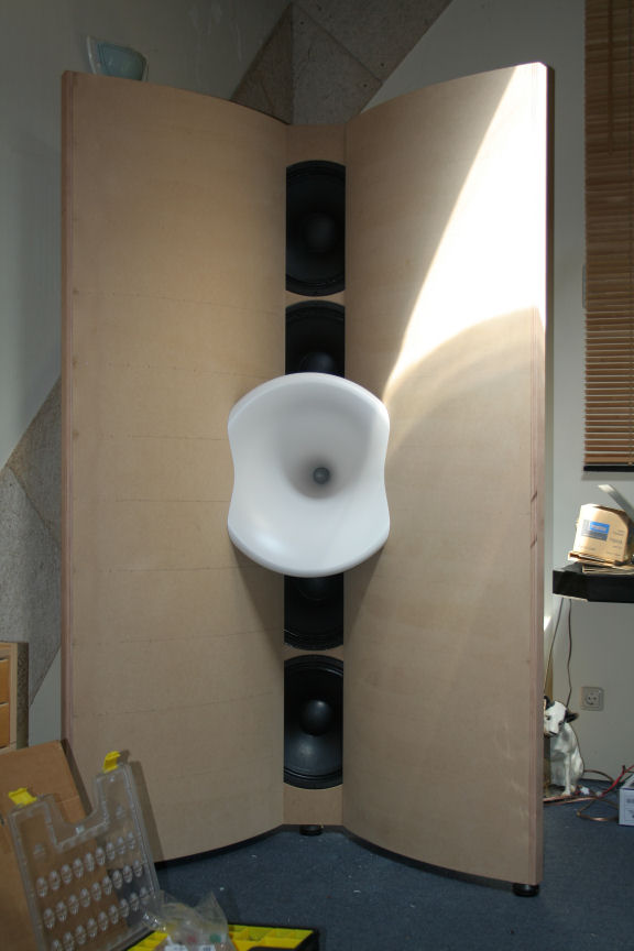

So if I were to have protruding sides I'd use them differently. Sort of like this:
attachment.php
Without the horn in the middle but I think you get the picture 🙂.
(I'd also use larger round-overs than pictured here at the mouth, a la JMLC)
I do realise not all will look at it like I do and in the end you need to do what suits you. But I wouldn't be me without telling you what I think. In the end it's up to you what you want to do with my views. Kind of like the earlier discussion of weight in an enclosure.
I can't tell you what works and what not without trying it first. But I do have my own "mental picture" of how these things could work. I displayed my craziness/lunacy for all to see so what do I know 😀. I bet there won't be many as crazy as I am to use the type of construction I did. But I do not regret it one minute.
Pay me enough and I'd do it again. 😉

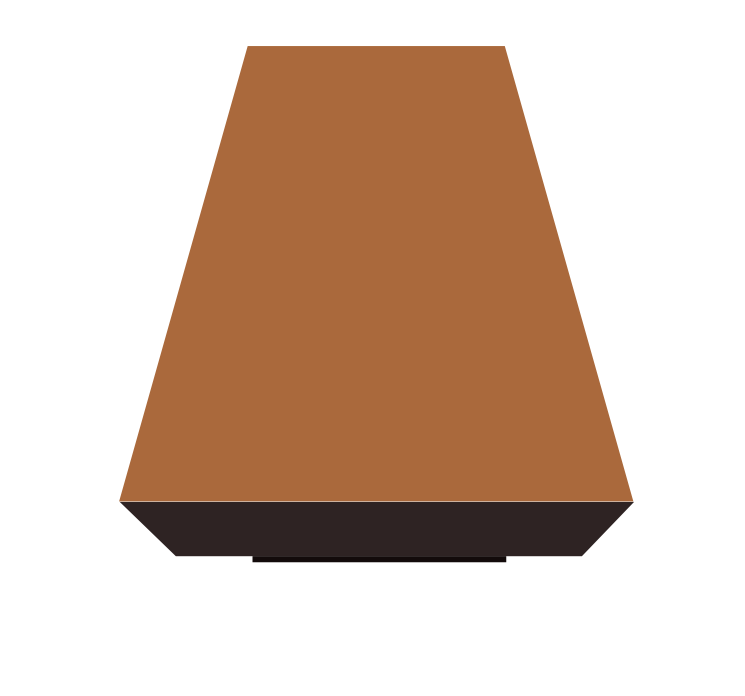

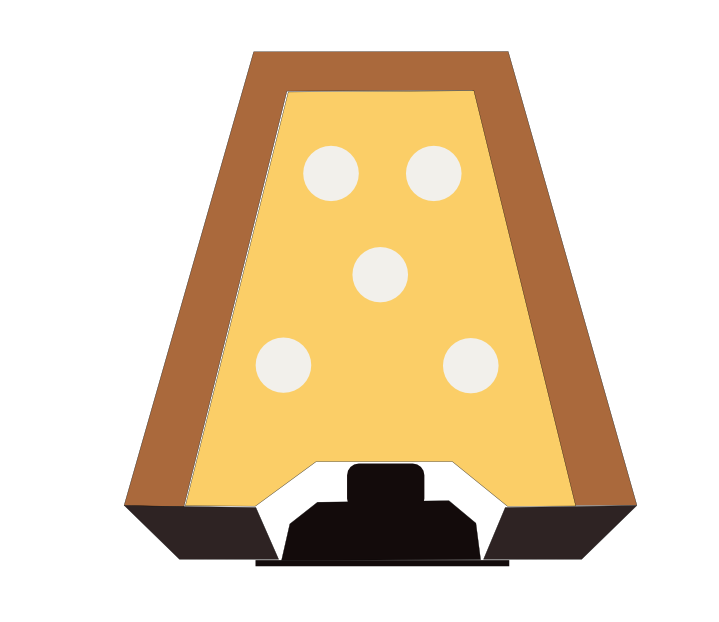

Ok, how's this?
Since the driver's basket is very thin, and it already has a gasket under the mounting ring, I would mount the drivers on top of the baffle.
I already foresee a lot of fun (sarcastic) trying to bevel the sides to match the straight baffle... no, I don't have a table saw...

Better! I'd even use a thin (as thick as the mounting flange) beauty panel on the front to make the drivers sit flush with the baffle.

Do you have a router? I've used a router to get that type of angle right. Mount the router up side down in a table, use a guiding ruler fixed on the material to cut with a router bit that has a roller bearing following the ruler, make some temp guides on the table at the angle you want and you'd get perfect side cuts. I don't have a table saw either. But I use what I've got.
A visual:
It's a lot easier to get the guides right, more room for error correction 🙂 and the ruler can be anything, as long as it's straight.
I do have a router, I'll try to ghetto rig something.
Having a beauty baffle will be very hard. Do you remember the Aura? the bezel has curves! That would be a heck of a job trying to fit a beauty baffle over 25 of those curved bezels!
