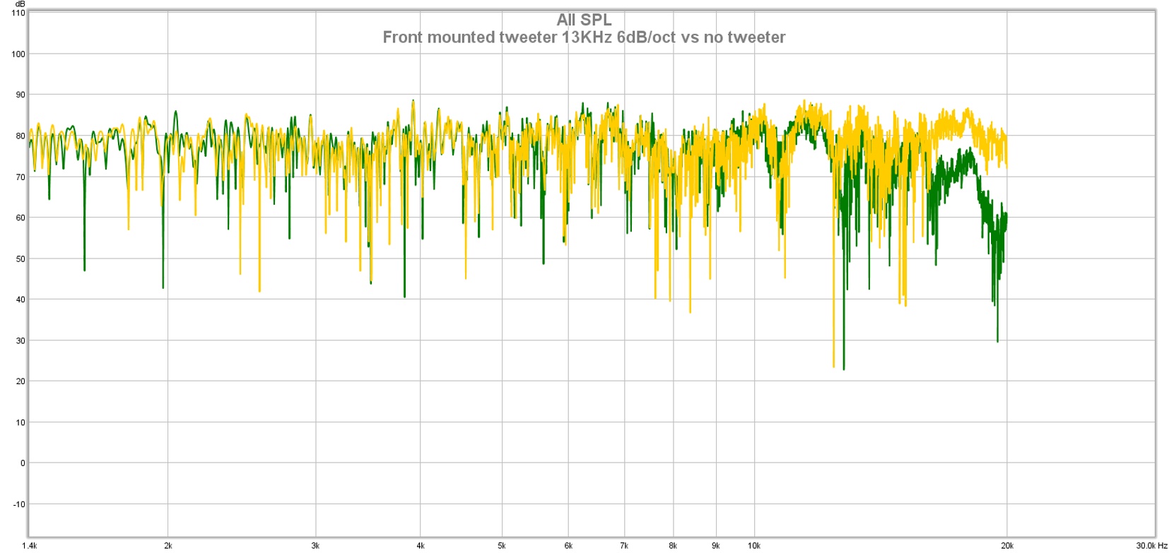

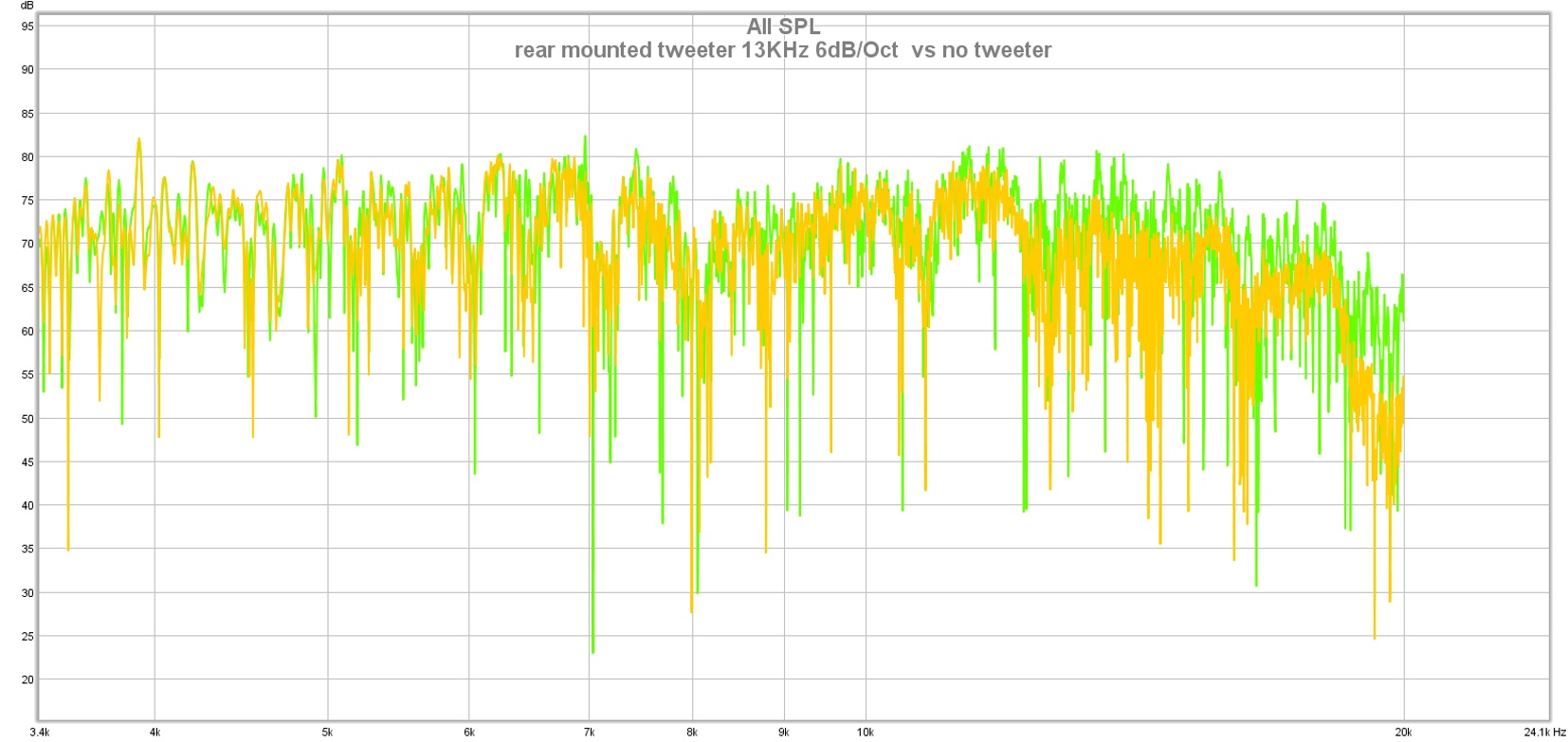

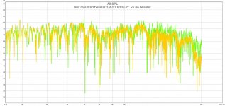

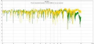

Extra Tweeter
I have been playing with a 1" silk dome tweeter added to my arrays for a while now. All I can say is: its worth trying. As for myself, I won't be looking back.
I compared both front and rear mounting of the tweeters using 1st, 2nd, 3rd and 4th order active crossovers. Front mounting does not work well with the stealthy signature of the arrays. Something was off. Rear mounting with 3rd and 4th order crossover at 13KHz sounded artificial. 9KHz filter was a little better. Worst was a 60 dB/Oct filter at 13KHz.
Unexpectedly, what I loved most was a 2nd /1st order filter at 13KHz, rear mounted tweeter. The addition of the tweeter is quite distinct. I was indeed missing quite the sparkle! Its like my treble got upgraded to high definition.
I cannot continue using an active crossover for the tweeters, so I am using a 1st order 13KHz simple capacitor crossover filter for now. Working great so far! I plan to upgrade to 2 rear mounted tweeters in series per channel with 12dB/oct passive crossover at 13KHz.
I was under the impression that using a tweeter front mounted with a 1st or 2nd order non-steep filter would put serious holes in the arrays frequency response. My test results have proved me somewhat wrong. There isn't much difference between the array's frequency response without tweeter and with tweeter on a 1st order crossover at 13KHz, other than the added response around and above the crossover point, starting from 11KHz in this case. Please see attached graphs. Anyways, front mounting did not work for me.
I also tried front and rear mounting with 7.5ms delay (its all I can afford with my miniDSP). There was no advantage whatsoever. It just messed up my early decay time. Maybe around 20ms delay is what I needed.

Nice result Rockk19, thanks for sharing. What tweeter do you use, how many, and what size cap for the passive HPF XO?
Based on the measurements of the two black cone TG9FD (TPY03W06's) you gave me, I have no doubt your arrays sound amazing. Those are fantastic drivers! Price has no relationship to good sound as these were $6 drivers!

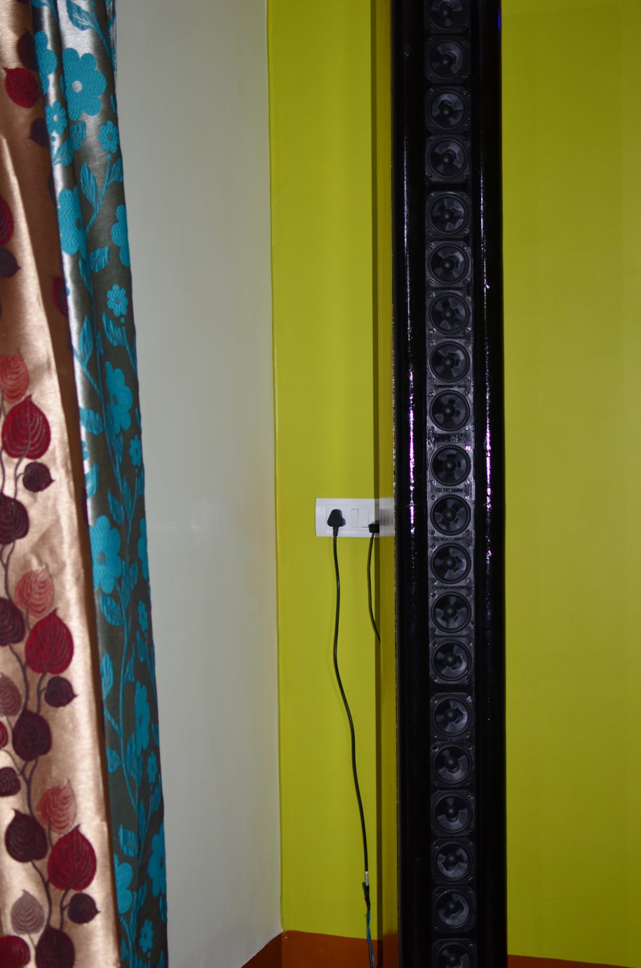

My arrays are placed at 50cm distance from the side wall and at 45cm distance from the front wall. The side wall distance is less than optimal according to me, wish I could move the walls

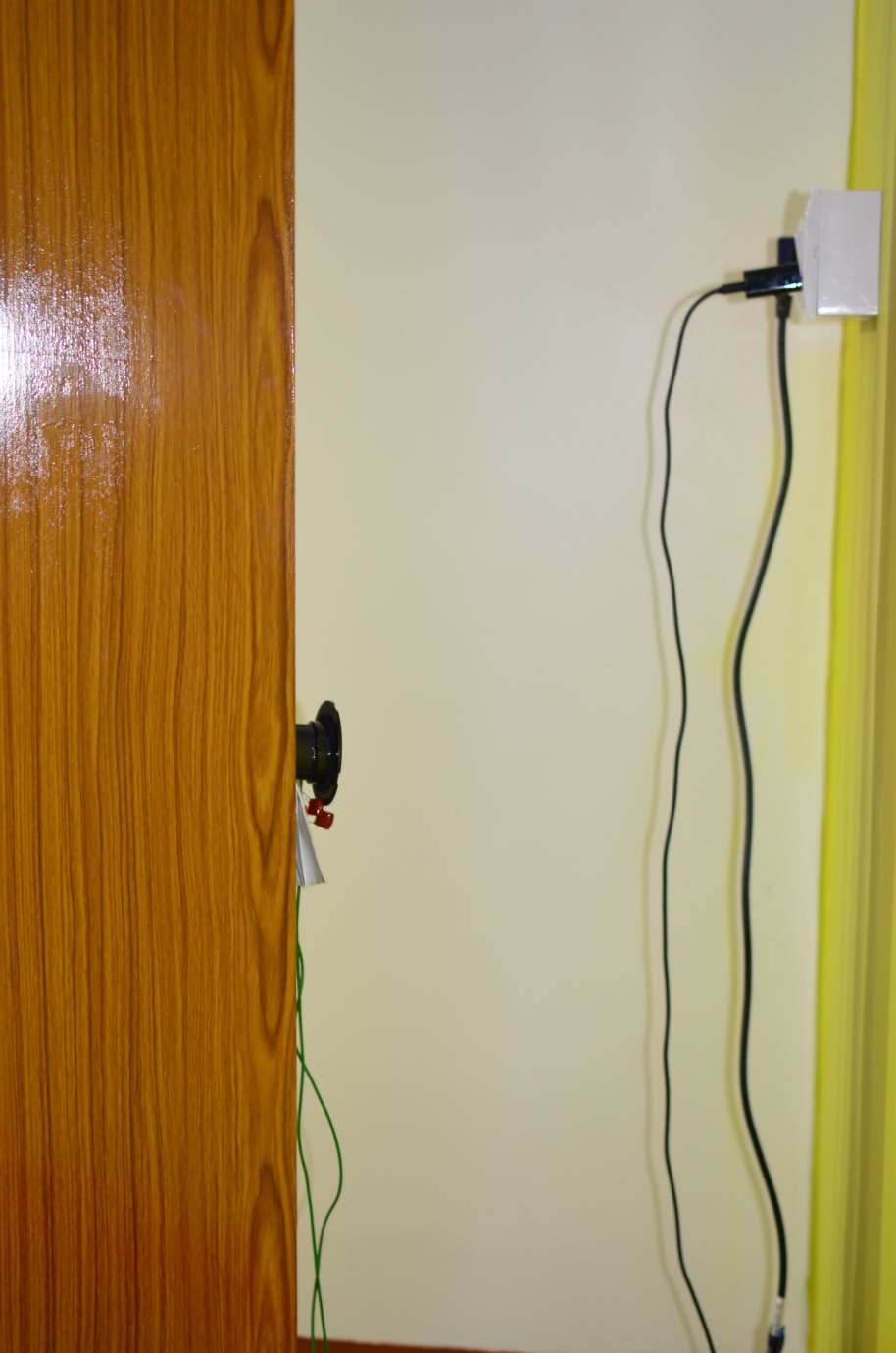

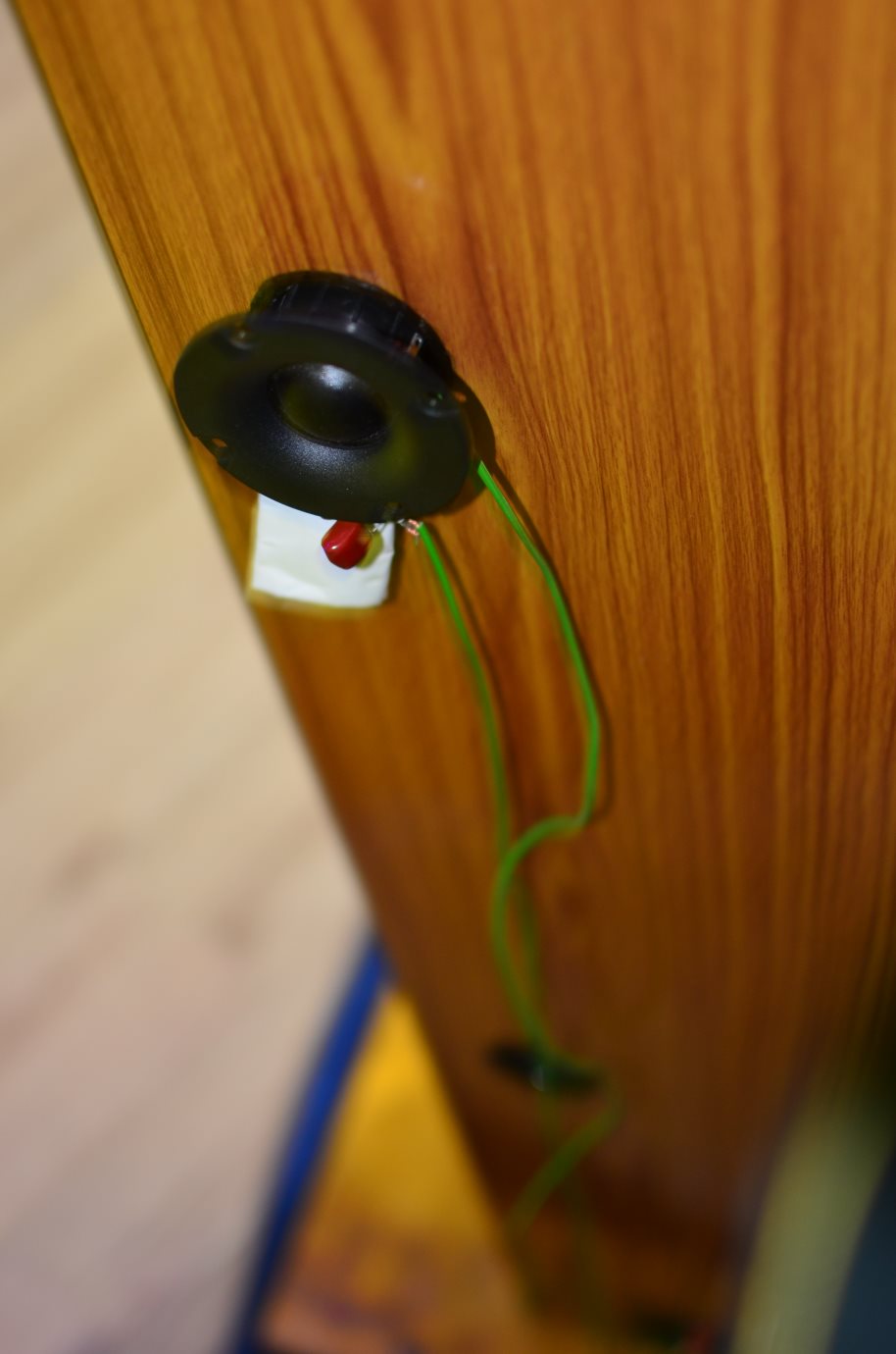

I have very conveniently stuck the tweeter in one of the rear ports
Thats around 1 metre above the floor. My speakers are 20 degrees toed in. So, the tweeter is hitting the front wall at 20 degrees too.
I am using a Peerless India 26mm silk dome tweeter. Right now, I am using 1.66 uF cap ( 1 + 0.33 + 0.33) 1st order HPF. Thats around 16KHz for the 6Ohms tweeter. Its a decent quality $20 tweeter.
I was lucky with the tweeter's sensitivity. I am wiring it parallel to the main array at the binding post. I am not having to make any level adjustments between the tweeters and the arrays. The tweeters are 90dB sensitive at 10KHz with a broad 4 dB peak from 12 to 16 KHz.
About stage and/or imaging, I am not so sure how to describe. I guess a greater side and front wall distance would have had more effect on the staging and spaciousness. What I have perceived so far is that the rear tweeters are helping the arrays disappear even more The sparkles are flying or floating all over! The air is in the air! I can definitely feel an increased 3D effect in the audio space. With the arrays, stage and imaging are more engaging. It pulls you in more than without the tweeters. Hope I am making some sense.
