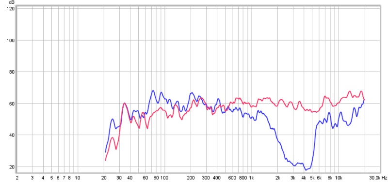

Well, definitively something wrong going on.
I took a measurement with REW before (bypassing everything, and no sub inputs) shown in red.
Then, plugged in the subs and made a new sweep with DRC Designer. Spit out all the filters and input them into JRiver Convolution plugin, and listened to all of them. They all show the same behavior, in different intensity.
I used REW to make another sweep to see what was going on. this time using JRiver and the convolution filters applied to the signal.
Pretty funny.... NOT!
This is the sweep I get, in blue.
Just imagine my face when I listened to THAT!
Well at least now you know why you had such bad results... Now we need to find out why.
