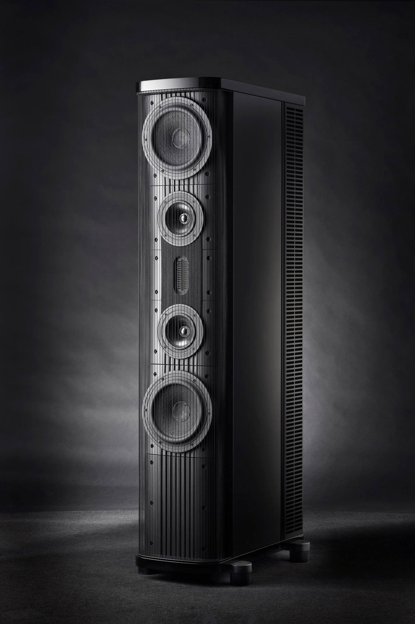

I think the vertical bars can actually look quite good. But... if they would serve a true purpose, i"d have to
get them pretty tight, which makes them almost like strings on a guitar...
I think the Gryphon bars are some kind of rubber, but I couldn't find any info on them.
The rubber snares I could find were about 1.5 mm or larger.
Done in metal I could use (cycle) cables with 1 mm or less thickness. Or I could use some kind of rope.
But it would be about 2.15 meter in length, so it's got to be quite tight to not bow/bend when touched
about 1/3 or half way...

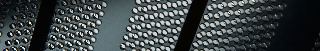

I also looked at the perforated sheets... but it would be quite a task to make it pretty and blend in.

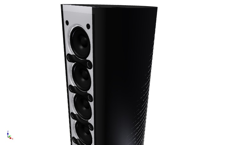

One thought that went trough my head more than once is the lips I proposed a while ago...
What if I did go with a sort of vanes between each speaker and add the bar grille.
Not quite like I pictured above, but it would keep the bars in place while also serve a function as a wave-guide of sorts...
It won't be cheap to create, when printed commercially. But if it serves a double purpose I just might be tempted...
I could stick on some sort of vilt on both sides to make it a somewhat softer boundary for high frequency waves...

With the right sized holes this can be acoustically transparent.
The material can be colored and transparent to taste.
Could this be a solution?

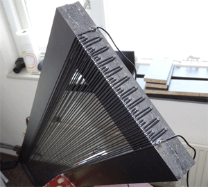

Some use this also for DIY ESL speakers:
The guy in the above example uses 2mm (total) wire and also 2mm spacing.What thickness would be available and strong enough? (in total with insulation)
Tensioning the wires would be a challenge I assume..
That's why I came up with steel cable, available in 1 mm thickness...
I can put some force on that and it's slim... with heat-shrink it could look the part.
If I space it 5 mm it would be more than enough... I might need metal ends to
be able to withstand the tension...
