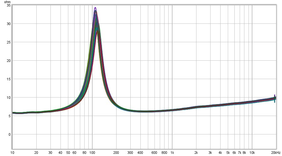

I think I will start with a control impedance test of all drivers.

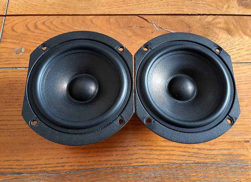

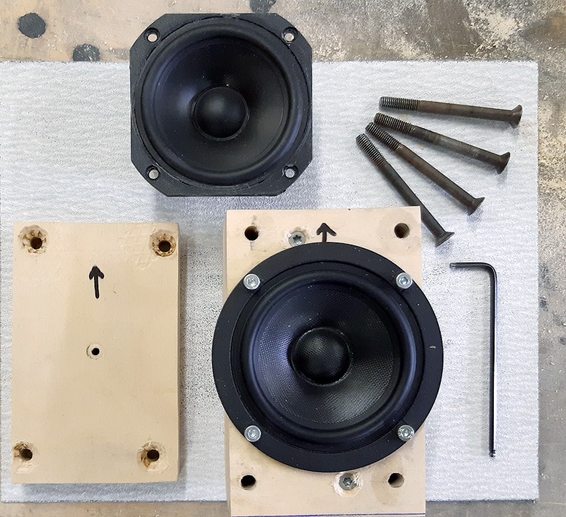

That’s too bad the bezels are not the same for a drop in fit. OTOH, the bezel is round so perhaps quick work with a router and round template or hole cutter.

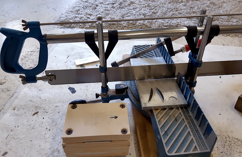

I've got that part covered 😉. With simple hand tools though. Don't want to heat up any glue etc.
There was a blowout sale on eBay? a year ago on 10F’s with flat sided bezels. They were painted aqua green. I think they were extras from some Thiel speaker design. Would have been perfect and saved you from hacksawing these drivers.
I would put very fine tooth blade on a table saw and slide the work really slowly past the blade; except I know I'd eventually get impatient and push it too fast. But you are the guy who routed all the pieces for your translam cabinets by hand, so I doubt you would have that problem.
That was a compliment… sorry if that wasn’t clear

Quite pleased with the first impedance check of all drivers. Impressed really.
Only 3 of them that don't quite fit this bundle, 2 of those are the ones I got in advance. (the 3 not shown here)
Seeing how I have 56 drivers in total I should be able to make 2 very similar sets of 25 drivers each.
Sorting the drivers so that the 5 drivers in the 5 groups averaged out closer to each other did result in a smoother overall impedance for me.Seeing how I have 56 drivers in total I should be able to make 2 very similar sets of 25 drivers each.
@fluid, I remembered that. I mainly ran impedance checks to see if all drivers were healthy. That was my first priority. But I saved them to be able to group them like you did.
