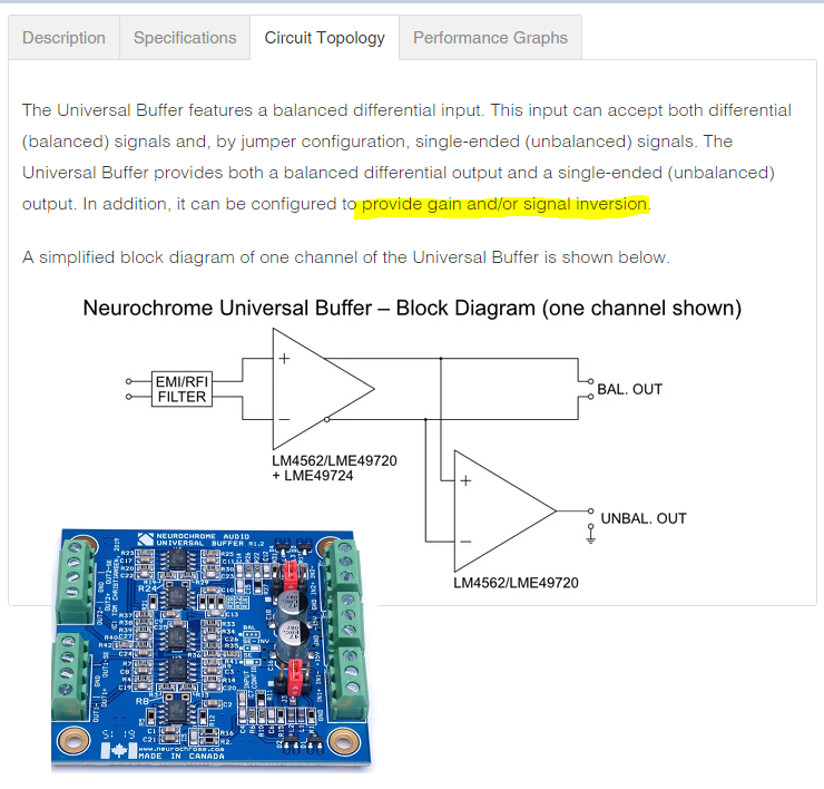

Do you have a decent regulated 12 to 15V supply available inside your amp? If not you will need another board for that. have you considered something like thisPlacing a Universal Buffer on the amp side would give me a new problem. I don't want any extra loose boxes over there. Mounting it inside the Goldmund would mean it has to be somewhere above the two big toroids. Would that be a good idea?
SparkFun THAT 1646 OutSmarts Breakout - BOB-14003 - SparkFun Electronics Wouldn't take up much space and the IC is very well designed. Not quite as good as Tom's but no slouch either.
You will get a doubling of voltage potential with the conversion, I think that is +6dB in voltage terms.I know my DAC is 2.2 V on SE, 4.4 V on the balanced connections.

You should be covered in that buffer is flexiable unit, its input can be single-ended or differential and it always have dual output in one single-ended and one differential, then look yellow marker below whatever gain should be covered, we just need to find out how voltage levels works after conversion when i have ran that TI Tina spice simulation 🙂

Ah this is similar, but way less pricey. Tom used to have a THAT driver board that did the same, I'd need the other variant though, this one:
SparkFun THAT 1206 InGenius Breakout - BOB-14002 - SparkFun Electronics
As this is a Balanced to SE convertor for the amp input. The reason I like Tom's boards because it leaves all options open. Even moving toward all an balanced setup etc. It has both, but it isn't cheap. It doesn't have to be if it's worth it due to being of sufficient quality though.
I don't have a 15 volt source. So I would need to use one of the options mentioned in the Universal Buffer thread.

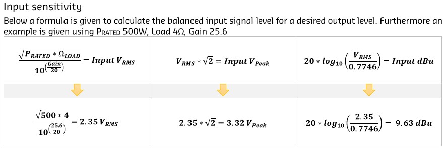

According to the datasheet the input sensitivity for a 4 Ohm load is 2.35V for 500W output. So 2V SE would get you very close.
In that case balanced to single ended is really just an opamp combiner as shown above in Tom's drawing, plenty of good quality options there. Tom's board is a step up for the single ended to balanced operation not really so much the other way round.Ah this is similar, but way less pricey. Tom used to have a THAT driver board that did the same, I'd need the other variant though, this one:

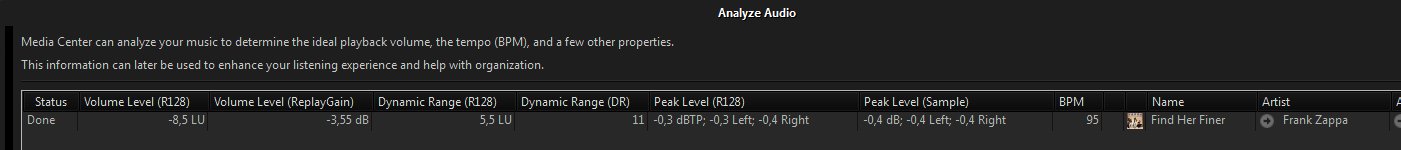

So let's play a song. I'll pick Frank Zappa - Find Her Finer as that is the last song I've played and see what happens...
When it's analyzed with JRivers algorithm it comes up with the following numbers:
We have a track that has a dynamic range of 5.5 LU (R128) or to match the Dynamic Range database we see that DR number of 11 dB.
The current JRiver attenuates the songs based on the R128 Volume Level, meaning in playback this song is attenuated 8.5 dB. Let's check that.

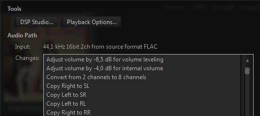

Hit play gives us this:
See? The attenuation is indeed -8.5 dB for volume leveling and a further -4 dB that I have chosen to end up at my desired 85 to 87 dB average listening level.

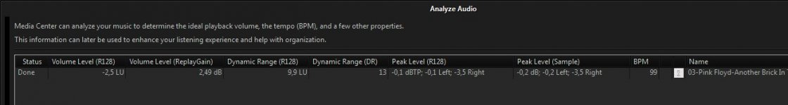

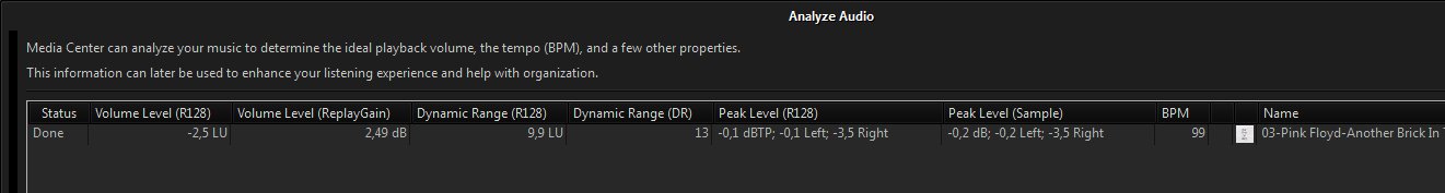

Let's move on to another song, this time Pink Floyd, Another brick in the Wall (part 1):
Quite a bit of change in this one, more dynamic range, actually less attenuation as determined by the R128 algorithm, -2.5 LU. Dynamic range according to both algorithm's is higher than the last one. 9.9 LU and 13 (DR).

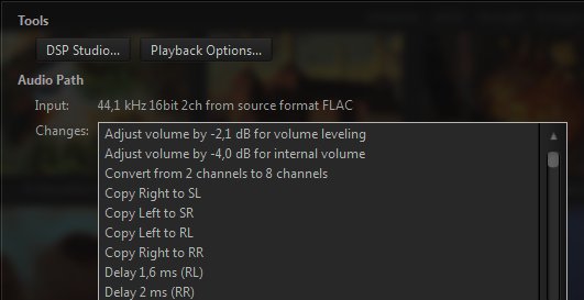

Let's hit play again:
The attenuation is even less than the number found by R128, -2.1 dB. Together with -4 dB internal level as set by the user (me) it has a total attenuation of -6.1 dB. Now depending on where it's dynamic content is, this song potentially hits well above the 2 volt RMS figure of my soundcard!
Remember: a lot of the frequency curve has a further attenuation up to 10 dB. But at bass frequencies, I'm potentially well above that 2 volts number if there are notes there that hit hard!
Depending on which number we trust, we could have peaks above this average of either 5.5 dB (R128) or 11 dB (DR as noted by Replaygain)
If I were to play a sine wave with the same average numbers, I could play it all day long without ever surpassing that 2 volt RMS number anywhere in my chain. My maximum boost at low frequencies used to be (prior to subs) set to 14 dB. The maximum cut at the most sensitive part of the array was set to about -10 dB. So my total swing here: 24 dB.
If we look at the attenuation, -8.5 dB + 4 dB, and consider that dynamic range of 11 dB valid, it fits under that total of -12.5 dB of attenuation. Which is why I said it would form no problem at all with a sine wave.

Balanced only works if the amp is designed that way, otherwise a second conversion would still be needed on the other side, bringing the level back to single ended so you're right back where you started, at least for amps with single ended input. The advantage is the higher signal during long transports and it's common mode rejection along that long line.
The subs is a different story. Balanced in should indeed gain headroom, right? At least, that's what I've been wondering.
Is it true that if I were to put in 2 volts RMS SE to the Hypex it would be half of what a 2 volts RMS balanced input signal would supply? Thus the 6 dB gain difference?
That's still a bit fuzzy for me.
So first and foremost the plan is to use line drivers with gain(*), probably using it single ended at the start, feeding the RCA's of the Goldmund and Fetzilla.
Optional in this configuration is using the balanced out (4.4 volt) from the M1 to the input of the UB line driver feeding the Goldmund. That's why BYRTT wants
me to put that Universal Buffer inside the Goldmund amplifier. 🙂 I don't disagree with that, but placement inside above the toroids does not seem wise/make sense.
The linedriver powering the subs will convert SE to Differential and feed the sub that signal.

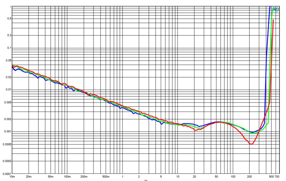

Correct... I don't have the exact schematics, I just noticed the limitations there due to wondering what I was hearing and why.
A bit of useful information was found in this test: ASUS Xonar Essence ST DeLuxe review - Electronics Overview
The M1 DAC has 2.2 Volts RMS SE or 4.4 Volts Balanced out. But it needs to feed a single ended input on the Goldmund amplifier.
Basically it has similar limits as the Xonar card for my use. Loopback tests looked very similar.
