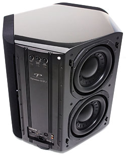

The only commercial sub I know about within the same ballpark is Paradigm Sub 2, I guess ..
Out of curiosity I looked up the Paradigm Sub 2 and even read a review...
attachment.php
Paradigm Reference Signature SUB 2 Subwoofer | Sound & Vision
Sounds like a plan to build something like that. Reading the review put a smile on my face. In there is the mention of the movie: A Christmas Carol, a movie I have viewed with my family quite a while ago. There's quite some sub-bass hidden in there and it even overloaded the arrays at that time.
It gave us quite a scare! Definitely a movie I will revisit when the subs are in place, hopefully this christmas. 😀
That Paradigm sub is a monster! Are you planning a similar setup with drivers on 3 of the 6 sides? Another example that an array of (smaller) drivers can do wonderful things. I couldn't believe how tiny that thing was!
Yeah ... the sub 2 is as an awesome beast, but should be possible to make a sub that provides some of the same things... I believe there are not so many drivers that will make it as there is so many drivers in quite limited volume and most drivers will get underdamped and be very boomy.

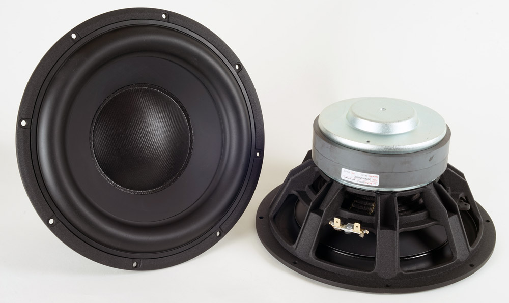

I am looking for 9" to 10" drivers with high x-max, very low Qtc, limited Vas and not too high membrane weight....

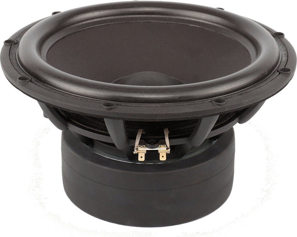

There are some Morel and Scanspeak drivers that should be able to do it in a cabinet less than 140 liters and still be able to keep a Qtc under 0.6, so I would get a well damped bass and quite shallow rollof....
The challenge is that the drivers with this big magnets, bullet proof construction and high xmax are very expensive, and when you need 12 of them budget will easily pass € 8000, so as an experiment it can be pretty expensive but if it works well it's going to be awesome ....
of course, the complete insane build would be the one with 6 ScanSpeak/32W-878T11 but that would be pretty steep on budget and needs a box more than 160 liters I believe ....
On the other side, I reckon a sub with 6 of these on each side would be able to challenge any commerical sub on the market...

I'd look at the Scan Speak 26W for this job. If it is good enough for a monster project like the Beolab 90, an insane speaker project, and you use 6 of them with processing you should get plenty! Even better if you use 2 of those subs in total 😀.
I was re-assured by their use of the 26W in such a high prestige speaker. I've looked at pictures until I found one that confirmed it was indeed the 26W that was used.
I wasn't able to tell (for sure) from this picture:
attachment.php
But when I found some evidence they used a Discovery 26W for that top dollar product, I figured the 30W was going to be good enough for me.
attachment.php
Source is this video at 1:08 on timeline: YouTube
That closed magnet back can only mean it is indeed the 26W.
attachment.php
Even though I now had evidence I still compared all reviews and measurements I could find on both the 30W and 32W. But in the end I am convinced its going to be the added volume displacement together with the room placement and processing that will lead to success. That's why I want the array and sub to "play well together", instead of just handing over that job. Multi-sub works for a reason, figure out why and you're well on your way.
(Sure I still lust for that 32W 😀. I even sized the cabinets for a possible fit down the road. 😱)
