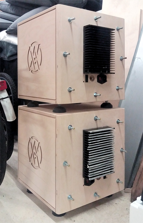

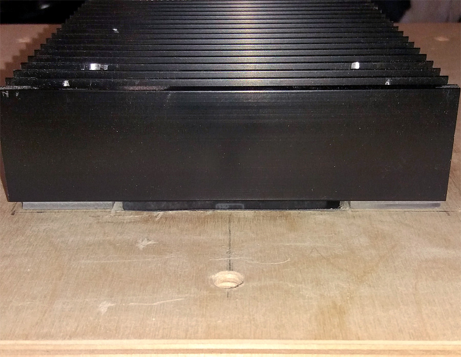

I'm quite pleased with the outcome of the fresh air slits:
attachment.php
(you can see the logo on the bottom of the inner alu case)
A 80 x 4 mm opening on both top and bottom... thanks to Fluid for his bright suggestion that triggered this idea! 😉
My previous ideas were complicated and not as functional as this turned out to be. Simple and effective.

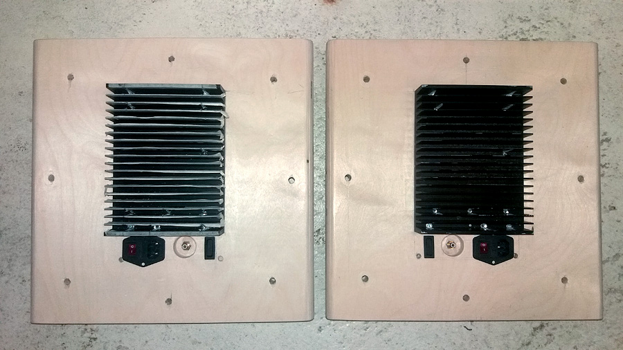

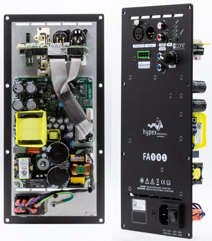

You're absolutely right about that. But the heatsink I have is pretty large if you compare it to what the Fusionamp FA501 from Hypex has, which features the same module:
attachment.php
I have looked at lots of heatsinks and enclosures prior to making my choice.
It's not completely what I wanted but it's close enough. I have thought about mounting it horizontally but changed my mind (purely based on looks, even though it would barely ever be visible, go figure 🙂).
Losing a bit of the efficiency should be fine though with this (way oversized) heatsink. As koldby mentioned I probably could have been OK/fine with just the aluminium enclosure I had purchased. I do believe Fluid made a valid point about the air slits.
When I started with mounting ideas I have thought about turning it 90 degree and mount the Hypex module vertically (with it's long side), so I could still keep the connections below the heatsink and cover it with the inner case. But that would be quite tight spacing here and there as the heatsink is 200 x 150 mm and the Hypex module is 146 x 105 (with a recommended minimum spacing of 6 mm all around).

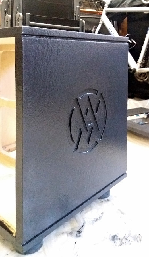

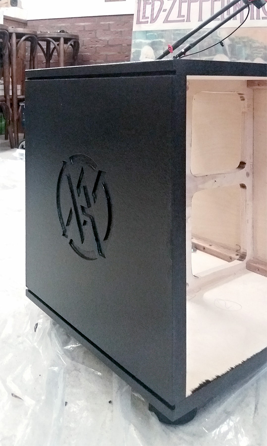

As I wanted to mimic the structure of the line arrays for the subwoofer enclosures they first get a couple of layers of epoxy.
First batch is just a clean (but colored black) coat applied with a brush. Did not take any pictures of that, it looks ugly.
The second coat is applied with a roller to get that textured look. I added micro balloons (about 15%) for just that bit of added drama.
Yes it looks kinda like Duratex coating but I couldn't get that locally.
attachment.php
It was kind of scary how I could get the logo looking but I think this works fine.
On my way to the garage to do the next one! 🙂

While the above picture makes the bumps look rather dramatic,
here's a shot from another angle in different light (of the second enclosure):
attachment.php
That's how you'd normally view it. It's more subtle than that first picture
suggests. Anyway, the layer (or two) of Double Coat satin black boat paint
will dim it's effect down even further. I think it's going to match well to the
arrays, which was the point.
Scary as #$!! to do it, but I think it turned out well.
