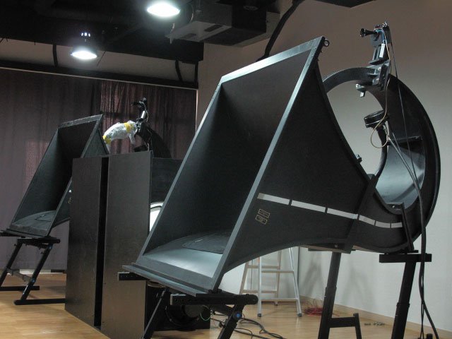

It makes me wonder about those big WE horns...
attachment.php
Will that one have a reflected wave travelling back down the horn to resurface (in this case much) later (though substantially down in level) to create part of it's undefined magic?
It's already creating a direct wave front that's way up in level compared to the indirect room effects due to it's directional design, playing over a really wide frequency range, no doubt it's quite true in timing (I'd bet pretty flat phase) with no crossovers present in a very important part of the FR spectrum to our ears (say ~200 to 6K).
If we remember the measurements shown from several different type of horns, done by JMLC (may he rest in peace), PDF file here... we see most of these horns do have a substantial reflection back down the horn that gets back to us over a wide bandwidth. (most of them arrive around the ~3ms mark, however with the WE, due to it's sheer size, it would have/show that reflection much later. I'll leave the separate diffraction effects out of this example for now.
Something tells me that these little things just have to determine or be part of the entire package of how something like that sounds to us.

There's two schools of thought here. I have both systems where one is a large horn (22" x 22") that does wide bandwidth from 180Hz-18kHz and provides pattern control down to 400Hz. If you move to the side of the speaker it's down at least 40dB from 400Hz upwards. The other system is very wide coverage in a room treated for diffusion only. There are very little absorption for room treatment.
The large horn presents a wall of sound that is ultra transparent. Almost like a window 10' x 10' of sound, but there is little soundstage depth.
The other system is a narrow three-way with a smaller JMLC horn for 2kHz and up, and provides a very broad coverage pattern. This speaker activates the room acoustics and the soundstage extends beyond the physical dimensions of the room (12' x 12') and the has more envelopment around you. So my subjective preference is for the later. But there are a few caveats I've found.
