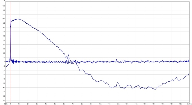

Yes, only the right channel. What you see there is the correction FIR data.

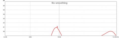

I've compared the measured RAW data with previous measurements. I think there's either something rattling along with the speakers (accessories that my girl likes to put in our house) or I need to re-tighten the front baffle 😉. I'll soon find out.
There's a dip that wasn't there in earlier measurements.
On the accessories: there's a new metal wire frame basket right beside the array, usually filled with blankets. But it's close enough to be a suspect.
This dip starts around 6 cycles, which is odd. If it were the baffle, I imagine it would start to show up in the first few cycles as well.

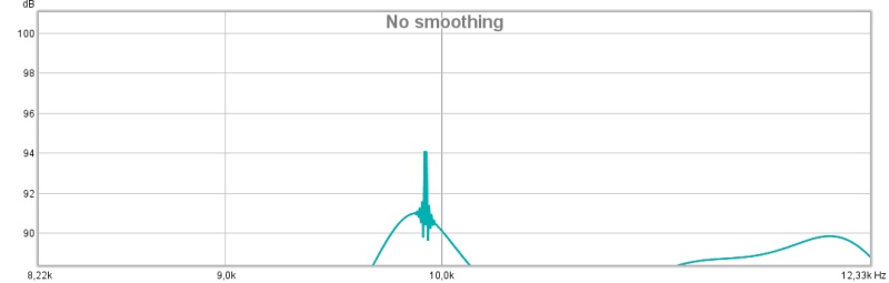

FIR correction of one of the other measurements gives me this:
attachment.php
Much better, bit there's still a sign of a resonance on top. If I use this one as a correction it will still ring, only much less than the previous one.

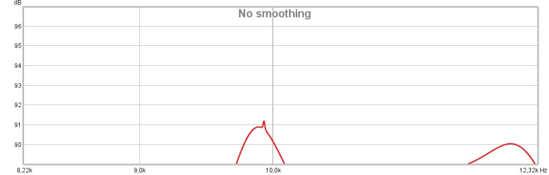

Compared to the previous correction:
690496d1530905977-towers-25-driver-range-line-array-quirck-jpg
No EQ is going to fix that... If I could apply and save a 1/48 octave smoothed FIR file it would be gone.
Remember that this is the correction file we are looking at here.
This anomaly was the result of the measured file running trough the DRC-FIR software. But the reason is locked away somewhere in the measured frequency response.
If it is the speaker causing this, I can run an impedance check. If it is environment, I can remove the stuff close to the speaker. As it all happens within 1 ms, it has got to be very close in/to the path to the microphone.

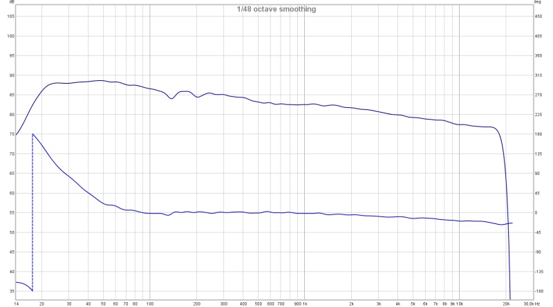

I only had some computer time available, so I re-did some steps with the FIR correction that had the problem at ~10k reduced.
Here's some predictions for the Stereo result:
attachment.php
The predicted IR at the sweet spot:
attachment.php

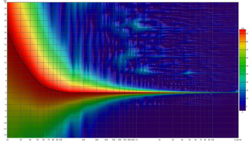

And the FR as seen in a wavelet:
attachment.php
The results follow minimum phase for the most part of the FR spectrum, except at high frequency. To have it follow minimum phase on the upper part of the spectrum I'd have to include the physical roll off in my DRC-FIR template (right now DRC-FIR assumes flat correction out to 20 kHz, as it is set to correct from 20 Hz to 20 kHz). I might try that change later on. (it still has output up high, though much more uneven utill about 21 kHz)

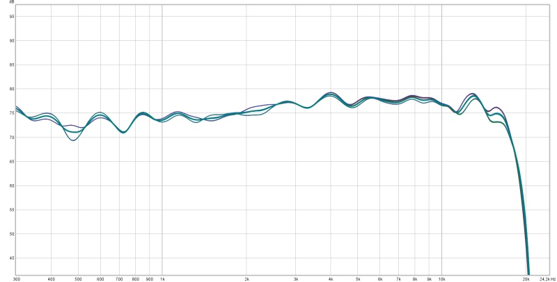

Lets see a graph of that:
attachment.php
What you see here are the RAW measurements of the left channel. There are 9 measurements in total and the fat green line is the REW vector average.
So 3 measurements right at the microphone sweet spot, 3 measurements 8.5 cm more to the left and 3 more taken 16 cm to the left. The bottom end is even closer together, the biggest deviation overall is at 480 Hz and is 3.1 dB (over a very small area).
So no shocking differences if you move the mic (or your ear) a little to the left or right. This is what you get if the first reflections are reduced far enough. And, obviously, if the driver itself is well behaved. It proves the point that it isn't a big problem to correct for a single microphone position, as long as the room does not mess things up.

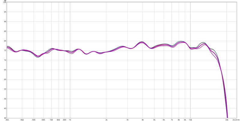

I might as well show the right side too:
attachment.php
(even less deviation there)
