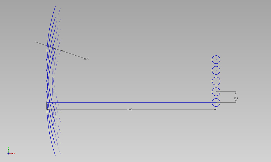

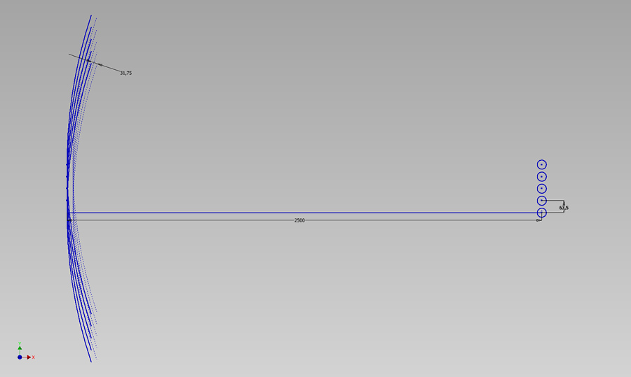

Lets put it into a graph:
Here I've drawn waves at a listening distance of 2.5 m, each driver gets a wave and the dotted lines behind the "blue wave" are 1.25" behind, meaning out of phase at 5400 Hz.
Where the continuous blue line touches the dotted line behind it is were a driver is out of phase with another driver. On our design axis, in line with the bottom diver, we see that none of the other drivers is completely out of phase with another driver. This is the worst case scenario with this array at 5400 Hz, be it, at a distance of 2.5 meter.
(they are actually within a quarter wave distance, and still summing positively, directly in line with the bottom driver)
Let's examine closer to the array:
See how at 1 meter distance the situation has changed? The upper most driver's wave front is out of phase with the bottom driver (check it's dotted line) at our design axis.
The rest of them still sum.
This shows that driver spacing does have an influence on the resulting combing. But not like you claimed it would. If I had more drivers in between the top and bottom one, thus spaced closer together, the top driver would still be out of phase with the bottom one at 1M distance. However the transition would be more smoothed out due to having multiple drivers sum and subtract. Getting closer in behaviour to a continuous array.
But not in any way like you said it would, concluded from that center to center spacing.
At 2.5 meter none of the drivers would be out of phase with another on our design axis at 5400 Hz. This does not depend on the number of drivers in our short array here. It is determined by the distance from the array and the length of the array. More drivers packed closer together would fill in the spots in between, kind of like anti-aliasing. Getting you closer to a seamless array. Now make it floor to ceiling and assume the floor and ceiling are reflective.

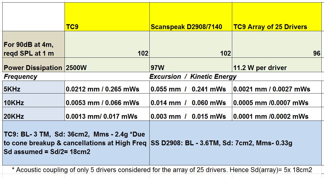

Kinetic energy of cones compared: TC9 vs SS tweeeter vs array
Here TC9 is doing a dedicated tweeter's job. So, I thought it might be fun to compare them. General perception is that the TC9's cone is too heavy for the motor to control with authority hence loss in resolution as we go higher in SPL.
The TC9 cone works with controlled breakup at high frequencies while a dedicated tweeter mostly don't. As the frequency increases the effective cone area decreases due to breakup/ cancellations. Also the cone area attached to the voice coil decouples itself progressively as frequency increases so effectively Mms decreases too. This comparison is about the motor only with very simple assumptions regarding cone breakup.
Let us compare kinetic energy of the cones between a TC9, scanspeak D2908/7140 and a 25 TC9 array for frequencies 5 khz, 10khz and 20khz for target SPL of 90dB at 4m.
Kinetic energy is a function of cone mass and excursion; so we don't have to deal with 2 variables anymore. Kinetic energy is generated by motor force factor which is a function of BL and VC current. BLi not only has to generate the kinetic energy required but also control/ damp the energy as required.
Effective Sd of TC9 is assumed to be Sd/2 ie 18sqcm. Effective Mms is assumed to be actual Mms ignoring cone mass decoupling mentioned before.
For an array of 25 Tc9 only 5 drivers are assumed to make acoustic coupling (20log5 ~ 14dB)
Calculations are done in Linkwitz excel spreadsheet named SPL-dependent.
Observations:
1. a single TC9 is an epic fail compared to the tweeter. KE are comparable despite higher mass for the TC9 as the excursion required is lower. But lower BL/Mms ratio calls for huge input power of 2500W! Even much before the target SPL is achieved there will be compression, Li induced distortion and amplifier distortion. So, low volume output only for the TC9.
2. Tweeter vs Array. The array has 6 dB benefit at 4m as line source SPL reduces @ 3dB per doubling distance instead of 6dB for a point source tweeter (assuming farfield transition for the tweeter at 1m to keep things simple). We have assumed acoustic coupling of 5 TC9. So each TC9 has to generate 82 dB at 1m vs 102dB for the tweeter.
The kinetic energy for the cones in the array are around 80 times lower than that of the tweeter. Thermally and VC current wise, the array drivers are just loafing around (11W vs 97W for the tweeter). Although the total input power for the whole array is 25x11.2 ~ 280W.
Hope this post adds any relevant meaning.
